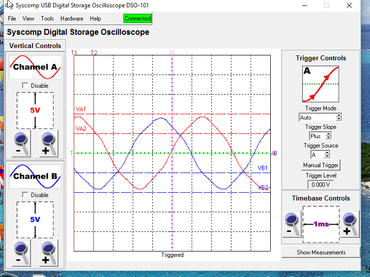

martino I did a few tests on the one I have dismantled on the bench, it is a GM-Delco older style alternator, it has 12 rotor poles and a Delta connected armature (stator) consisting of 3 sets of 12 coils between each phase with a total of 36 poles faces.
Each field pole sits under 3 armature faces.
The field is ~2 Ω and the new brushes are ~1Ω ea.
With 2.5 amps to the field I was surprised on the apparent pole strength.
Once I get it reassembled I am going to try and get it to self excite using field residual, so that no external power is needed.
Max.

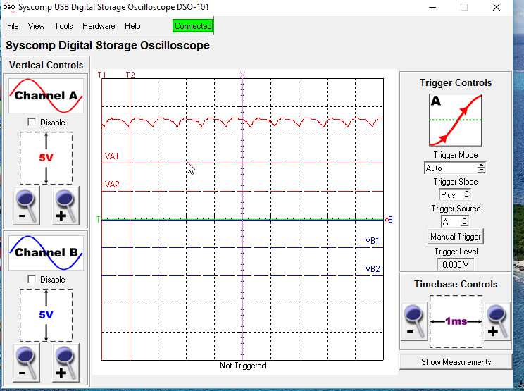

Max, after you get it assembled, if you could look at the stator voltage waveform before it's rectified, that would be of interest. :)
Thank You Max, also the waveform after the full rectifier should be interesting, to evaluate the amplitude of the ripple and its frequency.
Yes, I intend to, the stator has to be unsoldered from the bridge anyway, in order to dismantle.
Can do, although the frequency and % of ripple on a 3ph full wave bridge is fairly predictable.
Max.
Here is the results of the alternator output when 2 amps is fed to the field, both monitor of two phases and the resultant rectified DC at approx 1880rpm.
