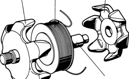

I need to know the number of poles inside an alternator (Lundell type of course).
Is there an instrument or procedure that can help me to get this number ?
Thank You
The only way to know for sure would be to take it apart. Different manufacturers use different designs. Are you asking about the rotor or the stator? One thing that is common to most designs is the stator is wound three phase.
10, 12, 14, and 16 are the most common.
If you rotate it at a known speed and measure the frequency of the output ripple voltage, you can calculate the number of poles.
The following image is a 6 poles or 12 poles rotor ?

frequency (Hz) = cp * RPM/60
cp=couples of poles
it is correct ?
That would be the sine-wave frequency for a single-phase generator.
The ripple frequency of a full-wave rectified signal is twice that and you increase that further by a factor of 3 for a 3-phase full-wave rectifier.
This gives the ripple frequency for a 3-phase vehicle alternator full-wave rectified output of
cp*RPM/10.
Hi Martino,
Do you know, I have never bothered to figure out how you get N poles from a single winding on an automobile alternator rotor. Also, the winding direction seemed to be wrong. Your picture makes the technique crystal clear.:cool:
The winding direction is such as to make one side of the rotor (one claw) one magnetic pole and the opposite side the opposite pole.
How is that backwards?
I didn't mean that the single rotor winding was backwards. The rotor winding is in the wrong direction (orientation) and, without the magnet ears, the rotor coil magnetic field would not cut the stator coils at 90 Deg. If I haven't explained that correctly, I hope I have conveyed the principle.:eek:
spec
I believe you misunderstand how the rotor works.
The magnetic ears are indeed integral to its operation.
One claw is magnetized with one magnetic polarity and the other claw with the opposite polarity by the coil between them.
It is the magnetic ears of the two claws that generate the field between the claws that cut the stator coils.
(The field direction is not exactly 90 degrees to the stator but I don't think that has a significant effect on the operation).
