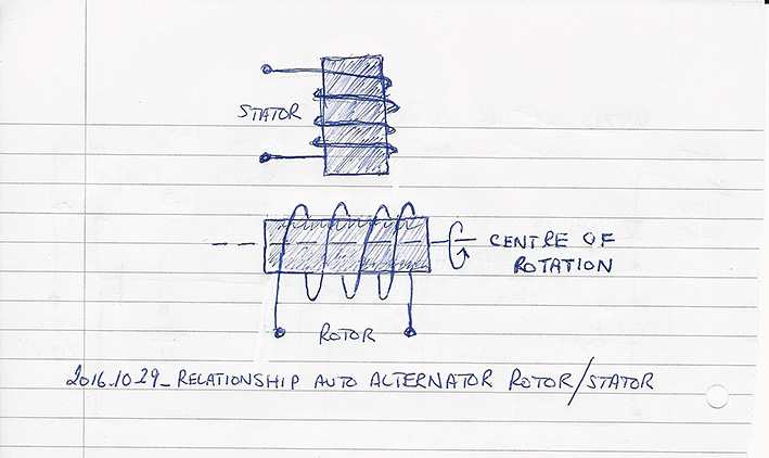

The sketch below, shows, the relationship between an automobile alternator rotor and stator winding; the claws are not shown. The dilemma is that this physical relationship gives the minimum coupling between the two coils. In EMC work it is the very orientation that you would choose if you were minimizing the interaction between the two coils.
If the rotor winding was then rotated around the axis shown on the sketch, there would still be no induced voltage in the stator coil.
In fact, it would be easy to do a simple experiment and rotate a permanent rod magnet (polarized axially, rather than radially) in the relative position to a coil shown in the sketch.
Theory says that no voltage would be induced in the coil.
That, I hope, illustrates my point.:)

In the drawing your correct, nothing produced in the stator. But that does not show the 'claw' poles in an automotive alternator, it's the 'claws' that makes each alternate claw a north or south magnetic pole, and allows them to make electricity in the stator.
Now if instead of rotating like in your drawing, the center electromagnet reciprocated, moving in and out of the stator, it would generate a charge.

In a two dimensional world that would be correct but alternators run their magnetic fields in a three dimensional flow circuit pattern.
The rotor end plates and claws take the magnetic field coming out of the rotor coil and bends it around 90 degrees to put it on the rotors circumference in an alternating N/S configuration.
From there those alternating N/S pole lines of force loop up into the stator and back down thus completing the magnetic field loop through the stator windings in the correct 90 degree direction flow to the actual coils physical layout.

You have cleared the matter up for me and, to be fair, have confirmed what I said in post #13. That is that the claws do in fact rotate the magnetic field from the single rotor coil.
Some informative stuff about automobile efficiency too. It is also my contention that the design of automobile rotors has knock on effects that reduce the efficiency, mainly by copper loss. But that is another story. :)
