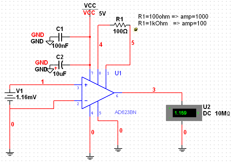

Hi there,
new to this community, I already need to ask for some help:
I'm working with the AD623B but i get somewhat strange results. The problem seems to be that I operate the omamp in single supply mode. Everything works fine but the output wont get any higher than 1.16V, independent from the opamp's gain. Operating the opamp with dual supplies, the output is as expected.
I attached a multisim screenhot. (ps: multisim produces a simulation error for an output higher than 1.16V. Using a breadbord, the output saturates at the same value...)
I really appreciate any help.
thanks,
krmt

hi,:)
Try removing the 0V connection to pin2, lets know what you get.
Keep the 1.16 mV signal source connected.
Look at this page from the AD623 data.
You are working below the allowed limits of the CMV.
Connect pin5 to a +2V supply, use a divider resistor chain from +5V
Reconnect the 0V to pin #2.
OK.?:)

Hi ericgibbs,
thanks for your really prompt answers.
i disconnected the ground from pin2 - the simulation isn't running anymore...
am i working below the limit? pin 5, however, just set a offset voltage as reference to the output. I thought, since i grounded my input signal it should be fine to have a reference of 0V, too.
what do you mean by that - what for do i need the voltage divider?
maybe you can explain your idea a bit more in depth?

What do you mean, "independent from the opamp's gain"? Have you tried it with a gain over 1000? 1.16mV*1000=1.16V. That's what you are getting.
OK.?:)
I read it to say the CM range extends below GND. The datasheet also says that.
EDIT: I think I was incorrect. Fig. 22 in the datasheet appears to confirm what Eric said. Adding a common mode bias should help.
It is an odd opamp. Its input common-mode range does extend below ground. But when it does then the output high voltage is reduced.
I didn't see Fig. 22. I think Eric is correct.

Connect a 3K3 and 2K2 resistor is series and connect one end to +5V and the other end to 0V. The centre of the two resistors goes to pin 5, the REF pin.
This will raise the Vout, with no input signal to +2V, now retest using the 1.16mVdc source.
Lets us know the results/reading.:)

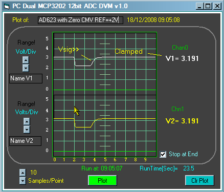

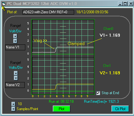

Results
Configuration:
Gain SET to 500
pin2 to 0V,,,, pin3 connected to 0V via 4K7
With a :
Connected a variable voltage to input pin3 [via a 4k7]
Vsig of +1.2mV on pin3, the output pin6 reads +0.700V, Gain pot has correct effect on Vout level.
Vsig of +3.6mV on pin3, the output pin6 reads +1.160V at which point Vout starts to clamp
Vsig of +5.5mV the Vout reads +1.176V
and remains at this voltage even when Vsig is increased to any value over 5mV.
Disconnected pin5 REF from ground and connected to +2V... the Vout now clamps to+3.176V
Conclusion:
According to the AD623 datasheet with a zero CMV the AD623 can amplify very low level signals.
These simple tests suggest that the signal level must be between 0.00mV and + 3.5mV.
When a +2V offset is applied to pin5 REF, it moves the standing Vout to +2V, the small Vsig still applies
but now the Vsig can swing 0.0 thru +/-3.5mV.
The AD623 OPA is not a suitable choice for this low mV application..

With a 2Vref and a floating mV input it clamps at about 2.5V
I'll re-run the test in the morning, but I think you owe me a beer.;)
