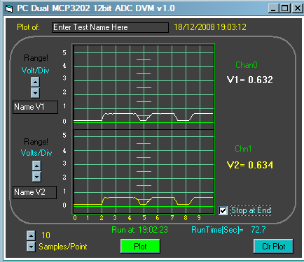

Tried it again with 100mVref, it now clamps at about 0.6V.
If I have caused offence, I'm sorry, that was not my intention.:eek:

Looked at the zip, waves.png... the graph you got with the Sim does not reflect the Vout results from the actual circuit when constructed.
It still clamps at lower Vout, even with an REF of 100mV.

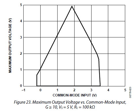

The datasheet shows a hex and a triangle that shows how low input voltages result in low clamped output voltages.
I agree and the simple tests I have done confirm this.

Did you try it with the inputs biased up to 1.8V, as in my sim? I'm having trouble believing their spice model would be that wrong. Am I interpreting the Fig. 23 (below) wrong?

No, I didnt bias the inputs by 1.8V, to be honest, I missed seeing that in the data you posted.!
But looking at the datasheet it would give the results you got.
