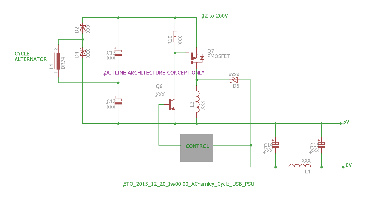

Hi Andrew,
Intresting project. Another approach is to simplify and also use a bit more of the energy from the cycle alternator. Here is an outline schematic to give an indication of what I am thinking about. The rectifier diode loss is only around 500mv.
Brilliant! - though I don't really understand what's going on. :) Would it work down to 6v? Also, I see power having to go through two diodes; D2, D6, which would have those losses?
I'd very much like not to dump the extra voltage as heat, though cyclists will rarely go so fast that this will occur.
I finally found a dual MOSFET package as well, the AOP605. **broken link removed**
The arcitecture suggested achieves the opposite to what you think. With six volts output from the alternator the voltage across the two capacitors would be around double the alternator output voltage ie 12V. At 100V output the voltage across the capacitors would be 200V. Current flows through one diode for one half of the alternator output and through the other diode for the other half cycle. Thus there is only one diode drop in the circuit at any one time. The MOSFET is a switcher which stores energy at one voltage and then dumps it in the lower capacitor at the 5V output for the USB power. The energy is stored in the inductor. The control box takes care of all that.
The priciple of the circuit is known as constant energy, so there is no energy loss, unlike a linear approach. In this application all the components would run as cool as a cucumber. So there is no dumping heat however fast you go; that is the principle of a constant energy approach.
I see now where the 12v comes from, clever!, I'll have to follow the rest through tomorrow morning (as I'm off to bed!). Many thanks for taking the time to draw it out.
So the maximum drop here would be that of a Schkotty, so let's say 0.4v, and it would work up to the max voltage, whereas my idea would drop less, perhaps 0.1v but only work efficiently up to 18v.
I guess the control circuit would be quite complicated, not something available off the shelf?

That is corect about the s diode.
The control function is standard stuff and would be done by a simple, freely available and cheap chip.

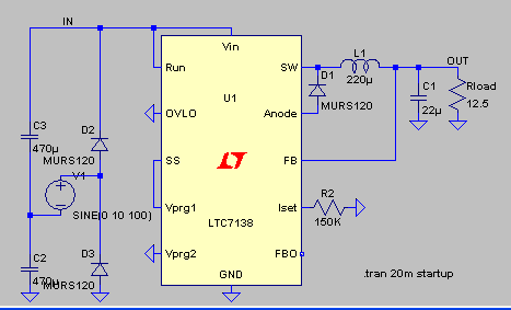

Using Mr SPEC's idea:
Using a voltage doubler to get 2x higher voltage.
Using a 4 to 140 volt PWM. at 400mA
Will need a change so the PWM will output less current at low input voltage. (easy)

Mr RON,
You are a genius :happy::happy::happy:
