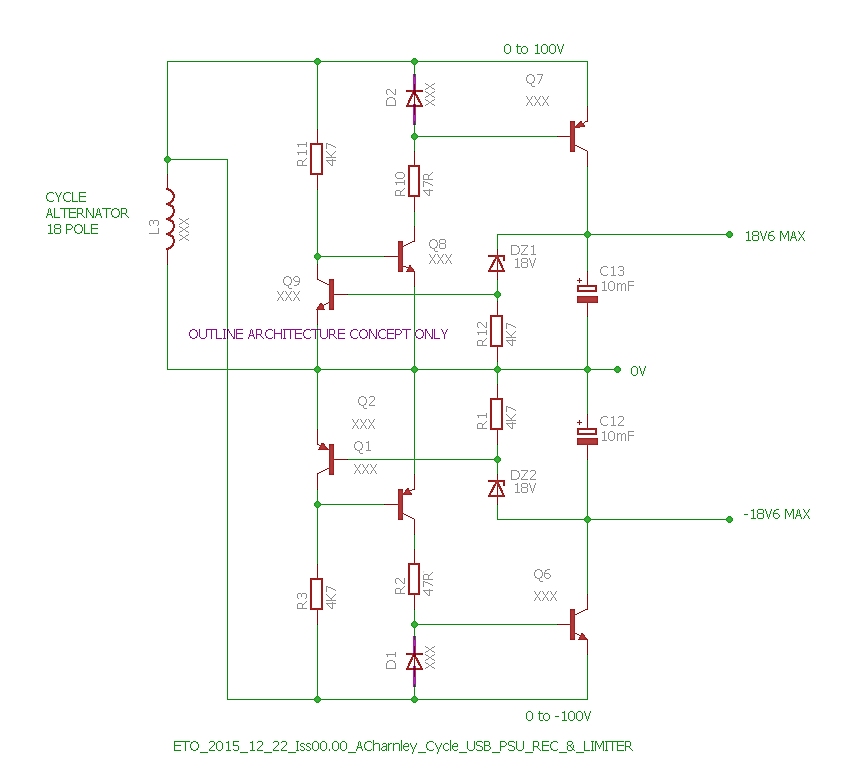

Rectification is done by the two power BJTs. The two diodes are for protection only.
I haven't checked the protection completely- all too difficult.

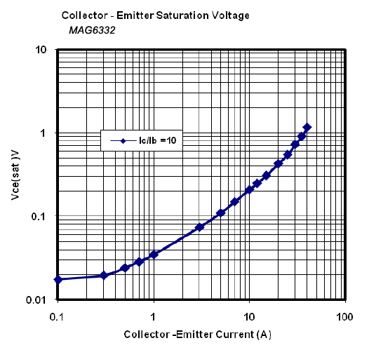

The power trans are MAG6332/MAG9942, only because I know them. They would be ideal but somethig a bit cheaper could be used on the day.
The Zeners are BZX84_18V
Q2 & Q2 are 100V VCE small signal.
The other two transistors can be any small signal.
The two protection diodes are 1N400x (100V)
Circuit Function
The circuit both rectifies and limits the output rectified voltage at 18V6 *2= 37V2. It relies on the low VCEsat of beefy power BJTs (see attached image) for good rectification efficiency.
Conduction starts when the alternator reaches around 600mV and stops when the output voltage reaches 18V6. Unlike the shunt clamp, which dissipates a load of power, this circuit dissipates little power.
Note that there may be major flaws in this circuit implementation- I havent checked- but it is the principle that counts.

ERRATA
(1) There is a major flaw in the circuit which needs sorting. No flaw in the principle though.

The approach outlined by the circuit of post 47 will achieve a low forward drop and has a lot going for it. It has a forward drop of 30mV at 1A!
It can probably be converted into a shunt clamp if that is the way required.
