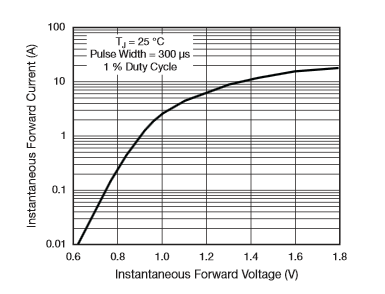

Taking a humble 1A 1N4001 rectifier diode, the data sheet shows that it can pass 1A average current, but its peak repetitive current is 30A. At 1A the diode drops 1V1 and at 30A, 2V. 30A would not be a very high peak current in a rectifier circuit but, all the same, the 1N4001 would have an instantaneous dissipation of 30W. Not only does this mess up the stability of the DC rectified voltage and stress the diode, but it is also a total loss and even though it only lasts for a few milliseconds, the average energy loss is significant. This is one of the reasons why the voltage of a TDC rectifier sags under load.
A very basic model of a normal silicon rec diode is a 600mv battery (band gap) in series with a small resistor. Shockey diodes improves on this with a bandgap of 400mV.

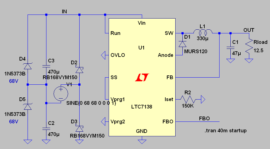

I made some changes.
Added two 68V Zeners on the input. This will limit the voltage to 136V approx. Maybe the next lower voltage part should be used.
D2,3 are Schottky to have lower loss. (150V diode)
Increased the value of L1 and C1.
There are two smaller IC if the current is low. Or R2=100k or 50k to reduce the current.
This circuit has some funny things. The PWM can output 0.4A. The input side is 0.2A at 11V, 0.02A at 110V.
So at high speed it pulls very little current but a low speed it pulls hard. Because it is designed to draw constant power.
That might be a problem.
For more current, make two PWM and run them in parallel. (0.8A)
There is a way to make it not work until the input voltage reaches some voltage. Set by two resistors. Now it will try to work at 4Vdc. Which is about 3Vac from the generator.
The dynamo is 6W/6V unsaturated, so it should give just over 1A.
In the voltage doubler mode it will deliver 12V at 0.5A-(diode drop). Then a PWM could get you to 5V at 1.1A. approx.
If you used three of the LTC7138 then that's 1.2A. You could set the first PWM to start at 4Vdc, the second to start at 4.5V and the last on to start at 5V. If you want to not pull hard at low speed.

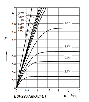

If you want the FETs to operate below 6V or so you'll need to be picky and find some which turn on fully with a really low Vgs.

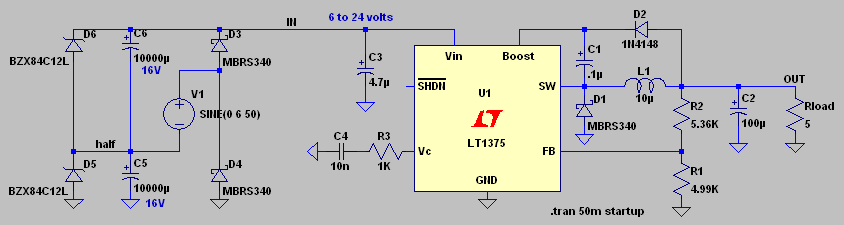

SO: I think the alternator will not go to 100V with a 1 watt load. Probably not 50 volts. I can add a 2 watt resistor and small transistor etc that will not function below 50V but shifts in at 50V. We need to learn more about what 1 watt of load does at full speed!

I have been saying all along that I didnt think that the alternator would go to 100V on load. Anyway the answer to all this is to fit a very large capacitor- like a LiIon battery.
I think D5,D6 = 12V 1 watt Zeners and will limit the voltage to 24 volts. I can not prove it with out a generator but I think this allows us to use low voltage parts. I think anytime there is even 1 watt of load the Zeners will not pull current.
Here is a 6 to 30V PWM that uses a very small inductor.
C5, C6 are only 16 volt. The capacitance is much bigger.
Need to run some tests.
I tried a 3.5 volt RMS 50hz 0.1 ohm signal and could get 5V and 1A out.

I didn't realise the FET's have such a high switch on voltage. I take it the internal diodes are used until those switch on?
To fully turn big MOSFETs fully on you may hit them with 20V or so, just to make sure the gate capacitances are dicharged fast and the MOSFET turns on/off rapidly. A high gate drive voltage also ensures that the MOSFET remains in saturation as the inductor current ramps up, but smaller MOSFETs can have quite low threshold VGS (see attached image), the logic level MOSFET families for example. The chip that Ron has chosen will sort all this out. It will incorporate a relatively small pass element with correponding low drive requirements. It also has a voltage augmenting circuit.
