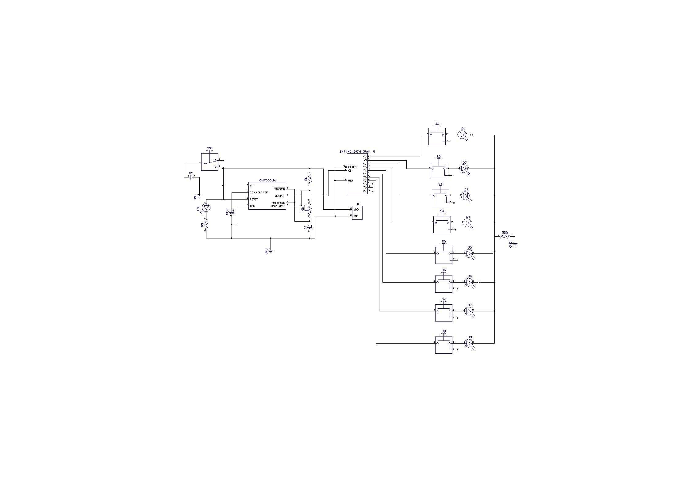

8 led battery powered circuit
EGADS!! trying to keep this simple. here is where I think I am headed

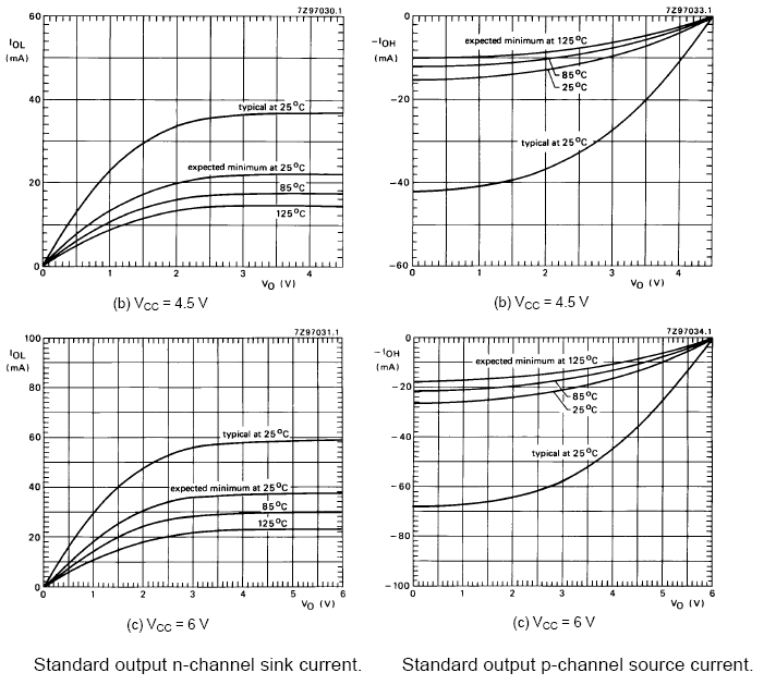

Yes, a 74HCxx output will produce only 6mA to 8mA when the output voltage drop is only 0.4V for an old fashioned TTL logic low but is many mA into an LED or load when its output has a few volts of voltage drop.
Look here:
The 330 ohm resistor in your latest schematic can be 150 ohms or less for more brightness until the output current is no more than 25mA.

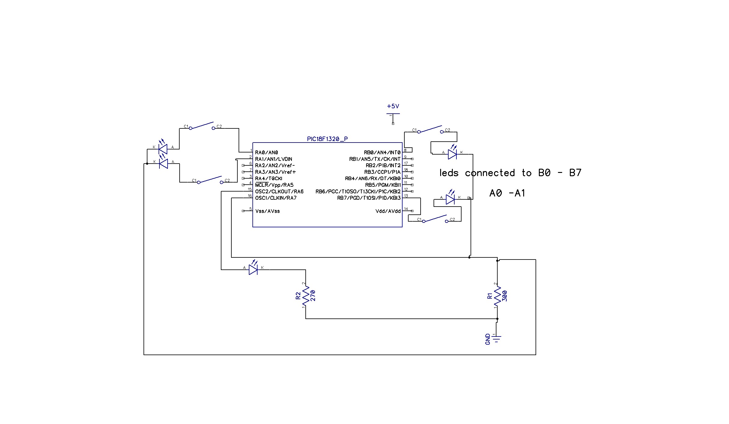

decided to go with a 18F1320 pic. here is a simplified schematic and simple code that appears to work.
objective is if any of the switches are closed thus turning the led connected to the switch on. If any output is on (any led which are toggled to simulate constant on) then RA7 (trigger) is high then RA 6 (flash) is turned on. I breadboarded and after changing the code here and there it all appears to work. NOTE only one led (B0 - B7 then A0 - A1 are turned on sequencly for 1 ms. Was / am contemplating a debounce seeing how C7 is triggered using a 1 ms pulse but havn't seen any real issues.
pin 3 does not work??
using 18f1320 so trigger is Ra7 and flash is Ra6

going to build a very simple 8 led circuit that requires very little current draw.
options I am considering are a cd4017 w/ a 7555, 8 leds with aprox. 330 + ohm resistors.

I orginally was going to go with the 74hc4017 / 7555 combo but the need for ten leds became an issue plus power consumption.
using a pic allows me to control power consumption via multiplexing and only one chip is required. A project using a micro-controller is just more efficient IMO. As for zero current?? I don't see how it is "zero current"
