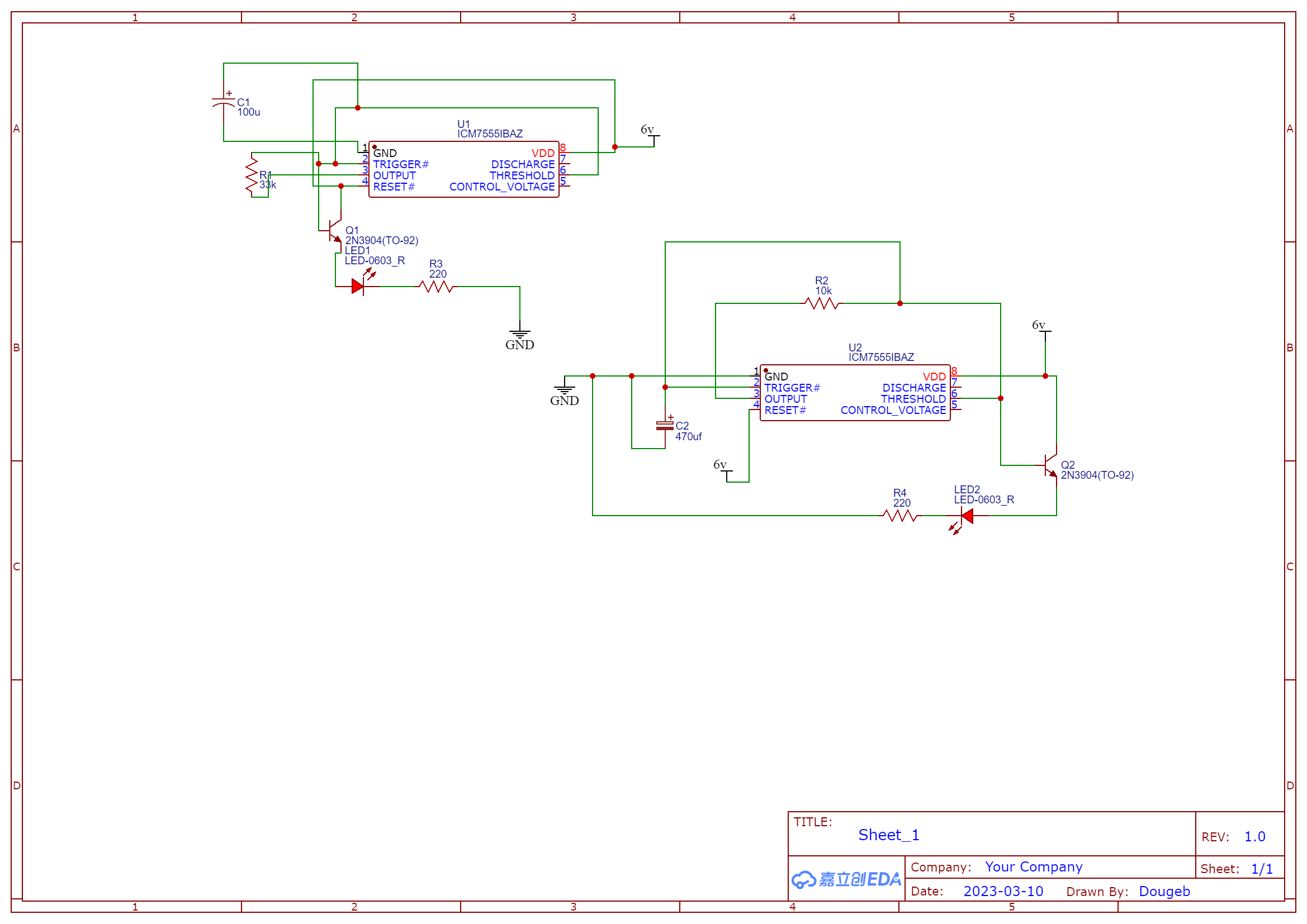

have two similar schematics for a pulsating led (white 3mm led) but the capacitors are electrolytic caps that are larger than 3mm in diameter (have only 1/4 inch height restriction. THINKING of maybe using a titanium cap or? need to order parts but the capacitor size?
both of the schematics are basically the same.

I guess you know that increasing the timing resistor (as R2), the capacitance for the same pulsing LED decreases.
I mean, I wonder what prevents you increasing R2 to 470K for example and use 10u instead of 470u.

And both are particularly poor examples - I'd like to think that you've paid a little attention in all the other threads you've created, but obviously not - why are you still putting LED's in the emitters of transistors?.
Your circuit could be drastically reduced, by using a simple 8 pin PIC - one PIC, one resistor, one LED - that's it, no large capacitors, no need for a transistor, and infinitely more effective. If you wanted slightly smaller still, then use an 8 pin SM PIC, or even one of the 6 pin SM PIC's, which still would do what you want. Essentially the same VERY simple software in either case, just to flash an LED ON and OFF.
Or for the 555 circuit, dump the transistor anyway, as a 555 has plenty of capacity to drive an LED, or at least put the LED in the collector.

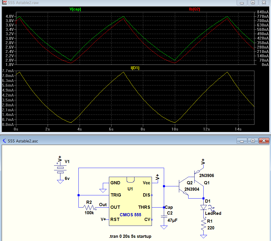

The LED driver transistor is an emitter follower. My guess is that the OP wants the LED to fade up and down in brightness rather than blink on and off crisply.
The issue is that the transistor's base current is not coming from the 555's output stage, which is designed to do this, but through the timing resistor. Increasing the timing resistor by 50x might starve the transistor. It definitely will change the timing period.
Assume the LED has a Vf of 3.5 V, the transistor Vbe is 0.6 V, the transistor beta is 100, and run the numbers.

This project uses a modern low current Cmos ICM7555, not a battery-eating TTL designed NE555 or LM555.
With the transistor emitter-follower circuit ramping voltage to the LED then the battery will last only for a short time.
If the Cmos 555 has its Discharge pin controlling the capacitor then the timing resistor can be high resistance and the timing capacitor can be low capacitance and be tiny. The LED with its current-limiting resistor can be driven with on-off pulses of at least 10mA from the Cmos 555 output and the +6V without a transistor.
I agree that the TS wants a fade, since the transistor is connected to the timing circuit, not the output.
To allow a higher value charge resistor, the transistor can be a Sziklai Pair, sometimes called a complimentary Darlington (a standard Darlington has a higher Vbe voltage and gives a flat spot at the bottom of the sweep).
LTspice simulation below:
Note that the transistor peak base current (red trace) is <1µA so the timing is not significantly affected.

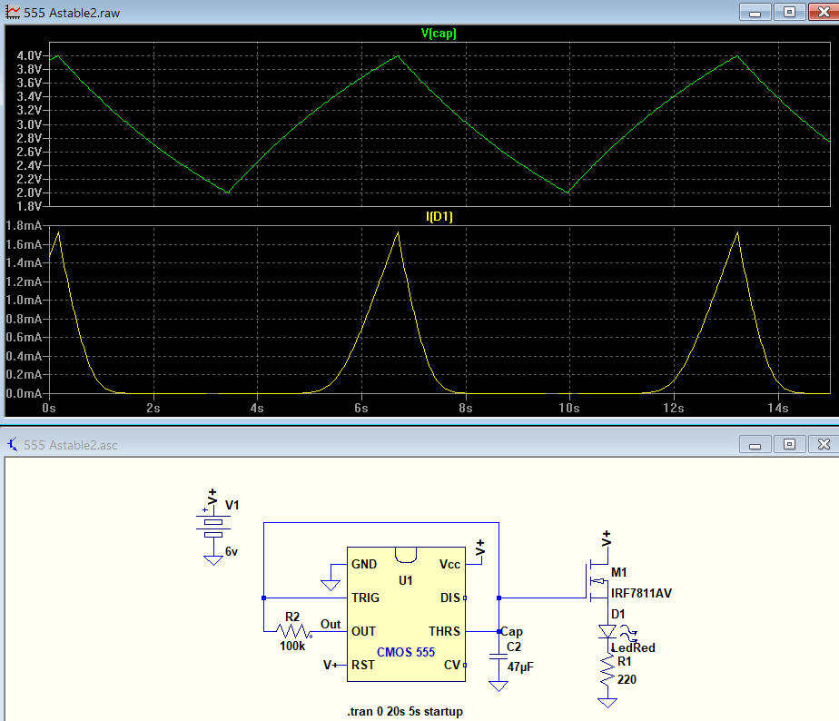

could a MOSFET be used instead of a transistor for less resistance?
A MOSFET could be use but it would need to have a very low Vgs(th) value to avoid a flat spot delay at the bottom of the sweep.
by a FLAT SPOT you mean the led would turn off briefly?
this would be acceptable.
Likely longer than you want.
Below is the simulation with a MOSFET that has a Vgs(th) of 2V.
Note the long OFF time for the LED as compared to the ON time.

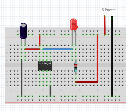

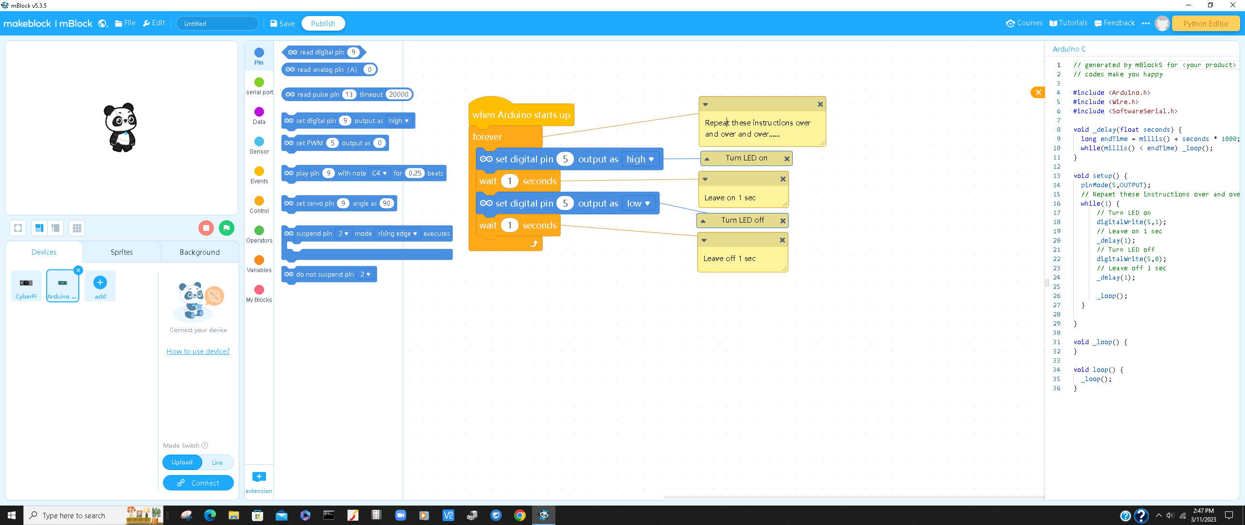

Just a chip and a R and a small cap :
You program operation, by dragging blocks out design area and config and you
are in business. In fact I could have easily added "heartbeat" with a few more blocks
to pulse LED on slowly then same for turn off. Easily could add light level control to
save power. The program is mBlock, takes your block configuration and turns it into
Arduino code and programs the Arduino chip. The code it generates shown in right hand
window. Chip to use ATTINY85 in this example.
Gets you into basic programming, a Nano board ~ $3, mBlock is free, lots of videos. Kids
in 6'th grade using mBlock to program robots.
Other examples, here is a more sophisticated timer done in mBlock :
Here is a talking voltmeter (done in another block language, once you know one its easy to use other variants) :
Regards, Dana.
Can that chip run on a 6V (or some arbitrary) battery voltage without problem?
Does that generate the ramp up and down that the TS wants?
