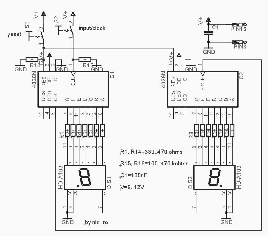

7 seg counter+pulsating circuit
richyyo
well i made a circuit with 2, 7 segment display working by 2 4026b counting chips. the circuit also has a pulsating buzzer. but after i tested it out the buzzer didnt work and the counter only works some of the times. i checked if anything was loose but i couldn't find anything. could anyone just check out the circuit and see if there is anything wrong?
(circuit diagram on doc.)
thx a lot

4026 is made in CMOS technology and must connect every used inputs (clock in, reset, etc) at ground (GND/-) or + thru resistors (100..470k) and unused inputs directly at GND or V+ (see https://www.electro-tech-online.com/custompdfs/2006/01/cd4026b.pdf )
PS: for each 4026 outputs (a,b,c, d, e, f, g) must conect serial resistors (470-560 ohms) at display inputs ...
