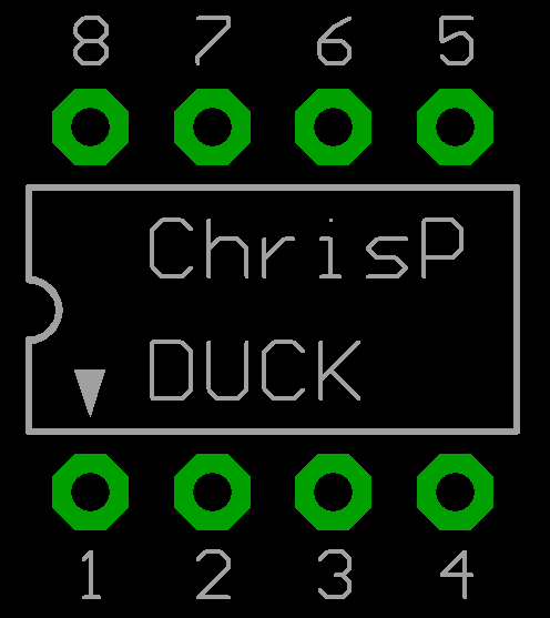

Your circuit, if wired as per your sketch should work.:)
Couple of questions,, are you 100% sure that you have identified pin 1 as top left of the 555, with the small notch at the top and the pins pointing away from you.??
Also that you are counting the pins from pin#1 anticlockwise around the 555, the last pin being pin #8.

thank you so much, i have realised where my mistake was, i was numbering the pins wrong, i had mistakenly gone 1( at the dot) down to 4, then started from the top for pin 5 instead on continuing anticlockwise.
Thank you soooo much, now i'm happy :)
here is a special IC just for you. :D
An advice, everytime you make a project always read the specifications of the components, at least the absolute maximum ratings and the connection diagram, you need them unless you know the chip very well.
At least he admitted his mistake, instead of just going away as so many do.
thanks, the IC made me smile, i've worked with 555's alot, just not in the past few years, and seems i assumed my memory was better than it is, oops!:D
Enlarge the picture, print it and stick it near your workbench to the wall.
It will help you in case of further RAM malfunctions. :D
