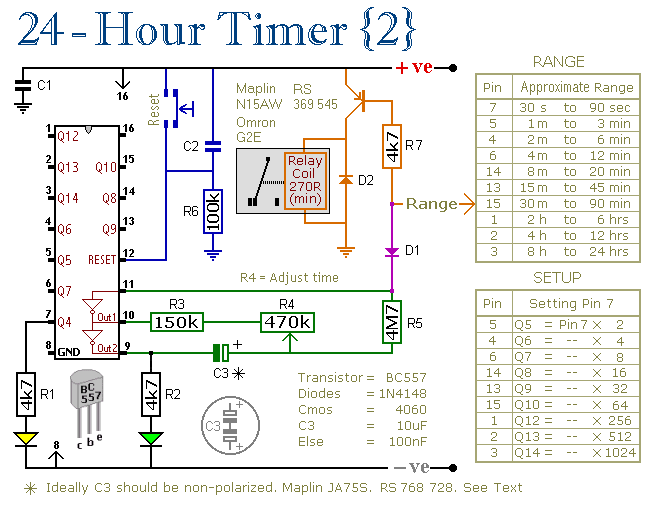

Hi Everyone, I put an amplified ipod system on my Harley and was getting noise through the amp while plugged into a store bought 12V to USB adapter to charge. I built a 5 v reg with filters that work great, but I want to switch off the charger while riding and as soon as I turn off the ignition, I want it to charge for 2 hours. I put a monostable 555 because it will work of the pulse of the ignition turning off and making the normally closed contacts to 12 volt, but not be affected by the 12 volts being there for days. Am I right on this. Thanks for your help.

Maybe a 4060B timer circuit would be better. Could I replace the relay in this picture with my regulator/filter circuit?

The 4060 has an RC oscillator, followed by a binary counter. It is useful to make long timers as shown in your link. The red PNP transistor is on until the delay elapses. The collector will be at battery potential -Vce(sat) while it is on. It should source enough current to run your Ipod via the regulator and noise filter. The purple diode D1 stops the clock after the delay elapses. You would want to replace the reset push-button with a diode (cathode toward the timer) from the ignition circuit in the bike.

Wouldn't I just want to remove the entire reset circuit. The way I understand it, the circuit will reset when power is removed (I might be wrong). I didn't pay any attention to the rc circuit on the reset. I don't understand why it's there. Didn't add it to the drawing yet.
Voltage to the circuit will only be applied when my bike is off(through normally closed relay contacts). When It's running, my ignition will energize the relay and will remove voltage from the circuit.

You want the reset applied to the circuit until the moment you turn the key off when parking the bike. That is the action that starts the 2 hour timing cycle. Or did I misread your intent?

Mike, I know this is old, but you were right about the relay. After doing some more studying, I ditched it in favor of keeping the reset applied while the bike is running( ignition), and keeping the circuit on battery. I know, just like you said in post #6. It just takes me time to understand. I am still trying to figure out if the 557 transistor and the 1N4148 will handle the regulator circuit. Here is the final, I think.
