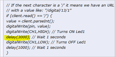

Need the above code implemented to my current code below:

It would appear, from what you've provided thus far, that some of the WiFi code above is causing at least some of the the delay. For instance, here in "void digitalCommand(WifiData" client):
This, alone, is a 3 second delay causing a "dead stop" in code execution after the Led1 in turned ON.
And, overall, it looks like every single, individual command from the PC is a separate, distinct WiFi comm event, i.e., "Connect - do one thing - Disconnect". This, instead of "Connect - Let me move camera to where I want it (Left, Right, Up, or Down) - Ok, Now Disconnect".
I might suggest, at this point, that this project may need a re-boot. Believe me, I am very sympathetic to your development efforts and the time that represents. I've been there.
But I think your goal can be reached with a considerably less complex and much more responsive system, if your willing to start over. Not an easy decision, of that I am sure.
What do you think? It'll still be your creation: Just a little external guidance here and there...
