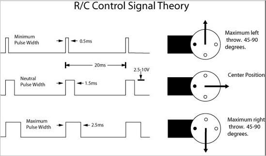

Here are the ranges of PW you'll need (these are "ideal", some variance may be needed):
(This pic may be copyrighted).

From the LM555 data sheet the pulse width will be 0.69 mS when the 10 K resistor is selected and it will be 4.71 mS when the 68 K resistor is selected. So you can see both values will try to make the servo go past the limits of its travel. See thse information on this web page.
Les.
I don't know which of CBB's posts you are referring to but in post #26 he gives the neutral value as 1.5 mS (Or if you prefer 0.0015 seconds or 15000 uS or 15000000 nS)

Always had in mind to send the ON pulse starting every 20 ms. As it have been said, the point in question is how fast the ON pulse's width varies within the 0,5 to 2,5 ms range. The 20 ms repetition rate should stay unchanged.
