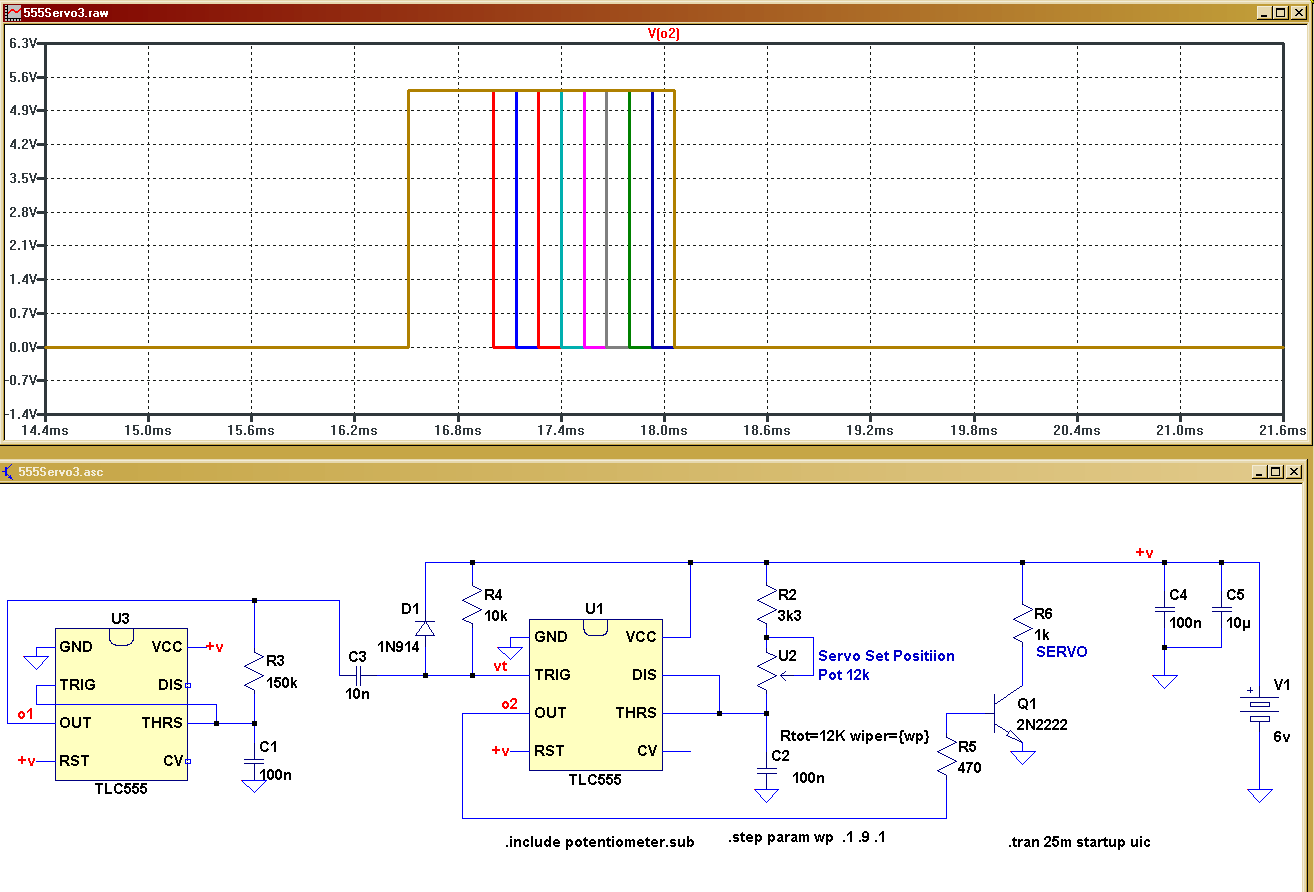

I posted a suitable servo drive circuit in post #4, all he has to do is limit the time period range of the monostable section to suit his servo motor
I don't see how that slowly goes form one pulse-width (position) to a different pulse-width (new position)? :confused:
hi Carl,
This is a tidier plot image.
The left side 555 is obviously the 50Hz Frame Astable.
The other 555 is configured as a Monostable, whose On period is set by pot U2.
The LTS plot shows the pulse width increasing as pot U2 is increased, approx 0.5mS thru 1.5mS.
If I understand what the OP is asking, he wants to slow the 50Hz frame down, why he would want to do that doesn't make sense to me.
All he has to do is use a multi-turn pot for U2 and turn it 'slowly'.
Is this what you are querying.
Eric

I don't know which of CBB's posts you are referring to but in post #26 he gives the neutral value as 1.5 mS (Or if you prefer 0.0015 seconds or 15000 uS or 15000000 nS)
Les.
Ah...My fault, 1.5ms is the same as 1500uS.
Yes I was referring to post #26.

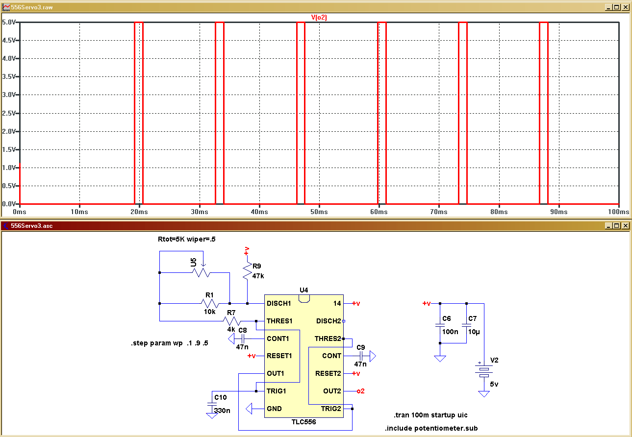

hi 2000,
This the 556 circuit in LTSpice.
The pot is set to 50%
Okay.
But my understanding, is that the signal is remotely generated by a micro and he doesn't want to have to turn a pot.
The circuit I posted, just requires a single digital level change to go slowly from one pulse-width to the next.
