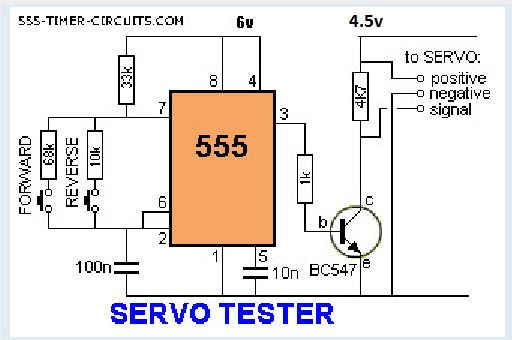

555 timer circuit for servo, how to reduce speed?
Model servos are position controllers. The position required is defined by the width of the pulses from the pulse generator. The pulse generator circuits you are using just tell the servo to move to one of the two positions defined by the two preset pulse widths. The servo will just move at its fixed speed until it reaches on of these positions. To change the speed it moves you would need to control the rate at which the pulse width changes. You would be telling it to move to a position close the tha last one ten to move to a position a bit further from the starting position and so on. You wold probably be better off using a potentiometer for setting the pulse width rather than two push buttons. The speed it moved would then be contropled by how fast you moved the potentiometer.

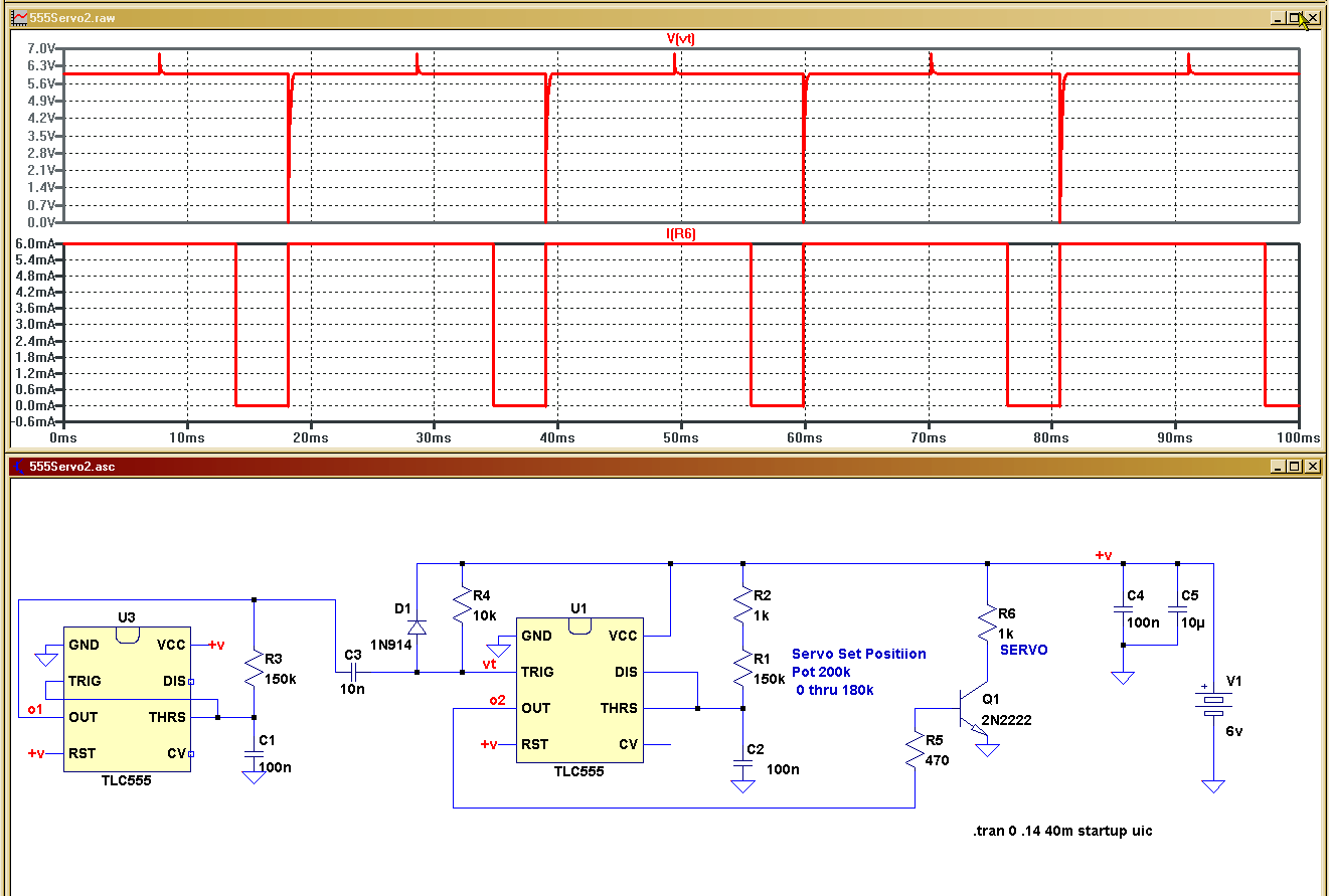

The servo position is based on a 20mSec frame period.
During each 20mS period the output is set High for a period of time equal to the amount you require the servo to move/hold to, from its starting/rest position.
Do you follow that OK.?
E
This is one option for a final circuit.
E
Hi all,
Thank you all for the explanations.
les, adding a potentiometer is a good idea but I still need the push buttons for clockwise and Anti-clockwise because the push buttons will be replaced with relays controlled over internet, but currently the rotation is turning too fast.
Will it help if I add a 100K potentiometer between 1K and BC547?
ericgibbs, from the picture you sent there are 2 x 555 time chips used will this slow the rotation?, will do an experiment with your circuit.
thanks,
hi 2000,
If its a servo system, it should not rotate.???
It should turn a number of degrees from its rest position to the degree value set by the period the servo drive is High.
Usually less than about 210 deg max.
E

My question is what do I have to do in order to reduce the speed of the servo rotation?
In DC servos, torque is a current issue and rotational speed is a voltage issue.
Reducing the voltage will slow the servo.
Don't have any idea, in this case, how the torque will be affected, but this is just a test.

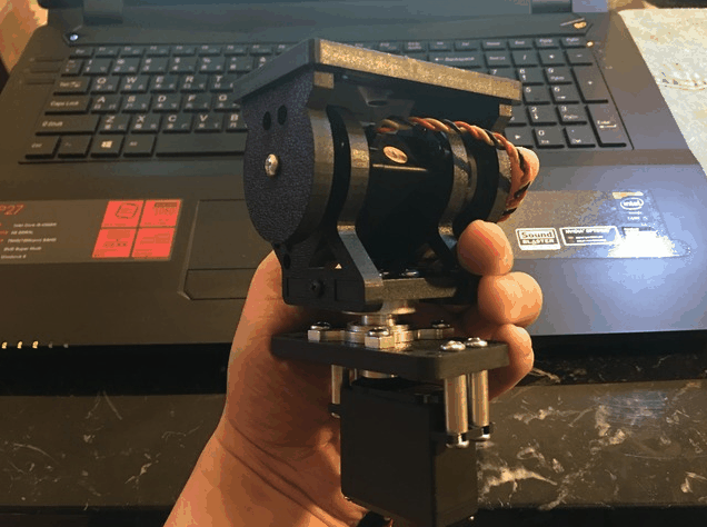

Looking at the OP's link showing the actual pan/tilt head, it looks fairly substantial.
A general purpose transistor, BC547 will not be suitable.
Also have you calculated the torque required to pan/tilt that head.?
Is your servo motor able to provide that torque,? as it appears to a be direct drive.?
