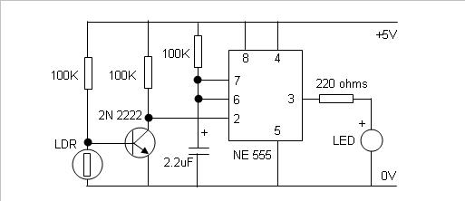

I have this circuit. When dark is applied to the LDR, the output LED will light up.
I tried with many opamp’s but I’m not satisfied with their performance.
I need a 5V output when dark is applied. Also it must be very sensitive. The output must not float in between 0V to 5V. It must directly show logic 5V or 0V.
Can you please see this circuit whether it’s ok or not.

I would use a Schmitt Trigger.
You can make one either from an Op Amp (or Voltage comparitor) or use a CMOS Hex Schmitt Inverter such as the 40106.
I suggest that you post the circuit of the Op Amp one that you are not happy with so we can analyse it and suggest imprevements.
What was the issue that you were not happy with?

Didn't you look at the datasheets for the 555, the 741 and the LM358?
The output low of an ordinary 555 is +0.1V when its load current is low. Its output high is +3.6V.
Many 741 opamps don't work if their supply voltage is less than 10V.
If you found a 741 that works with only 5V then its output low is +1.2V and its output high is +3.8V wothout load current.
The LM358 works when its supply is as low as 3V.
With a 5V supply its output low is 0V or +1.0V depending on its load current.
Its output high is +3.8V without load current.
You need a Schmitt trigger or a circuit with hysteresis to switch quickly when it gets dark.

If you want it to operate on 5 Volt, there are at least 3 solutions.
1. use a 74HC14 Hex Schmitt Trigger IC. This has enough current source and sink capability to drive a LED. This solution requires the least number of components. But don't neglect to connect the unused inputs to gnd.
2. Use a Voltage Comparitor IC such as the LM311 configured as a Schmitt Trigger. It has a transistor output that will drive the LED, see the data sheet for details.
3. Use an Op Amp that can operate from a single 5V supply and use an N channel MOSFET (such as the 2N7000) to drive the LED.
Options 3 & 3 have the advantage that you can set the hystersis according to your need. Whereas, in the case of option 1, the hystersis is set inside the IC.

There is a Schmitt Trigger inside the 555. But the problem is that the hystersis is set inside the 555 to about one third of Vcc. This is probably too wide for your situation.
