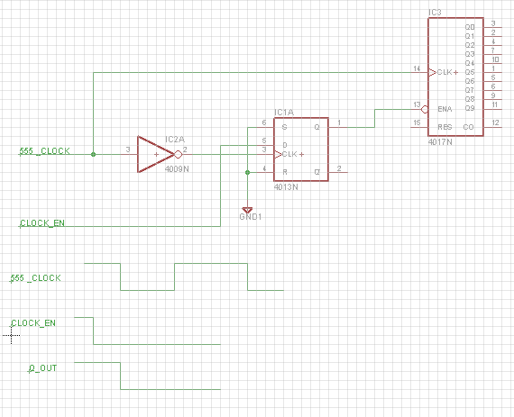

Why not just tie clock enable to ground?
You could go the synchronous route and resync your clock Enable signal to the falling edge of your 555 clock. This would guarantee that clock enable is low on the rising edge of 555 clock. See attached diagram.

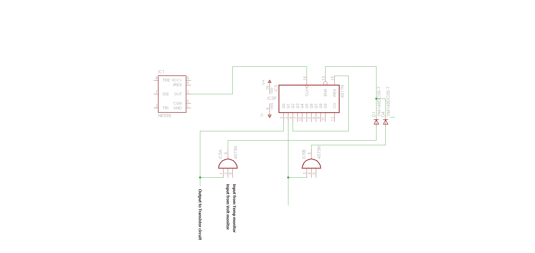

Thanks Mikebits, but to be honest, not not sure how your circuit would work.
But, here's my setup, its a battery charger that switched the charging source from 1 battery to the next, once full or starts to overheat.
The 4017 will output on 1 this will drive a transistor to power an external circuit to allow the charge to be supplied to that battery, The outputs from the voltage and temp monitoring circuits remain HIGH whilst the Voltage and Temp is below set thresholds, this along with a feed from the 4017 output is fed into the 4073 AND gate. Therefore the ouptut from the 4073 to the 4017 ENABLE pin will remain HIGH when the battery still needs charging and hasn't over heated. The feed from the 4017 output directly into the 4073 is to only allow that perticular charging channel to hold the sequance/transfer, otherwise if another battery was full and within temp it too would hold the circuit from transfering onto the next channel.

Well, your circuit seems a bit odd, and I will have to stare at a bit. Hard to read with everything sideways. As your diagram is drawn the diode or gate D1,D4 will not work right. It needs a pulldown resistor to ground on the cathodes. See image.

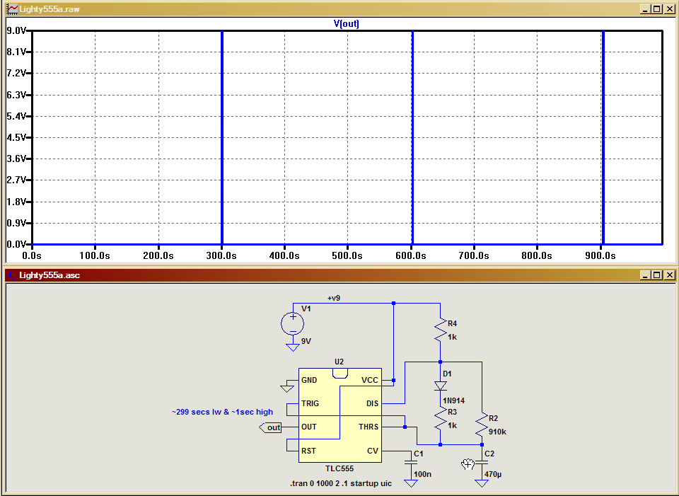

I know that you want a pulse from the 555 that is 1sec high and a 299sec low, thats easy to do.
But what is the purpose of the 4017 and what are you trying to do with the project.????:)

Here is the 555 299/1sec pulse generator, use a CMOS version of the 555

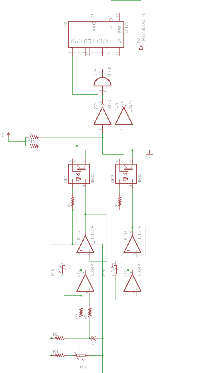

Here a schem of the circuit.
The reason I've gone with the current opto setup, is incase a "monitor" module is not connected to the battery, it wouldn't hold the Enable high.
Do you understand what I'm trying to achieve, I'm taking it step by step to solving each problem as it comes...... probably not hthe best.

Looking at the circuit diagram, the logic isn't going to work the way you expect.
If you forget the actual variables that you are measuring and think in logic states it will be easier.

If the battery is disconnected, or the battery is full, the LED on the 4n35 will be off (opto connected to + rail and sinking into the Opamp?), therefore the making the input into the Inverting buffer HIGH (due to pull up resistors), the output of the inverting buffer will be LOW, and along with the AND 4073 IC will make the ENABLE pin on the 4017 LOW, allowing it to step.
Is this not correct?
And if the battery is connected and is flat, the LED on the opto will turn ON, and basicaly ending up with the ENABLE pin HIGH (provided its not overheating and it active on that channel, feed from the feed from the outout of the 4017 into the 4073.

My concern is that the design drawing is showing only one of the five control circuits, I think as the number of control circuits increases the logic is going to get very 'messy'

If I read this correctly, these two conditions, as you have only one battery voltage test line to each battery, means even with a fully charged or open circuit battery line, the alternator will run open circuit at this point for 300secs.??
1. If the alternator voltage exceeds 14V ( in the event a battery has been disconnected, or fault with the high currrent relay) it must trigger the 4017 to step to the next battery, perventing the alternator running open circuit.
It must appear that I am being negative in my posts, but I dont want to mislead you with your project.
I would advise you to draw out the complete design showing all 5 control circuits with any additional battery sensing.
Also consider the design requires some form of fail safe features.
