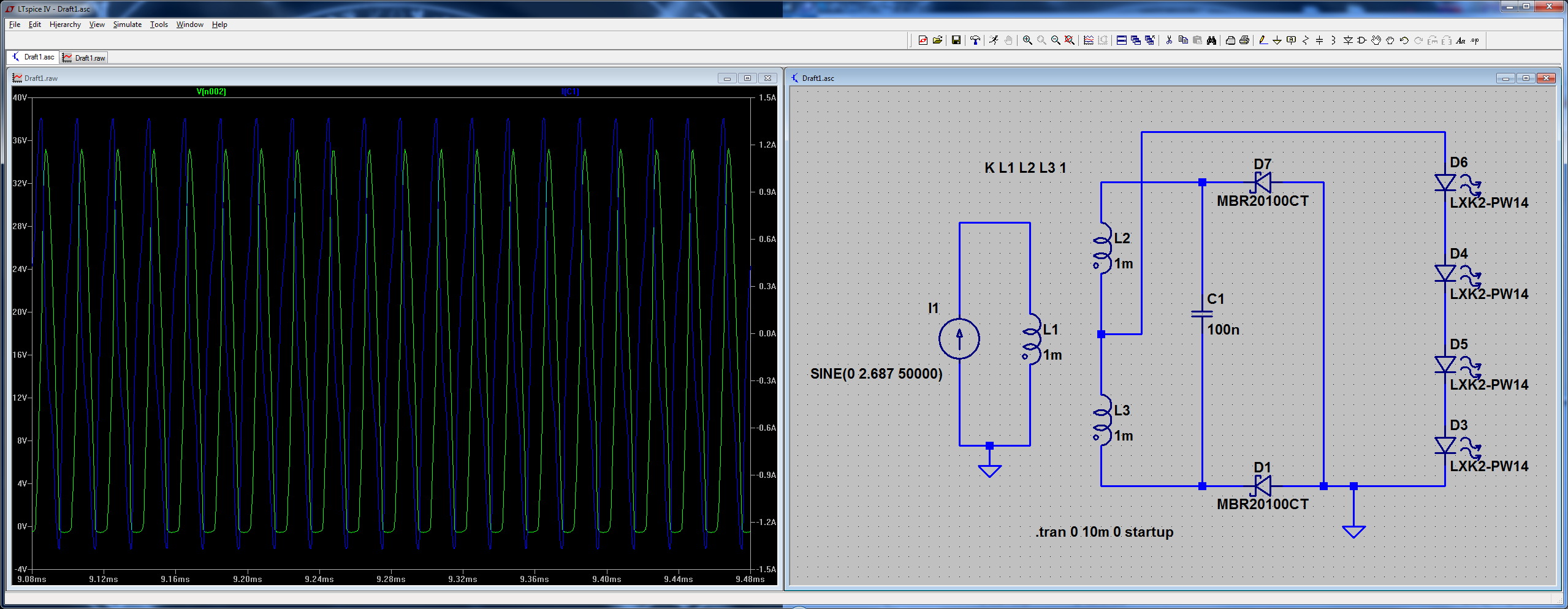

C1 probably wants to be from CT to ground to provide smoothing.
Will the transformer work at 50Khz?
The transformers used in this product do work at 50KHz. C1 should stay where it is though, and this is according to the senior most engineer.....what do you think C1 is for? And is power factor important so that the 50KHz AC current source power supply doesnt have to supply so much reactive current.?
I have uploaded the image....well , i tried to but it wouldnt upload.....it just kind of greyed out and was unresponsive.
What do you think C1 is for?
My experience tells me it can really only be a filter/smoothing capacitor, and I agree with ronv, it is connected wrong.
In the configuration shown, C1 wastes an amp or so of current by being a short circuit from L2 to L3. And the effect really doesn't filter out anything.
With the placement you would expect for a filter cap, it doesn't waste nearly as much current, but is far to low a capacitance to do any real filtering.

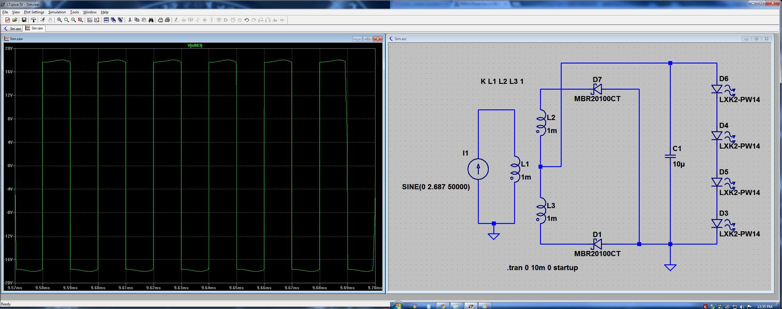

With a larger capacitor, the filtering increases a lot, but then the current passed starts to go back up again.

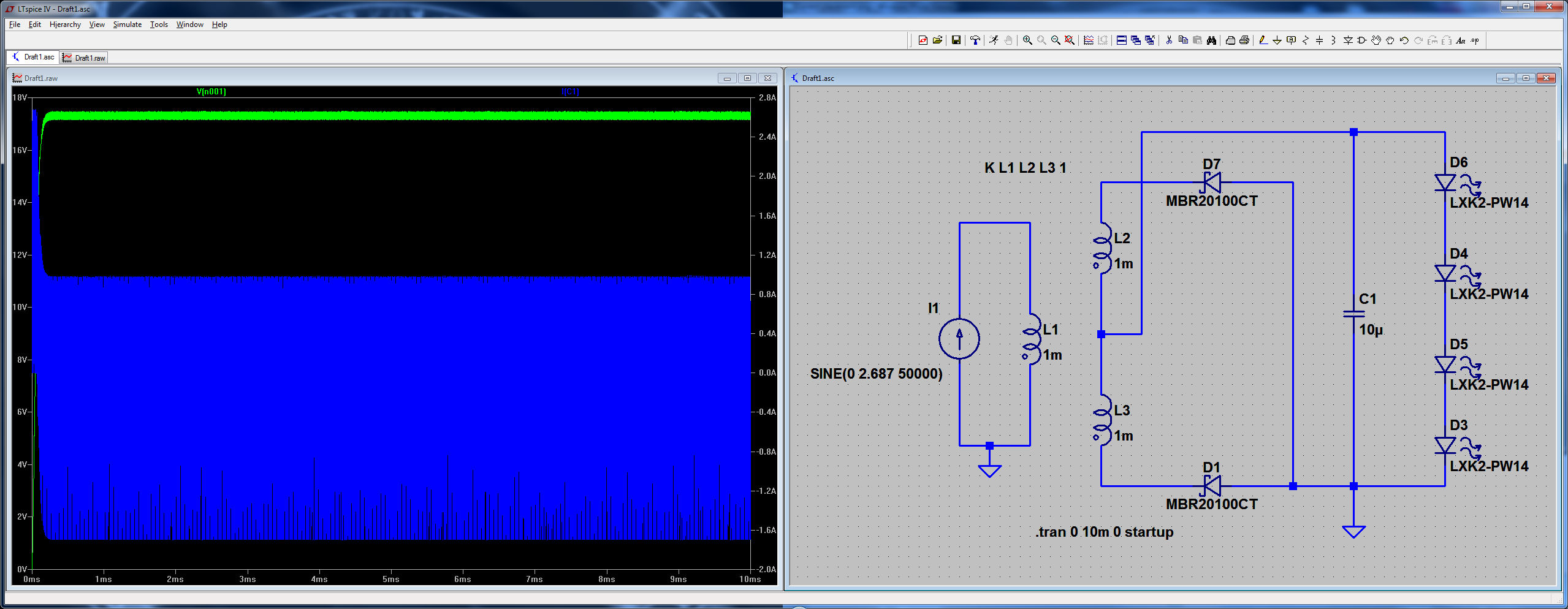

With an extra inductance working with the capacitance to create a true low pass filter, you get your cake and get to eat it too.

Here is the sim again, this time showing the primary voltages. Also note that the coupling directive has been switched to a comment (disabled) This makes the primary act as JUST an inductor. And it gets 800+ volts, as expected.
But when I enable the sim directive so that L1 returns back to being a transformer, it really doesn't develop 800 Volts across it, just a mere 18.
This is proof that loading the transformer is lowering the effective inductance. Which actually should have been a no brainier.
