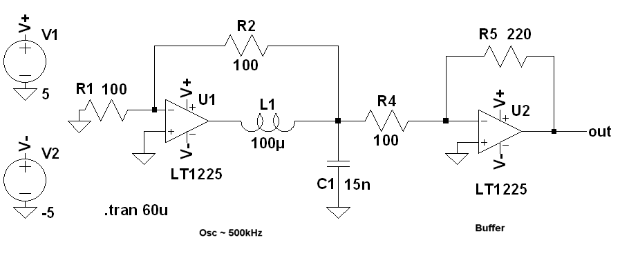

You could try something like this :-
@alec_t:
That looks simple, and has no lamp. I assume L1 is just a choke?
Could i use U2 for voltage gain with the feedback network or would i need
an additional op-amp stage to do that?
Or using 2 identical bridged push pull stages would care for the correct voltage level maybe.
Assuming that this can be done at that frequency with the right transistor pair.
This second circuit relies on the phase shift (of 180 degrees) across L1 and C1 at resonance, that is then fed back to the inverting input of the op amp to give 360 degrees loop phase shift. Both circuits should work equally well. The Wien Bridge in the Nat Smelly apps note relies on the JFET to provide a variable gain to keep the oscillator stable, whereas the LC circuit has no such circuitry leading me to believe that the Wien Bridge might offer lower distortion. As an exercise, it is worth going through the Wien Bridge network and working out the transfer funtion. You should be able to determine that at resonance, the circuit needs a gain of exactly 3 to overcome the losses in the feedback network
I don't see why not. I ran the sim in LTSpice with R5 = 200 and got a reasonable looking sine wave (but much higher values were iffy). You've clearly got LTS set up so can easily check.
I haven't checked out distortion figures. What sort of figure are you after? (and out of curiosity what are you going to apply the 500kHz to?).
As Simonbramble mentioned, there is no provision for stabilising the output of that LC oscillator. Is that a problem? What accuracy/stability do you need? And yes, L1 is just a choke.
