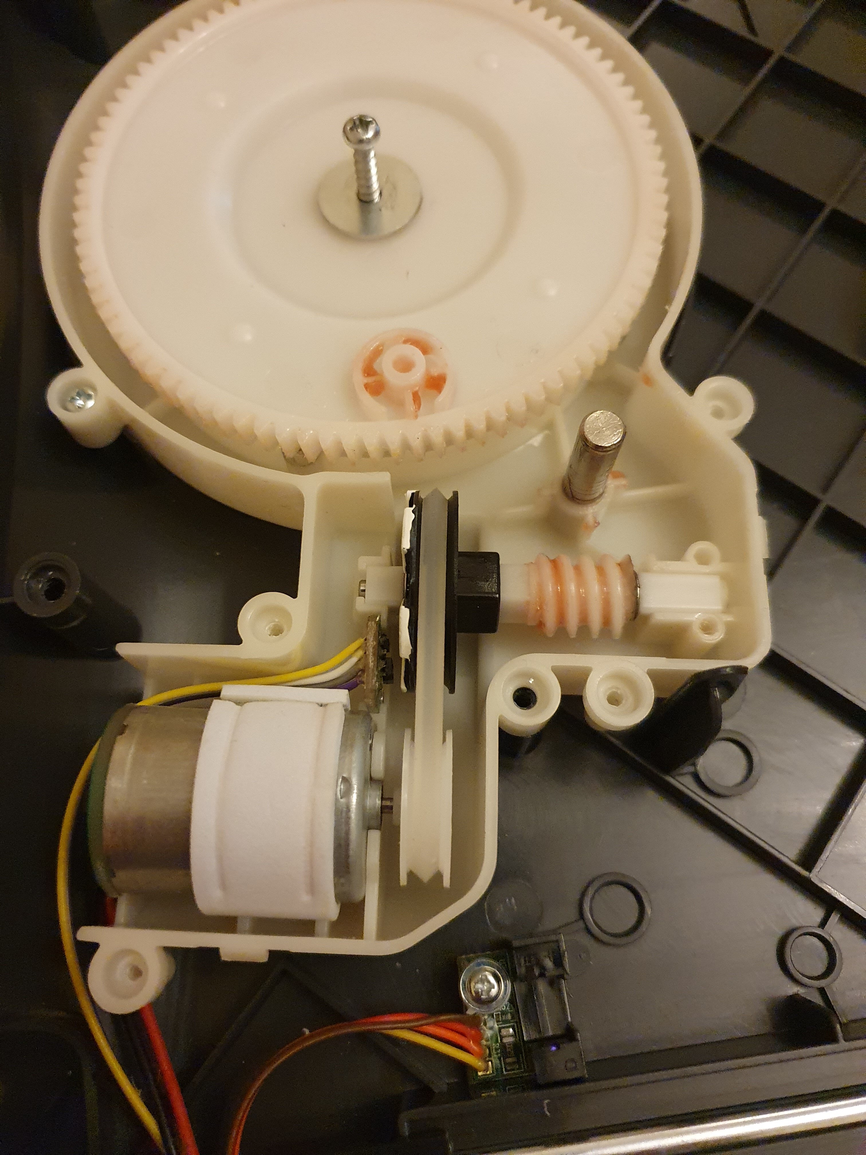

I'm not sure what is allowed here or what details should be posted but my sister gave me her 4Moms MammaRoo 4.0 baby cradle to look at as it's stopped working.
After a bit of investigation I've narrowed it down to a little sensor that monitors a wheel rotated by a small motor. The wheel is black with white segments painted onto it. This sensor must monitor these white segments and if the wheel stops turning it then cuts power to the motor.
From a bit of research this sensor appears to give a lot of problems and so many reports of ways to fix etc. Ideally I'd like to just bypass the sensor, I don't see the point.
I'm wondering if the 4 wires might even be able to be joined to just allow the motor to keep running.
If it can't be bypassed then I'm wondering if they can be purchased anywhere?
I've attached the photos of the sensor. Any help would be greatly appreciated.
Thanks,
Mac

It appears to be the sensor that turns off the motor if something/someone stops the motion of the rocker. That way, the motor won't burn out and decreases risk of overheating/fire of an electric device that an infant human is strapped into. I recommend not bypassing it.
you can try contacting 4Moms, a Pittsburgh PA company.
Also, it is a smart power pack - it will play music and "power up" but not rock unless you use the original power supply.
https://www.4moms.com/products/mamaroo-replacement-power-cord

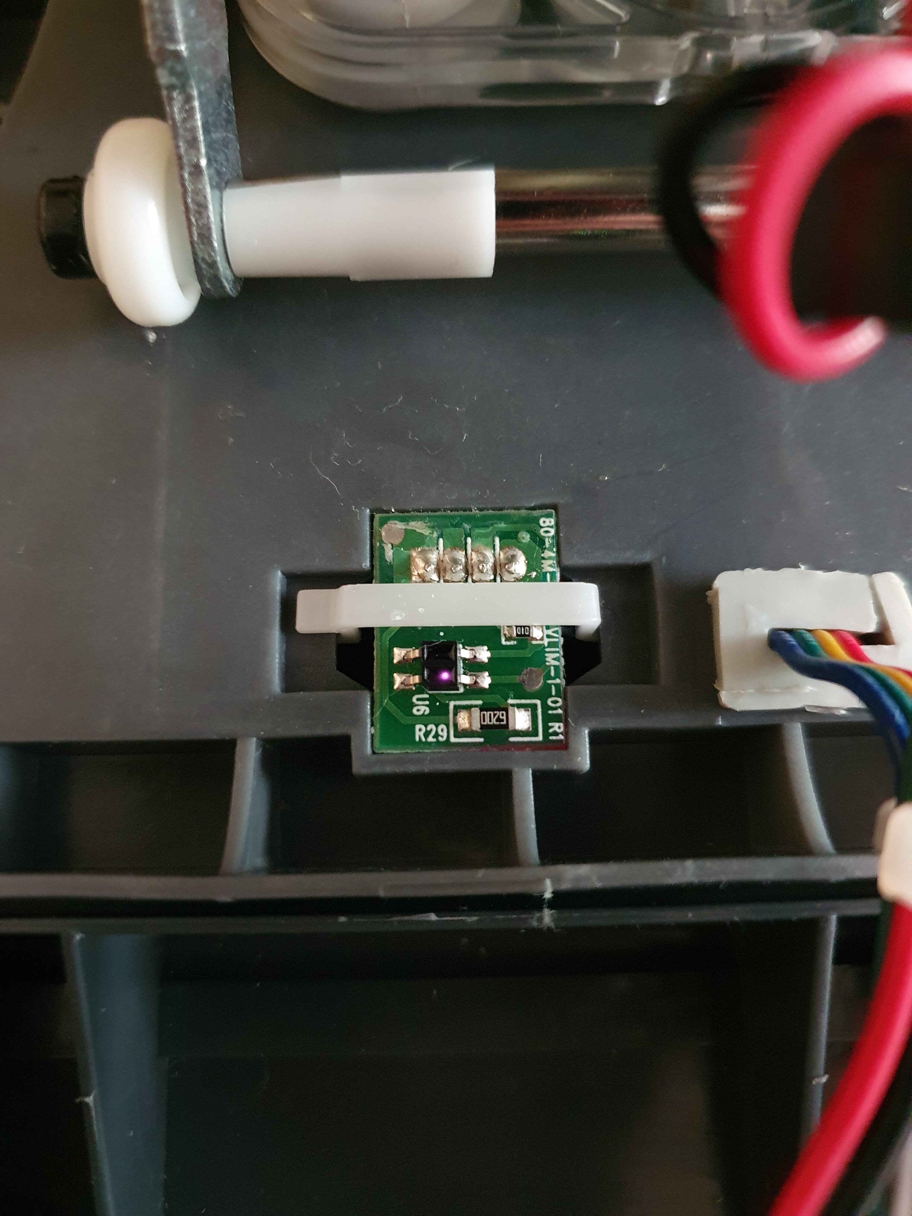

Looks like the sensor is a photo sensor. An LED shines onto the disk, and a photo transistor sees the reflections from the light segments on the disk.
The controller may use the pulse stream to determine speed, so it's probably not possible to (easily) bypass this sensor.
Here's the datasheet to a similar **broken link removed**. You can test it by looking at it with a camera (phone) to see if one side is lit. You can then measure the voltage across the two opposite pins and see if it varies when you place something white in front of it. It could just be that the disk is not as bright as it used to be.

There doesn't appear to be any light emitting from the wee sensor anyway
I'm not able to upload the little video clip on here...
New camera phones and cameras have ir blocking. You can take the camera apart to remove the IR filter (the Raspberry pi camera is easy). Or you can just buy the No-IR version of the pi camera if you want to experiment.
Thanks guys,
Would a FlirOne IR camera attachment for the phone pick it up?
No, flir cameras get 7um to 14um wavelengths. These are typically 850 to 950 range.
If you have a lab power supply or a battery and some resistors, I can walk you through the process of testing the IR diode and the photodetector (photo diode or phototransistor). A good multimeter (Fluke 87) in diode mode could is also helpful - specifically, diode mode that can go well over 1 V.

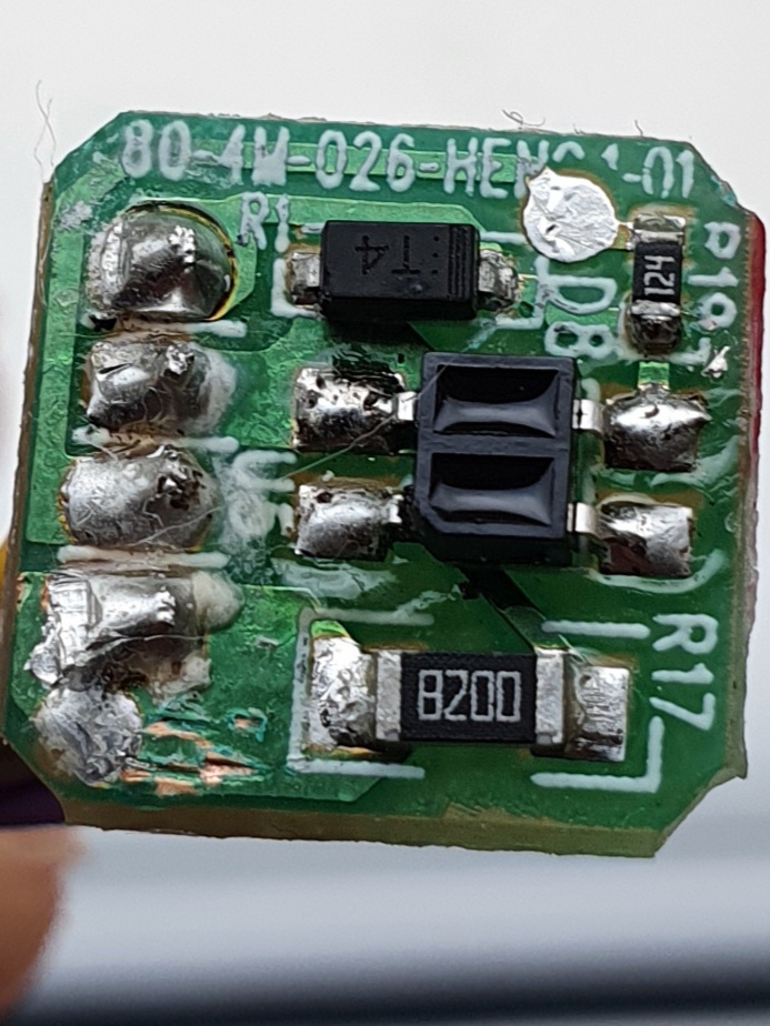

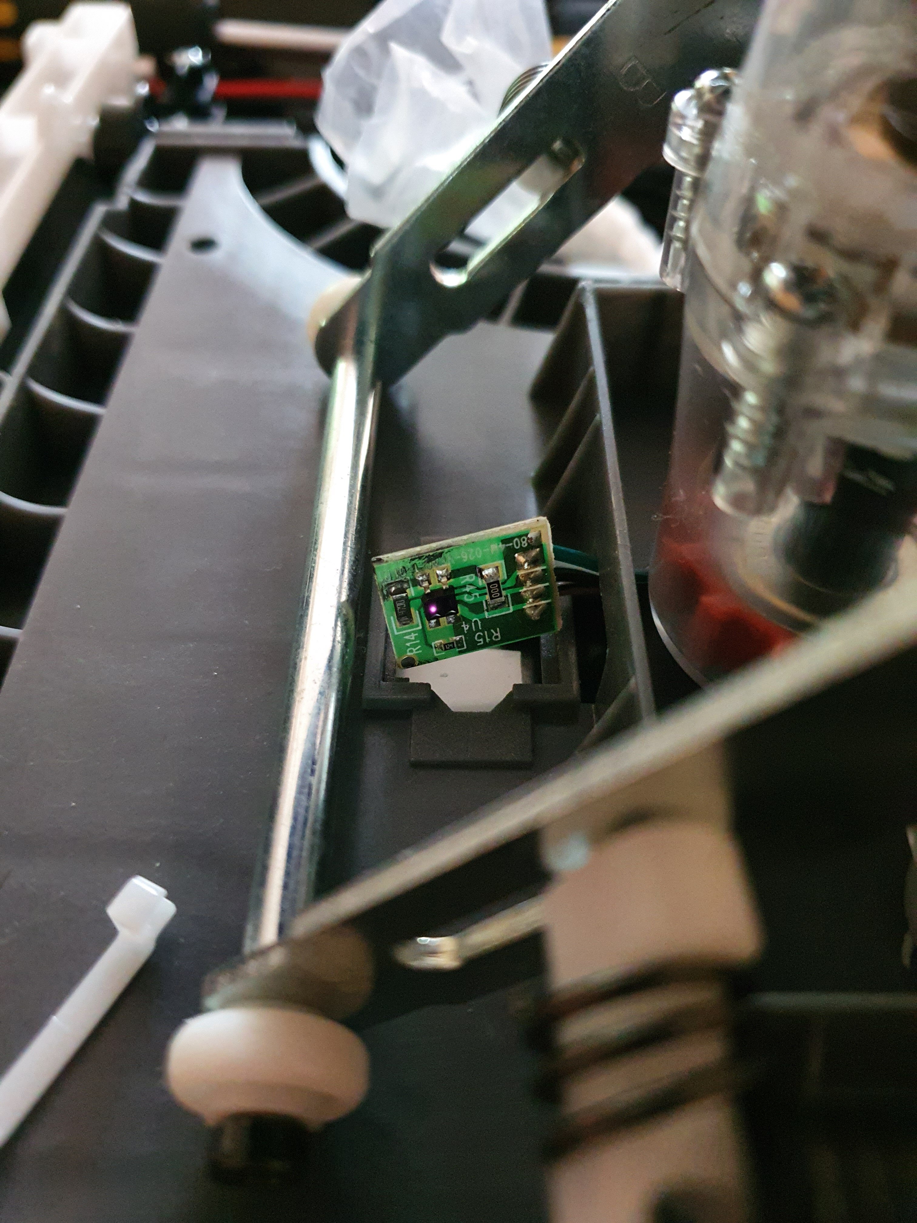

Hi folks,
So, after a bit of investigation this morning I can confirm that this wee sensor is faulty.
I used my phone on the other two similar sensors on the machine and they actually do light up where this one doesn't.
On my previous post I linked a YouTube video of some guy posting the same findings and he suggested replacing the wee resistor to the side fixed it for him.
I'm not sure if my soldering skills would be up to this job so I might look around to see if some local company might be able to replace it for me.
Could anyone confirm if those resistors I linked above are the correct ones?
Thanks again for all the help
Cheers,
Mac

Although photos of solder can be mis-leading, it appears to me that the solder is very poorly placed on R17 (near the 7 of R17 text). You can take a soldering iron, heat it up. Wipe the iron across a fairly damp sponge several times to clean the tip, wait 5 to 10 seconds for the iron to get back to temperature, and touch the iron to that resistor edge AND the little pool of solder next to it at the same time). In just 2 to 4 seconds, you should see the solder flow up the side of the resistor and then remove the iron. Don't heat too long, if nothing happens in 5 seconds, repeat but at a little solder as you heat.
before you start, you can take some more photos at a better angle to confirm for yourself that the solder is not well placed.
Hi there,
Thanks for the reply.
I tried to take a better picture in better light but I'm not sure if the solder is that bad?
What do you think?
Thanks,
Mac
if you have a multimeter, measure in ohms by touching solder pads 1 and 2 and hopefully you'll measure 820 ohms. If not, measure 1 to 3 (I cannot be sure where which pad (2 or 3) the copper trace connects below the proximity sensor).
if you get infinite resistance both ways, either the resistor or the solderjoints on the resistor are bad.
also, double check that the solder under pad 1 in my photo is a good solder joint.
