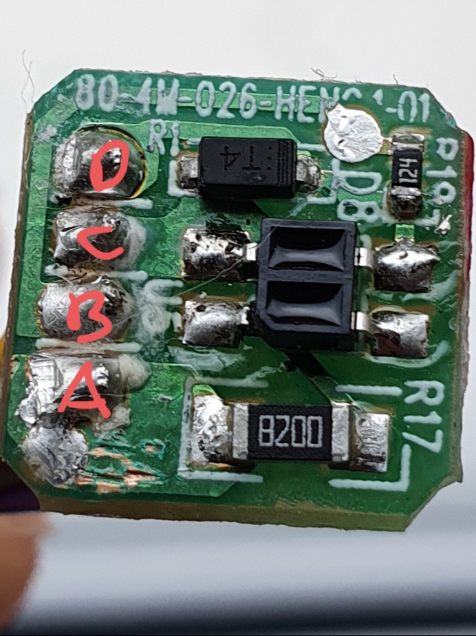

I have followed what you have suggested, I think, and below are the results I got from these tests:
With the negative lead on pin 3 and the positive lead on pin 4 the reading MAY drop if you shine a bright light on the sensor.
- to pin 3, + to pin 4 = 0.61v, bright light = 0.61v
A better test would be to power the unit up and the meter set to the 20 volt DC range You should get a reading which should drop when yo shine a bright light on the sensor. As we know that the IR emitter is not working I think the doing the following tests would be more useful. With the negative meter lead still on pin 3 measure the voltage on pin 1 (This is the power supply to the IR emitter.)
- to pin 3, + to pin 1 = 11.04v
Also measure the voltage on the two lower pins of the sensor (With the negative lead still on pin 3.)
- to pin 3, + to pin 2 = 0.00v
I also decided to check the voltages across the 4 pins for the wires coming to the board, let's call them A, B, C & D.
A= 11.04v
B= 3.29v
C= 0.00v
D= 0.60v
Not sure if this helps any? Photo attached...

I don;t understand your statement " I also decided to check the voltages across the 4 pins for the wires coming to the board, let's call them A, B, C & D."
Across implies between two points but each line only gives one point. So the readings must be with respect to some unspecified reference point; This does not really matter as i was interestes in the voltage on the lower two pins of the sensor chip. The pin numbers you used do not seem to match the numbering shown on page 2 of the datasheet that Pommie provided the link to in post #5. Assuming that you did do the measurements to the lower two pins on the sensor chip the IR emitter has failed. The voltage difference between them should be about 1.2 volts. (You measured 0.6 volts.) As you have checked the value of the 820 ohm resistor and the voltage on the positive end of it, it is the sensor that need replacing. I suggest cutting the legs of the chip close to the body with small side cutters and then un-solder the remains of the legs one at a time to reduce the risk of damaging the board.
Les.
The tests really suggest the emitter is bad. I'm suggesting that the emitter could be damaged by the act of putting a (V battery into the module (I'm assuming a 9V battery). It's easy to briefly connect the battery briefly to the wrong polarity. So, it's a design problem.
I didn't see a link for the datasheet. With a datasheet, I can confirm the reverse voltage spec of the LED. (I'm assuming 5-6 V). Since it's a common problem, it might be reported to the manufacturer with the fix.

The emitter side is definitely bad. Adding a diode and changing the value of the 820 ohm resistor can protect the emitter against reverse polarity. it might be possible to do with an SMT diode. I didn;t yet look for a possible replacement. We need the pic of the board taken with a ruler or something of known dimensions in parallel with an edge or what your trying to measure. A dime would even work.
Les.
Hi Les,
Yes, sorry, it doesn't make much sense when I read it back to myself again either...
I set the negative wire of the multimeter into the headphone jack and then the positive wire on the multimeter to each of those points A, B, C & D and got those voltage readings...
But, as you have confirmed it's irrelevant as you confirmed the IR emitter has the failure.

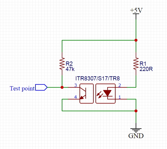

I am currently doing a project using the **broken link removed** I posted a link to earlier. I'm using a 5V supply but much should be the same. I used a 220R resistor to limit the LED current = 16mA (I think yours is ~10mA). I used a 47K resistor in the collector and with no reflection got >4.9V at the collector of the receiver (transistor fully off). With a piece of white paper 1mm away from the reflector it read <0.5V (transistor fully on).
This was the circuit,
Are you able to trace your circuit to establish if it is similar? Are the other two opto boards identical to the not working one? Are you confident enough to put a working board in place of the broken one and take some readings?
Note, I posted the above opto sensor as an example only - it's unlikely the correct one but may help identify the one you've got.
Edit, note that in the datasheet the diagonally opposite pins (emitter and cathode) are grounded which appears different to yours. The pin numbering is also different to what has been used on this thread.
Edit2, just changed the 47K for a 100k and the results stay the same, showing it's not critical in a black/white situation.

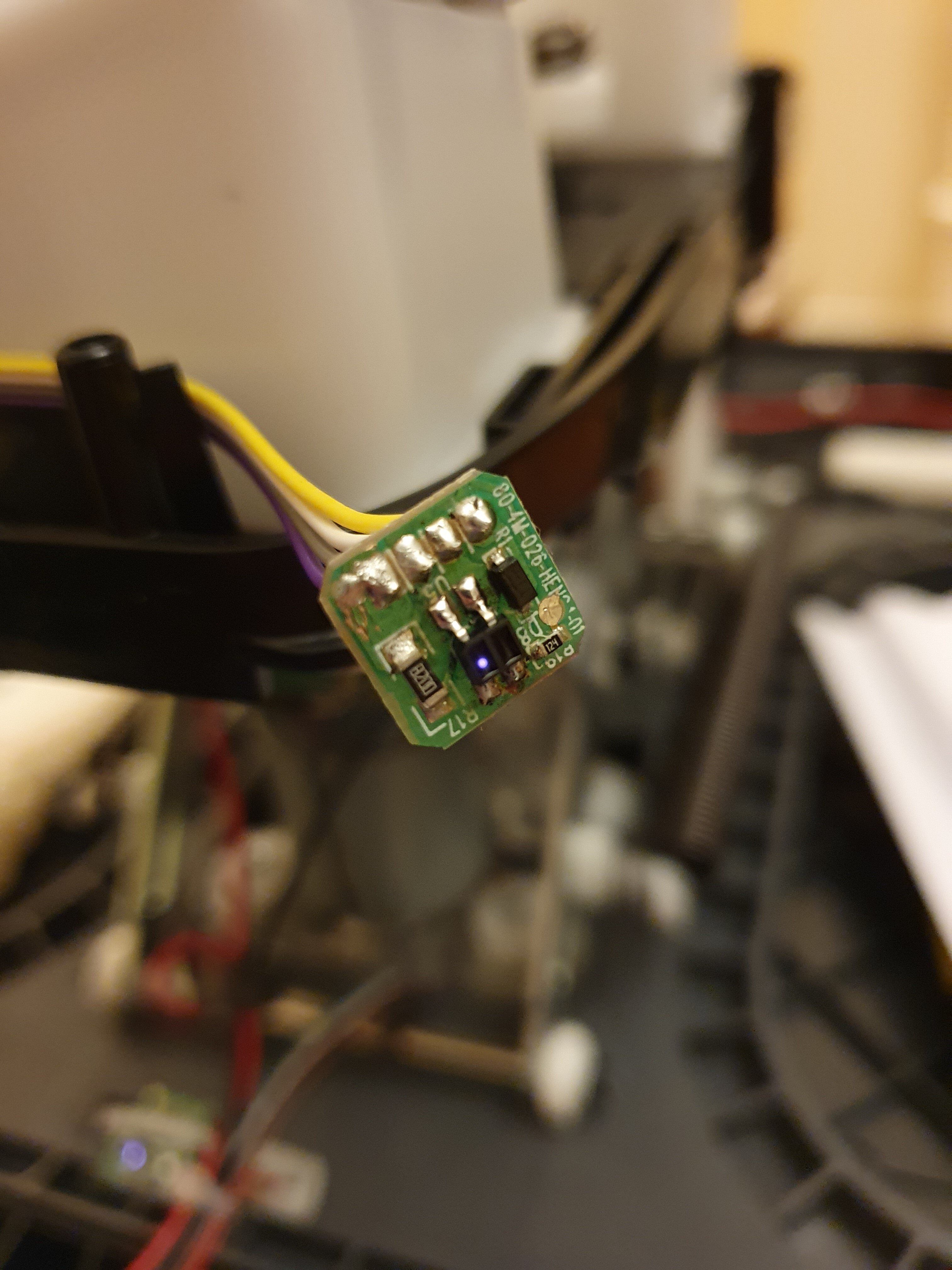

Hi guys,
Just an update on this.
My replacement sensor came this afternoon and I decided to tackle it myself. It was quite daunting and I'm confident my soldering job wasn't great but the replacement sensor is working perfectly.
The IR light is a slightly different colour so I was a bit sceptical that it would work but all is good.
Thanks so much to everyone who helped, great support on this forum.

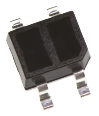

But, before you go ordering you can test if it's this sensor easily by using your phone.
Plug it it, power it on and then open the camera app on your phone. You should see a light coming off that wee sensor if it's working.
There are 3 of these sensors on the cradle, check all 3.
