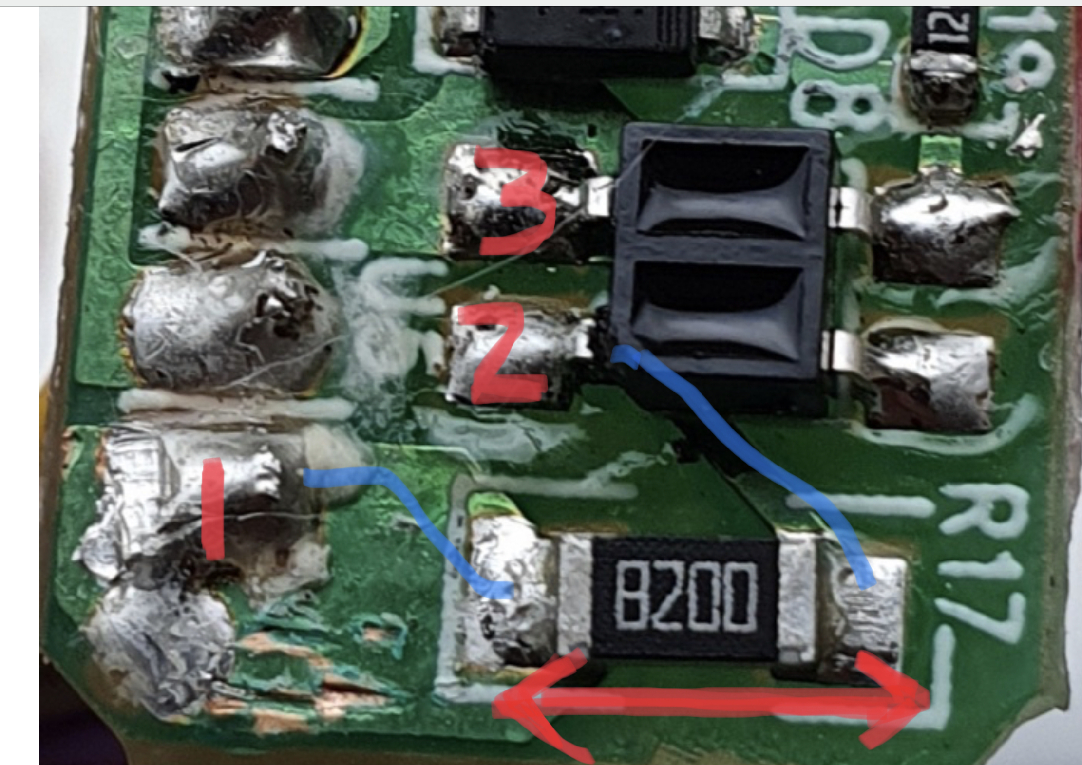

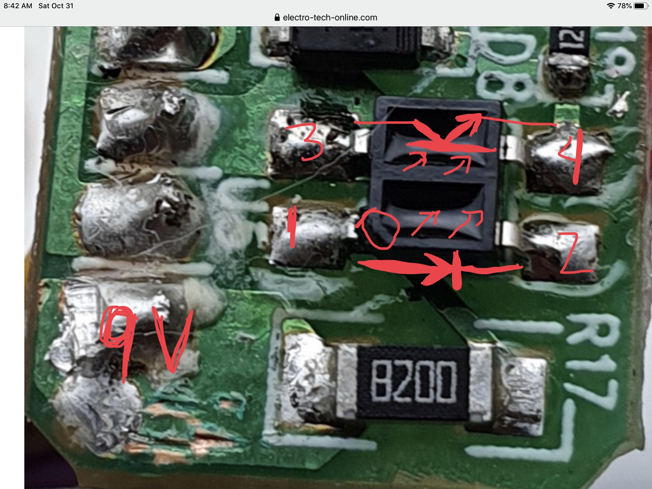

Pinout
if you have a multimeter, measure in ohms by touching solder pads 1 and 2 and hopefully you'll measure 820 ohms. If not, measure 1 to 3 (I cannot be sure where which pad (2 or 3) the copper trace connects below the proximity sensor).
if you get infinite resistance both ways, either the resistor or the solderjoints on the resistor are bad.
also, double check that the solder under pad 1 in my photo is a good solder joint.
So, measuring the resistance between pins 1 & 2 give me 820 ohms so does that mean the resistor is fine?
Anything else to check?
Thanks,
Mac
So, measuring the resistance between pins 1 & 2 give me 820 ohms so does that mean it's fine?
Thanks,
Mac
Yes, the resistor is ok unless something strange is happening with heat causing it to disconnect when it gets warm (unlikely so let's move on).

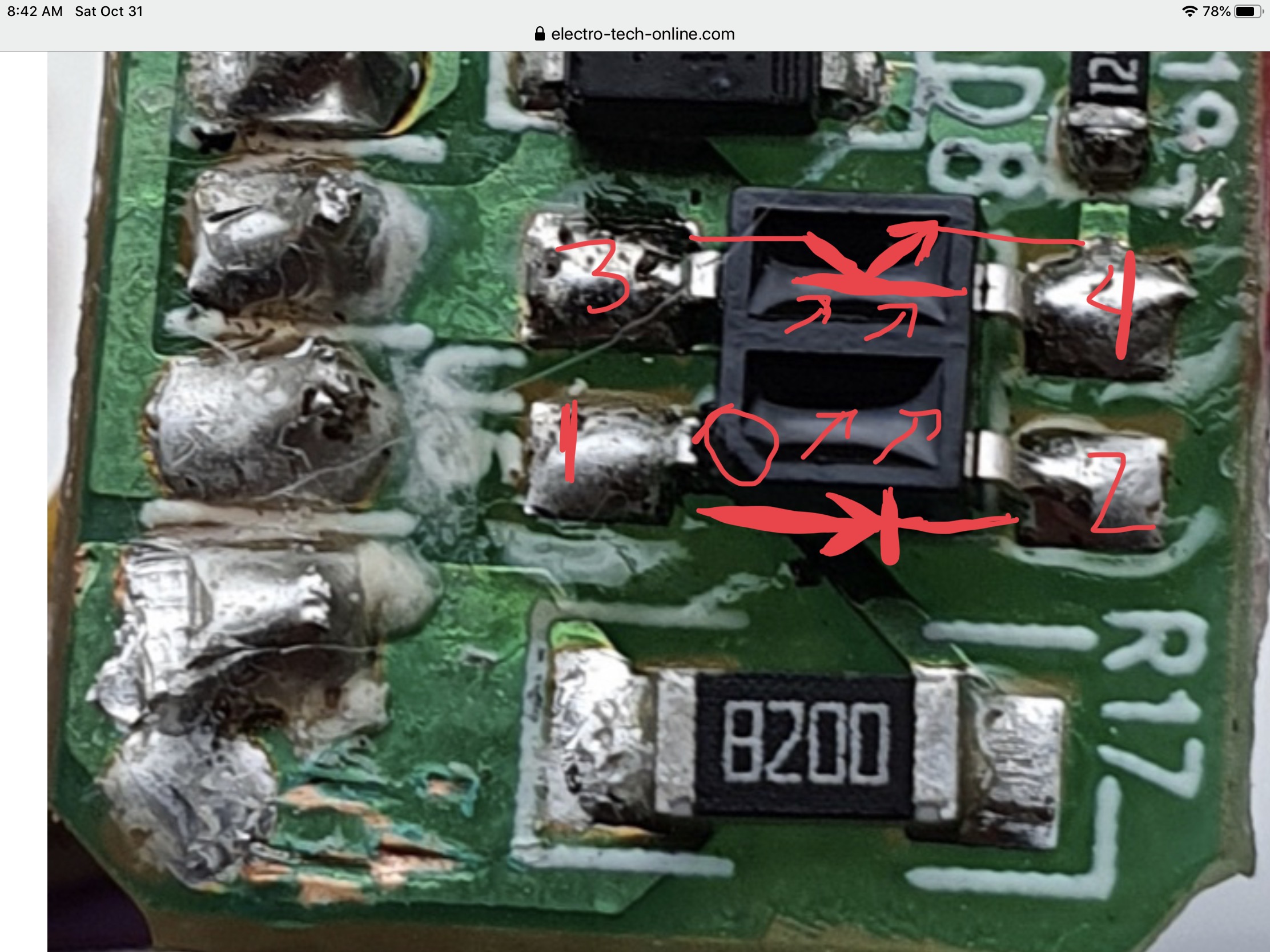

if you have a 9v battery, connect positive to my red 1, and negative (black wire) to the cathode (across the part form red 2. Then measure voltage from red 2 to the cathode and report back. Hopefully it is between 0.8 and 1.8v.
Apply + of 9v where it says 9v, - of 9v to red 2
Then measure voltage from 1 (red test lead) to 2 (black test lead).
Then measure voltage from 1 (red test lead) to 2 (black test lead).View attachment 127748

From pins 1 to 2 the 9v (9.6v to be precise...) carries across fine. If I go from pins 1 to 4 then the output at pin 4 is roughly 3v by time it passes the sensor.
Anything else to try with this approach?

I hope you didn't hold the battery across pins one and two. It should be from the 9v (positive) to pin 2 (negative battery terminal). Then measure with your volt meter the voltage across pin one and pin 2 while the battery is connected. You can damage the IR led if you connect it directly.
Hi there,
No, battery connected as you instructed above, + to where you stated 9v and negative to pin 2.
I then used the multimeter to test from pin 1 to pin 2 which read 9v. I then tested from pin 1 to pin 4 with the multimeter and it read around 3v.

What could make it die, is if the battery is 9V, it's possible to connect a 9V battery briefly backwards.
A diode with a low voltage drop in the main power or even one in series with the emitter portion of the sensor.
You could remove the 820 ohm resistor and use wires to an 820 ohm resistor in series with a diode. We can also resize that resistor to compensate for the voltage drop.
(9-0.6)/10e-3 = 840; 10 mA
So R=(9-2*0.6)/10E-3 <= 780 ohms (normal diode e.g. 1n4001)
Whatever us the closest 5% value; 1/4 W should work
The band on the diode should face the same way as the schematic symbol. Toward (-).
Finally, if you can get someone to help you, we can check the detector side - you'll definitely need one or two extra pairs of hands to do that.
I'm not sure I did the checks correctly after reading this again
I had the battery+ connected to the 9v on your diagram, the battery - to pin 2. I then had the multimeter red to pin 1 and multimeter black to pin 2. For this I was getting 9.6v.
I'm not sure what you suggested for the second part, red 2 to the cathode? I'm not sure which is the cathode pin?
Thanks again,
Mac
Cathode is minus, or the direction the arrow points to. If youbcan think of current flows from (+) to (-) in the direction of the arrow.
It is the band side of the diode.
This would indicate an open circuit.
If you have a multimeter with a "diode test" which will basically read a voltage drop and beep when it's low..
no power
- of multimeter on pin 3
+ of multimeter on pin 4
It should indicate OL or something out of range.
then shine a bright light like an incadesent flashlight the voltage drop indicated would get lower.
no power

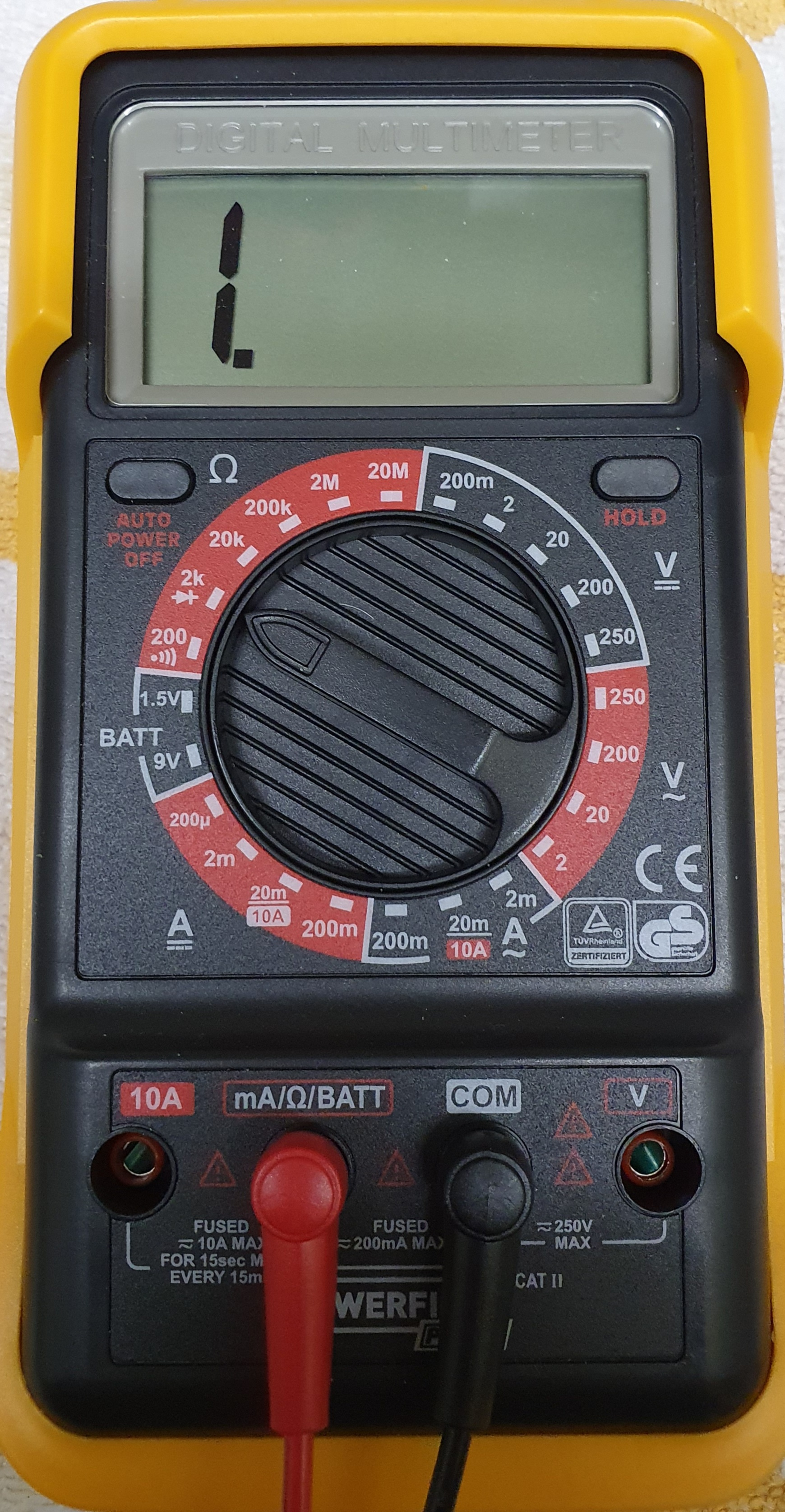

Hi there,
Thanks for the explanation, very useful...
I have set up my wee cheap ass multimeter to what I think is the diode test, image attached?
Anyway, when I switch the multimeter on with this setting it shows 1 on the screen.
When I put the negative lead of the multimeter to pin 3 and then the positive lead to pin 4 it doesn't change, it stays at 1 on the multimeter.
If I reverse the + / - then it shows .682. Sorry, I've no idea what I'm doing here really..
I haven't connected this sensor to any power at this stage, sitting unplugged.
Any help greatly appreciated

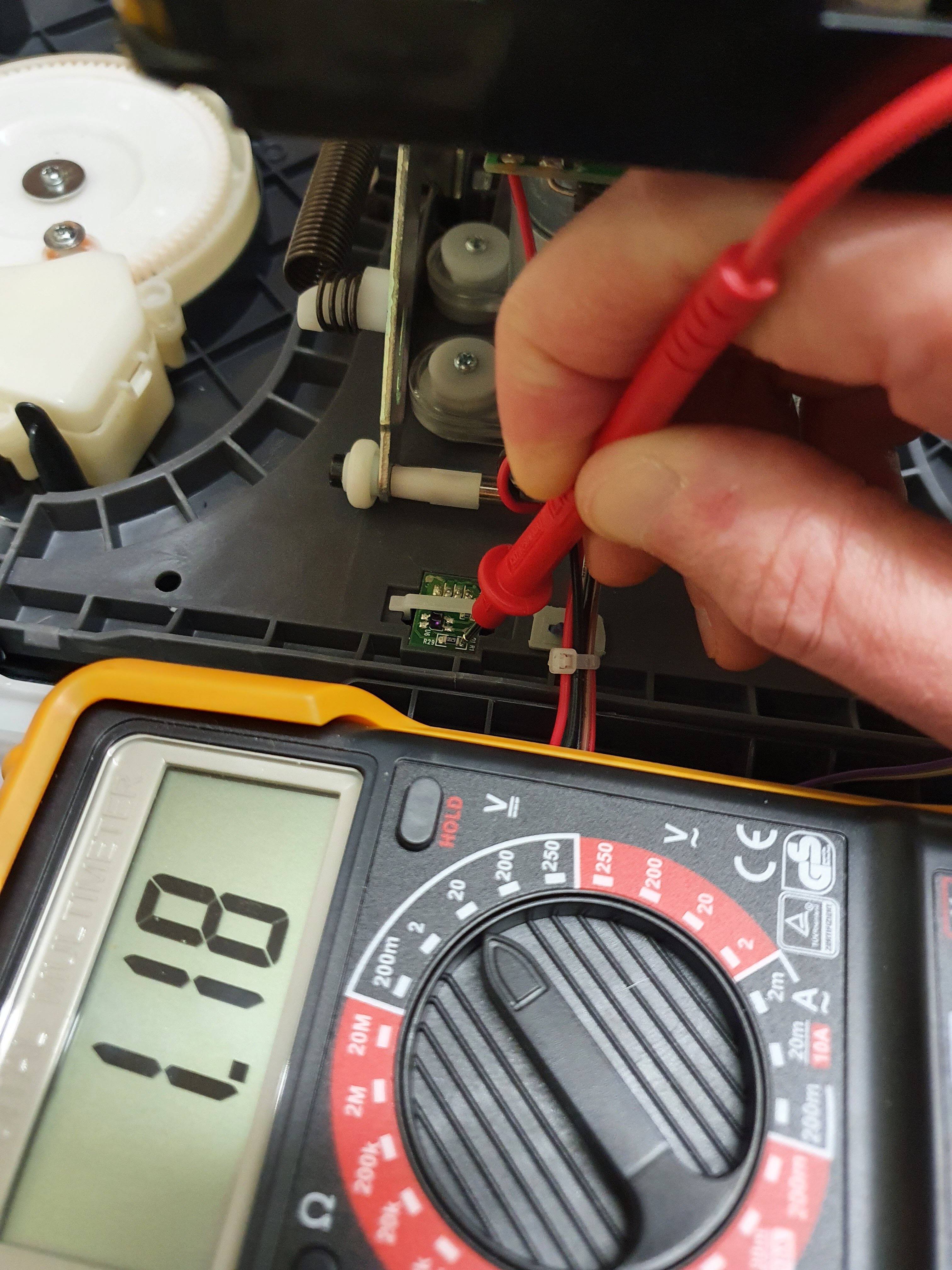

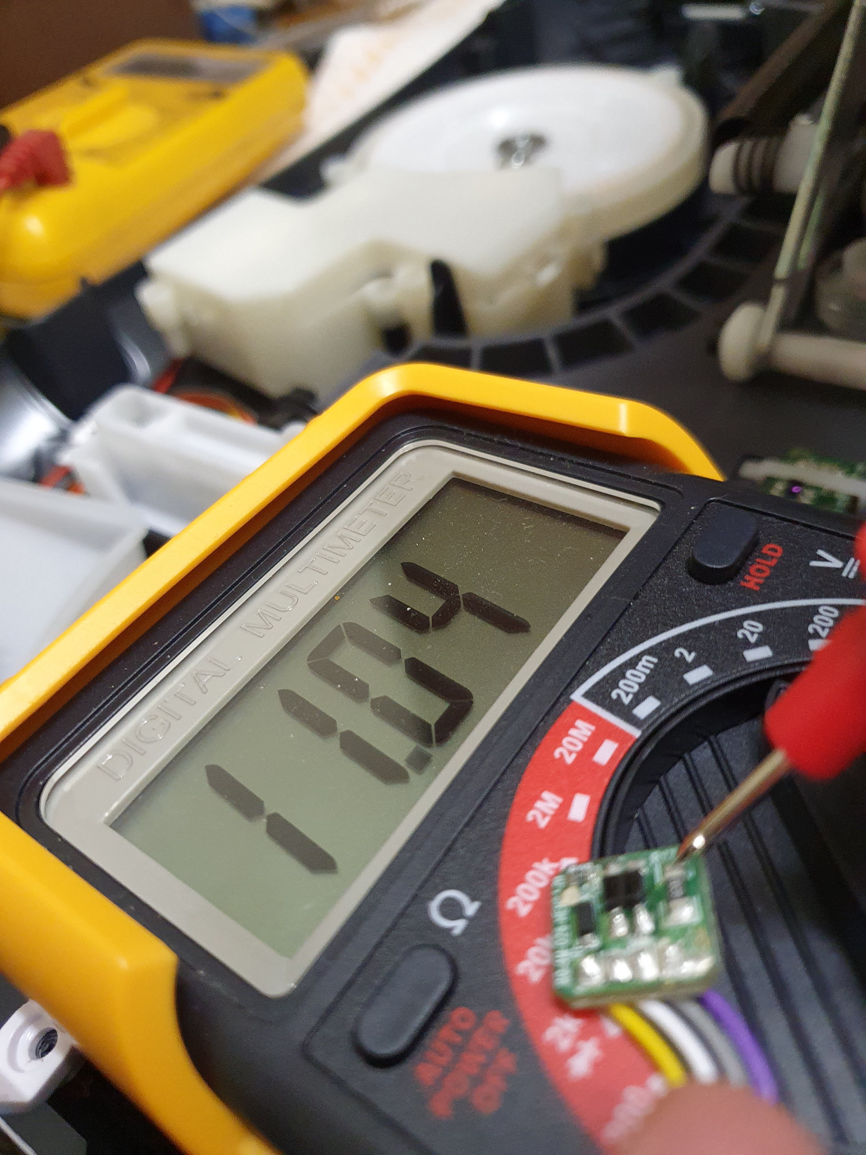

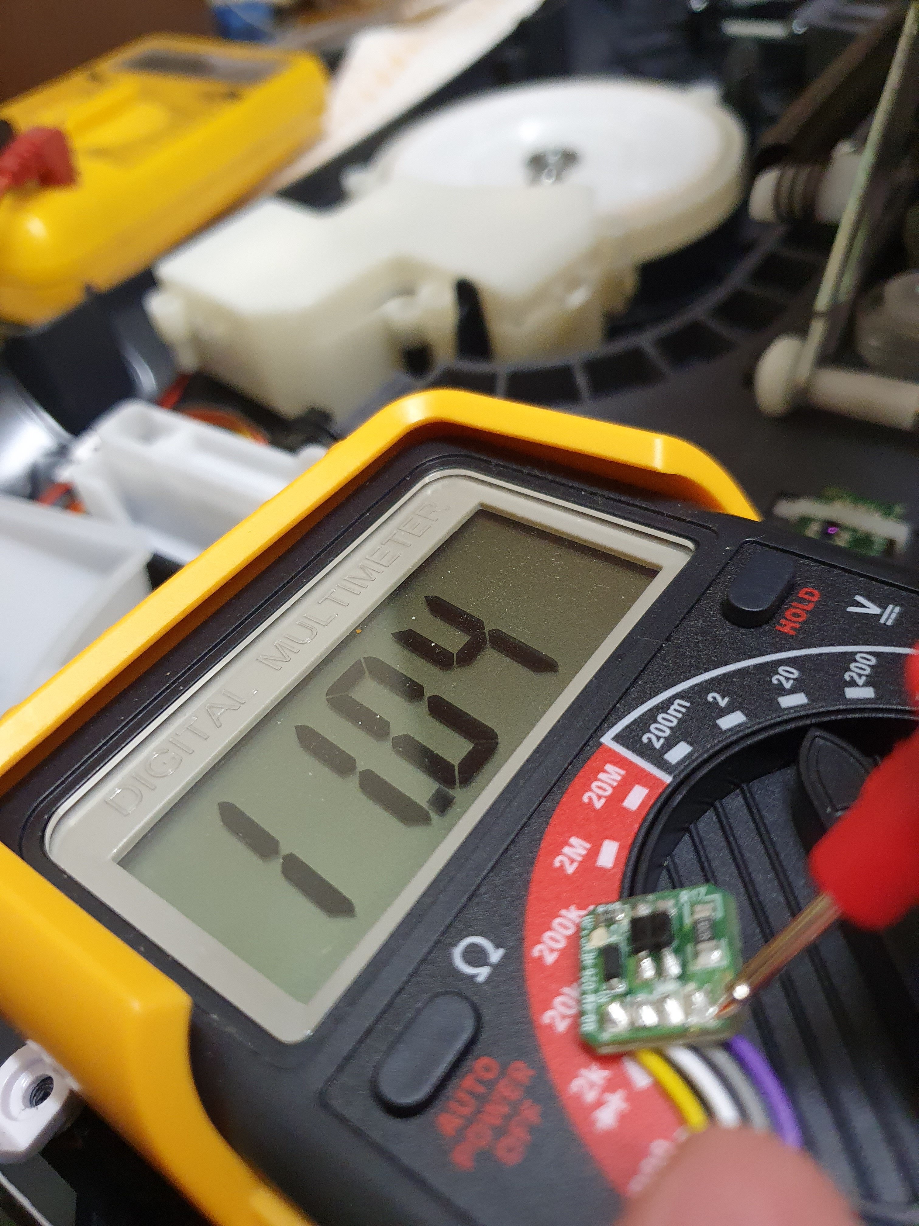

Hi folks,
I decided to measure the voltage over a working sensor and this faulty one to compare the values.
On a working sensor, the input voltage was coming in at 9.52v. When I tested it at the other side of the resistor it was showing as 1.18v.
Now I did the same test for the faulty sensor. The input was 11.04v and at the far side of the resistor it is still 11.04v.
Does that still mean the resistor is faulty and not reducing the voltage?
Perhaps the high voltage got across the resistor and then damaged the IR sensor?
Sorry for the poor photos, I was on my own trying to test this and take the photos...
Cheers,
Mac

No, it means the LED is open and drawing no current. No current draw through a resistor means no voltage drop across the resistor.
