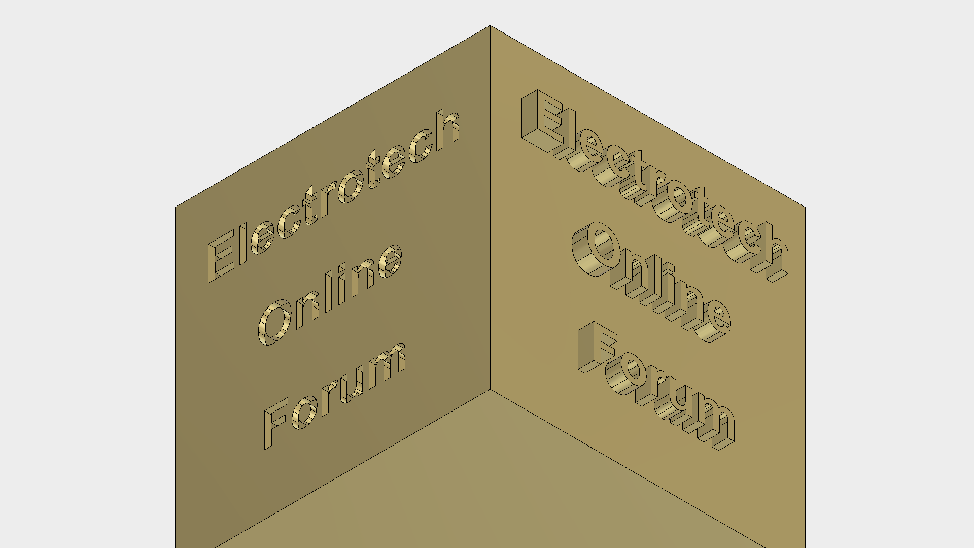

The labels in untitled.png look to be add-ons, but could they be made integral with the main print? Does Autodesk 360 have the ability to include text, either raised or indented?
Yes, they're just ordinary labels stuck on. Modeling raised or indented text in Autodesk is absolutely possible, but sadly I don't have that function in HFSS as far as I know. At some point I may want to learn a proper CAD program, but for the purposes of making quick mock-ups for prototypes it just happens to be something that is familiar and available to me.
Yes they can and it is probably very easy to do, although I have not done it yet.
You would create the text on a plane or face, in a 2D sketch, select all polygons required and then perform an extrude operation.
If the text was created on a face where you wanted the text, you could do a negative extrude and cut directly into that object, or a positive extrude to raise it. If the text was created on a plane, you could do a positive extrude and create a solid object, align it wherever you needed it to be on the other piece, then do a combine operation in which the intersection of the objects is a 'cut' operation. If you just wanted the text left raised, you would do a 'join' instead of 'cut'.
Played around in Fusion 360 for about 30 mins just now, to try the text out.
As described above, it really is that simple - I created a 100 mm cube and selected the right face, then used that surface to create a sketch.
Selected the text tool, inputted the required text, then dragged it into position. Repeated for the other 2 lines.
Performed a positive extrude on the text on that face, 'join' was the default setting, the text raised as expected.
Copied the text geometry from the sketch for the first face, selected the left face and created a new sketch.
Pasted the text geometry, moved it into position, selected it again but extruded in the negative direction.
'Cut' was automatically selected and the text was indented.
Exported the object to Repetier Host and aligned it on the print bed, to sit with the text facing horizontally.
Next step would be to slice the object for printing - the level of detail is dependent upon the print nozzle size and the layer height, as well as the material and machine capability.
Why, when I look at the left face do I see an inside corner but the right side makes me see an outside corner? Anyone else?
A trick of the brain? I had to look for a while to see what you describe, but the geometry is probably what is doing it.
If you look at the E and F especially, the diagonal angles of the lower horizontal parts do not make sense when viewed as you describe, but also barely make sense when viewed as it was modeled. That's probably due to a combination of the shallow depth of the cut and the angle which the render was created.

Had another quick play with the text in Fusion 360, based on JLNY's boxes.
Left side is indented text, 0.5mm below the surface. Right side is raised text, o.5mm above the surface.
Pics like this do not show enough detail, so if you are collaborating with someone on a project, F360 allows you to share.
You can restrict the share link to allow only viewing and measuring/sectioning/mark-up and snapshots, or you can allow the model to be downloaded in a number of different formats, as I have done here: (You can download the Fusion 360 archive)
