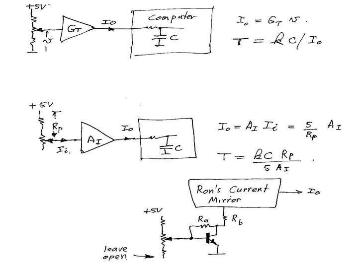

MYSTERY SOLVED. I stupidly assumed that the time in the computer is T = k.C.I where I is the output current from Ron's circuit. But, I belatedly did the maths and it is T = k.C/I so it is no wonder the results are non linear.
So the solution is to use a current amp rather than a trans conductance amp. Then the input current is 5/Rp where Rp = R3 + the pot resistance. R3 is as in Ron's circuit. The current amp could be as drawn or an op amp with current mirror inputs.
The "-5V" connection can be left open since there will be no current through the R4 resistors.
Len, I need to think about that, but don't you still have a min-to-max ratio problem?
No, I don't think so. The range is set by Ai and the centre can be set by a DC off set current. However, Ai needs to be <1, ie. about 0.02, so this may be a problem.
Note that Rp ranges from 2.9k to 12.9k according to my calculkations from Tim's measurenents.
So if Ai = 0.02, then T = k.C 100 Rp
Note that Rp ranges from 2.9k to 12.9k according to my calculations from Tim's measurenents.
So if Ai = 0.02, then T = k.C 10 Rp which is roughly equivalent to the 100 k pot.
So perhaps we need an NPN current mirror in lieu of the amp I drew.

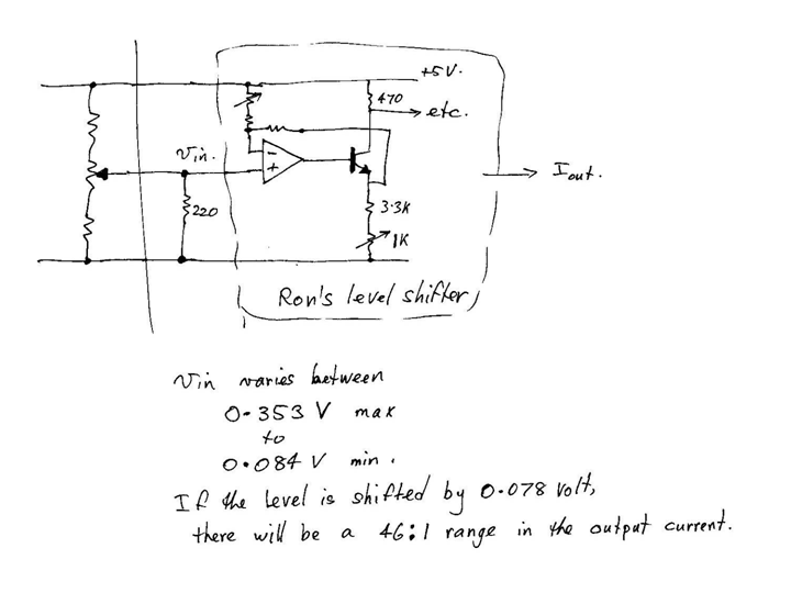

I have tried various options and I think the attached will work.
It combines my idea of making the result linear and Ron's level shifter.
The op amp CA3130 will operate from a single 5V supply and the input voltage can be as low as -0.5V.

Excuse my ignorance, but which of Ron's schematics is the level shifter?
