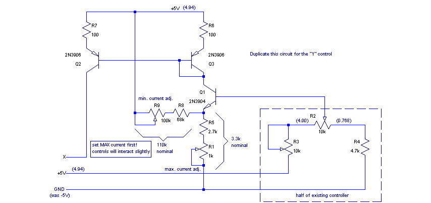

+/-3.5v to 0-100k resistance conversion circuit help please!
I didn't have a 4.7k handy so I used two 10k to get 5k for R5. With that I can get down to 40 or so.
Adding R8 and R9 as you suggest, the max I can get to the right is 460.
Edit: However, even with R8 and R9 disconnected, chaging R5 to 5k brings the max for the far right down to 680. R8 and R9 brings it down even lower.
I have a feeling that even if we get 000 on the far left and 999 on the far right, center is going to be somewhere down around 150 and no amount of adjusting those resistor values will put it near 500 without the left or the right being way off.
Try R5 = 3.3k (or 3 10 ks in parallel) To shift to the left, you need more current into the computer which means less resistance in R1 + R5.

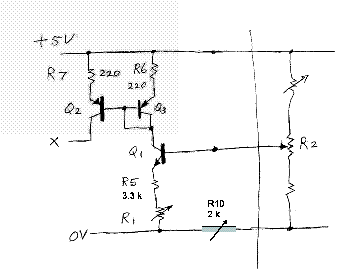

Here is an alternative. The pot (R10) will set the minimum voltage for both circuits.
Set R1 as before and set R10 for 999
With this change and the pot at it's max of 2k, we get 031 on the right, 048 at center and 136 on the far left. So we're going the wrong way.
Yes, I realised that and just came back to delete the circuit. I had my thinking reversed.

Djpubba, have you measured the voltages at the extreme ends of one (or both) of the pots in the original Vectrex controller, with no additional circuitry added? I tried to find them in this thread, but was not sure what I was reading. I think I can come up with something that works if you can post those voltages.
With nothing connected to the controller except +5 and ground,
Input at +5 pin = 4.94v
Output on X pin, stick far left = .768v
Output on X pin, stick centered = 2.538v
Output on X pin, stick far right = 4.00v
Measurements for Len coming next.
A ha, I have been confusing left and right. 999 is far left and minimum voltage - correct? On re-reading the thread, you told me this, but I've had it in mind that 000 was far left.
I tweaked this by assuming the monostable element in the computer is similar to CD4538, where the pulse width=RC. Also, I assumed that the resistance varies about 46:1 (102.2k:2.2k).
The controls may be backward, as you may have discovered. If so, we'll tackle that next. :cry:
The nominal values were fine-tuned by simulating, so the actual values can be somewhat different - hence the pots.
Unfortunately, this design will be sensitive to VCC(+5V) variations with time, temperature, individual computer's actual VCC value, and phase of the moon. We might be able to minimize this if you have room for more parts, like an op amp or two and more resistors.
PS calculated min and max currents are 22ua and 1.022ma, respectively.
