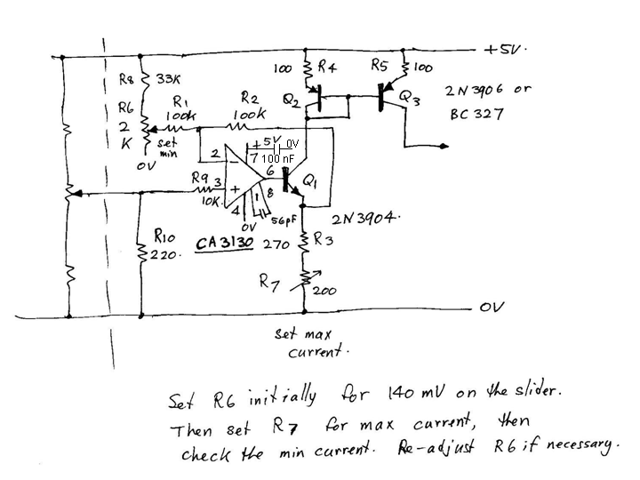

Here it is. It is based on Ron's level shifter and current mirror circuits.

Edit, I have updated the attachment - forgot to include a 100 nF bypass capacitor. After 5 attempts, hopefully it will work this time.

Q2 and Q3 are the same. This part is a copy of one of Ron's earlier posts and what you have already built and tested.
R7 is 200 Ohm, not k ohm! R3 is 270 ohm.

You need an op amp that has a common mode range that includes 0 Volt and operates from 5 Volt.
Does anyone know of an equivalent to the CA3130 op amp?
The frequency response is not critical, just the parameters mentioned above.
In case you cannot find an alternative IC, I will post a circuit later that uses the DC - DC converter ICL7660 (there is also a MAX1044) that will provide -5V from +5V. Thus you can use op amps such as
LF412, TL072 or TL082. These will all operate from +/-5V supplies and will suffice. They are all duals.

Djpubba, if you are pursuing my circuit, I think you're wasting your time. I spent some time today comparing an RC multivibrator with the voltage-controlled current source multivibrator, and I'm convinced that Len is correct. The current is indeed proportional to voltage, but the pulse width is inversely proportional to current, so you wind up with a hyperbolic relationship between voltage and pulse width. Right now, I'm out of ideas.
I've also spent the day checking the calculations of the circuit I posted earlier and considering alternatives.
Although the current should be roughly proportional to the inverse of the pot resistance, the calculated currents do not agree with your measurements. So I don't think this circuit is going to give you the results you want and I don't know why.
I'm sorry, but I can't afford to spend any more time on it.
Current required Current from circuit Screen
30 uA----------------30 uA-----------------999
60 uA----------------304 uA----------------500
???-------------------1.38 mA--------------000
??? means I can't see where you measured this, so I can't recall from where I derived the 1.38 mA, but that's the figure I used for the design.
So try it if you wish, but you may be disappointed.

I realised why the circuit did not work as expected. The fundamental problem is that the pot only has a 5.2:1 range as Ron pointed out.
In order to solve this issue, he suggested using a level shift. But the result was still not "linear" as viewed on the screen.
I then suggested we use a current amp. so the reciprocal of the pot resistance determines the current into the computer. But I also needed to level shift it in order to increase the range. So it is the level shifting that is modifying the reciprocal function so it is no longer a proper reciprocal.
I expect that a digital solution would work, but you would need a digital pot that has a resistance of 100k.
