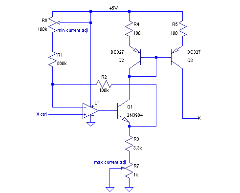

Here is a spreadsheet that does the calculations for Ron's latest circuit.
Change cells E3 and F3 to give the effect of changing the pots.
Yup. Those currents are pretty close to what I get when I measure it. But it doesn't give the desired results. With Ron's circuit, the range that seems to produce the desired results is:

That's what I was thinking. Try this while and let us know the results.
Look at Ron's original circuit. Remove Q2, Q3, R6 & R7 and connect the LED between +5V and the collector of Q1.
Make R5 = 390 Ohm and R1 2 k.

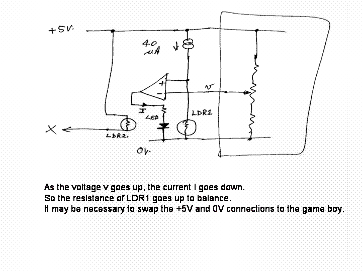

Here it the basic idea.
You can buy a part with two LDRs and an LED in one package. Both LDRs are illuminated by the same LED, so they track pretty well. I used a similar concept years ago (1972?) to make a video gain control that didn't require running the video to a front-panel pot.

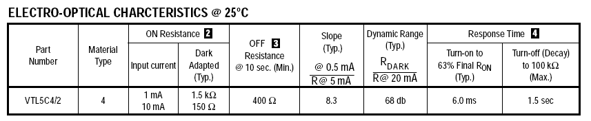

We may have to forget LDRs. Here are excerpts from a couple of spec sheets. Note the response times, especially turn-off times. A feedback loop can deal with turn-on, but turn-off is basically open-loop, I believe.
Do you reckon that'll have the range I'm after?

150ms seems too long for the response time. If you can get it to work, more power to you.

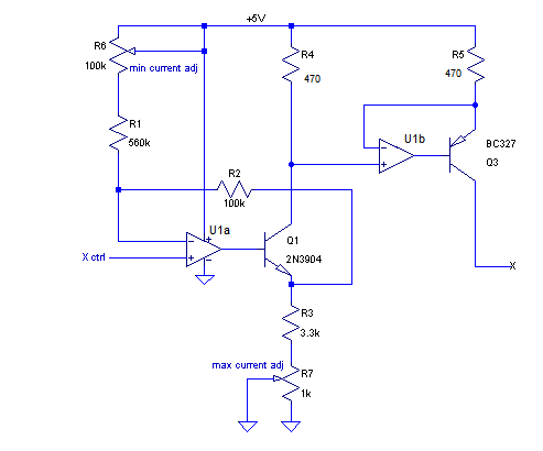

Below is, I think, my last gasp. It is adjustable for the 46-1 range required, and should reach the min and max current needs. Its output is also a linear function of the input pot position.
EDIT:
I changed the schematic. I had specified an LM358, but it won't work here. You should probably just use a rail-to-rail I/O op amp. I can suggest one if you can't find one.
Do you reckon that'll have the range I'm after? Ron's point re the LDR delay and the open loop issue is relevant. So it may not work very well. I had not looked at a LDR spec, so missed this point.
Ron's looks good but, as far as I can see (some would say - not far), it has a linear transfer function, so the non linearity in the computer will affect the results as before. However, it may be possible to introduce some non linearity to compensate.

I did this with a circuit I designed for a bloke in the UK. He wanted a LED display to alter its brightness with the ambient light. So it is dim in the dark, medium in medium light and bright in bright light. So I used an LDR to detect the light level and thus adjust the LED current. All I needed to off set the non linearity was 2 resistors and a diode.
I assume that the reason why the computer appears to be linear with the 100 k pot but non linear with Ron's current source is because the software is compensating for the expontential RC charging waveform. Yes, Ron, I know that T = k RC and a constant current should not matter, but there has to be a reason for the non linearity.

If you build the level-shifting circuit, buy a dual op amp and do it this way.
