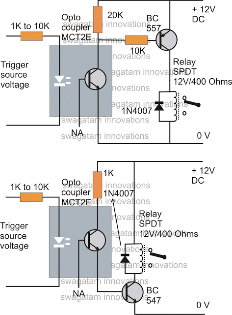

Your pulses are 2.2V, most opto couplers input LED turn on between 1 - 2 V, so thats not
an issue. Just limit the input current to datasheet spec allowed. Use a R to do this. Its output
current capability to feed the relay coil you need. And off state voltage on the transistor it
can tolerate.
Something like this -
Just go to digikey and use filters to get needed relay current thru output of coupler
and say 2X the 12V in system for output transistor breakdown margin. Transistor output.
100 mA for coil current, although there are many relays << 100 mA to turn on......
