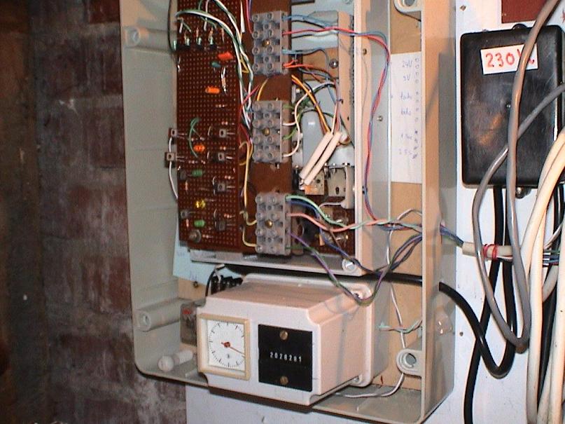

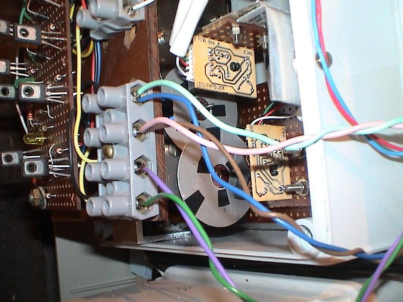

I always believe in the KISS principle ( Keep It Simple Stupid )
If you can avoid complicated programming with exotic IC's or dodgy software go the other way.
Use some discrete logic or electromechanical means, which is part of a clock building hobby anyway go that route.
I make some pics of the tacho I built from old Landis & Gyr clock parts and a transisitor push pull driver.
My system has been working for 2 years continuously now, with no faillures.
Also during a power cut the seconds will get synchronised back in step.

Hello Ray
I like your thoughts !!! would like to see anything you have to show that would help.
Regards
Raymond
Interesting clock you got there. Hope the price was ok.
Attached are 2 pics from the tachodrive i build,
Unfortunately you can't see the gears, because the driverboard is mounted on top of it.
Basically it is a synchronous motor which drives a geartrain and generates 60 impulses via one of the the discs in 58.6 seconds.
Then it stops to be released via a 24 volts relay from the master clock via a change over switch.
The opto's are from a ferraris induction meter which have IR leds at a 45° angle and scan the black marks.
These drive the push pull driver and give me ± 2 Ampères at 24 volts to drive the slave clocks.
The other disc drives a slave clock at a 2.5 seconds interval which has a so called "Suchzeiger" searchdial. It's ex Bundesbahn, German Railways.
In the drive i changed a gear ratio from 50 / 50 to 44 / 45, which is easy to accomplish with old L&G meter parts which are made like little Meccano gears.
If you work along a similar principle where a synch motor drives a geartrain or marked wheel and generate 30 impulses in just under 30 seconds. Your masterclock will keep the tacho in step.
Regards
Raymond
