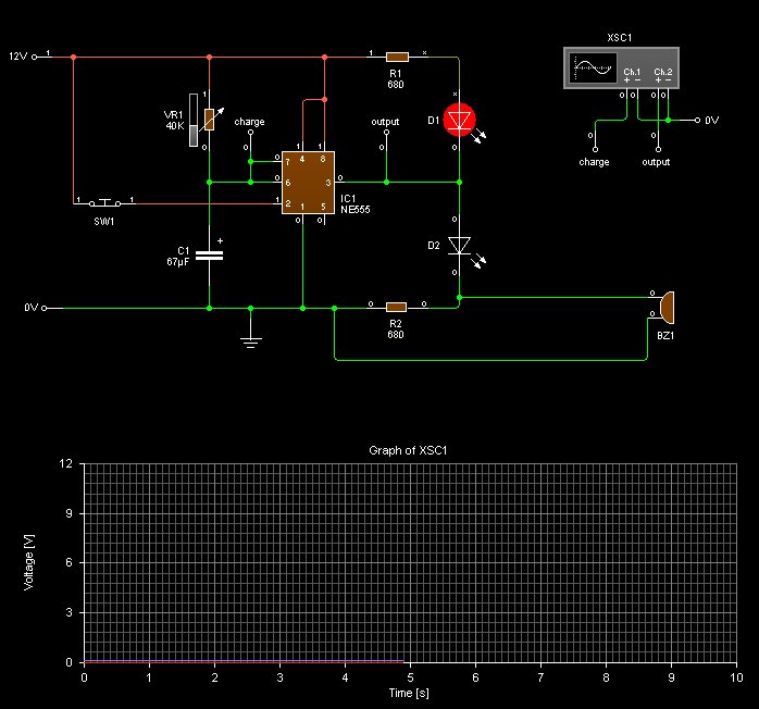

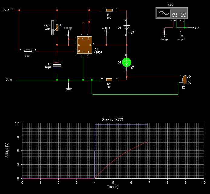

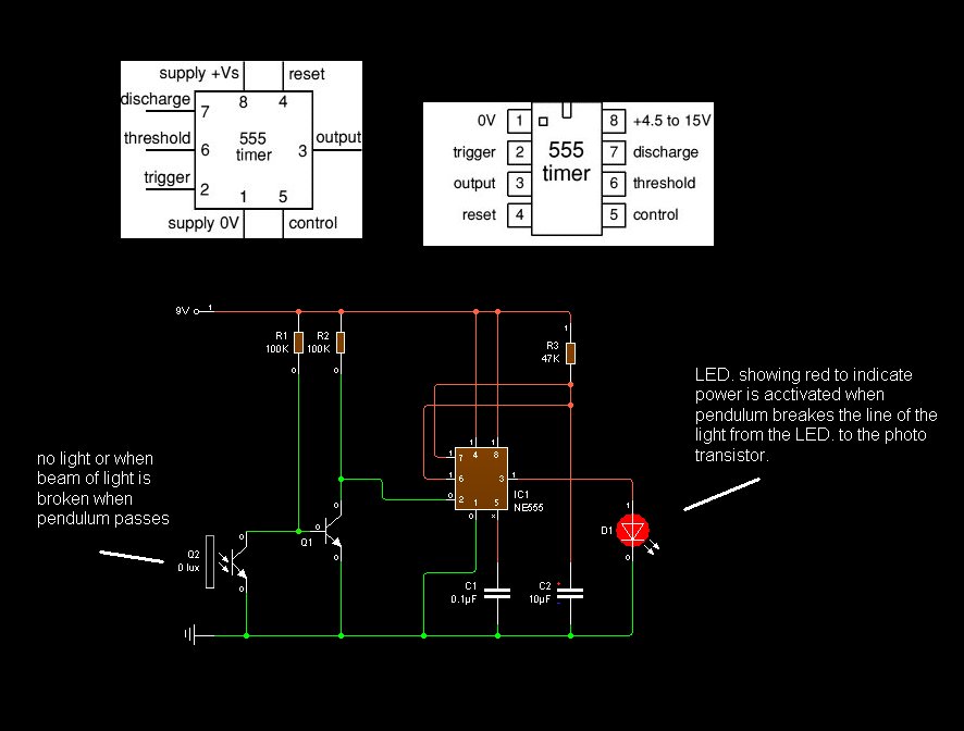

Hello all
I have been playing around with a 555 circuit.I Was hoping to be able to put the photo transistor trigger to input pin two of the 555 but I can't get it to work,Can someone please point me in the right direction Please???
To show how the circuit runs I have added a switch to activate the sequence.Like Torban says I can calculate the resistors and capacitors to give differant timing to suit my needs.In this circuit I have added Led's to show the state of the pulse red for off and green for on.
Oh!! I added a buzzer where the circuit for the 1sec alternating polarity clock
would go.
Two pics one in the off state( red) and one on (green)
All I need now is to fit in the photo transistor circuit,with your help.
Please advise how to better the circuit.
Kind regards mark

markelectro said:
Torban N all
Still tinkering with 555 timers!!!
Torban can't get a photo transistor circuit to trigger the 555.I will keep playing around in Livewire.
Mark

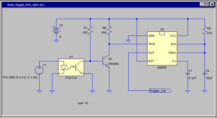

Mark,
I found my schematic but it's a mess so I just did up a new one during lunch. Try the one attached below, but replace U1 with your laser and phototransistor--I just used the PC817A because it's essentially the same thing I couldn't find a spice model for the laser/phototransistor. This one will output a 0.517 second pulse every time the beam is broken, so if the beam break detector is across the very bottom of the pendulum swing you should get a half-second pulse once per second. I hope. ;)
Q1 can be a garden-variety switching transistor like 2n3904, 2n2222, etc.
Hope this helps,
Torben

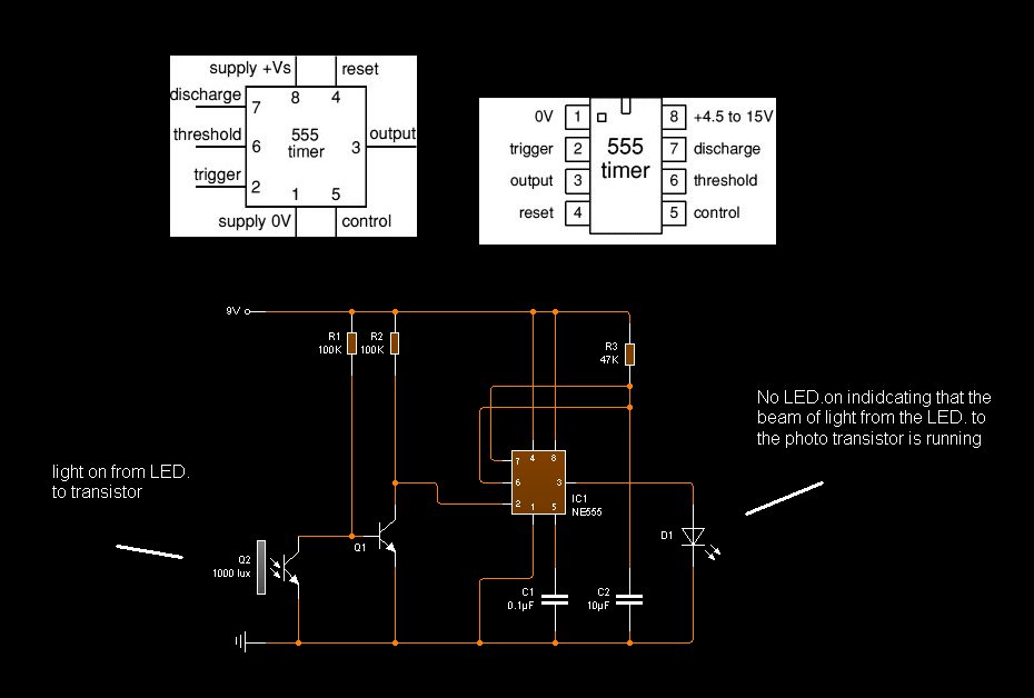

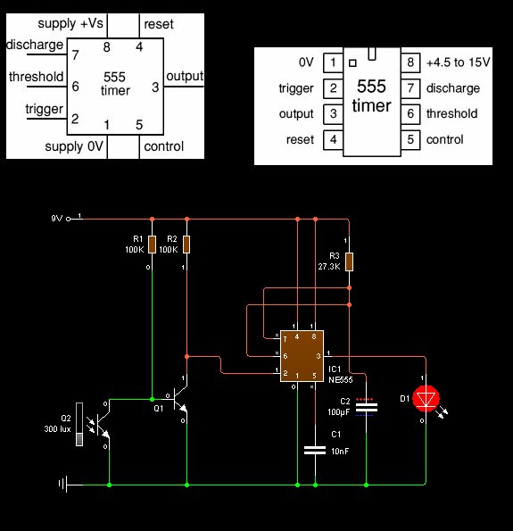

please help with 555 timing
Torban N all
I think I copied the Schema right??? but it does not seem to be working correctly. :-(
I added the Photo transistor to the circuit. When the transistor is receiving the light from the LED. the circuit seems to be OK. When the light is broken as if the pendulum passes between the LED. and the transistor the power is activated as expected as shown in the Led. on the far right (I put this is to show the power is going through) BUT!! it seems that we have no timing sequence from the 555 ???? it just runs until the led activates the transistor again.
I am now at a loss with this, can anyone help????
please see images.
Regards Mark

Torben said:
Mark,
Hope this helps,
Torben
Torben I'm sorted.
I had to fiddle with the capacitors and resis tors to get it to work as I could not with your schema.
I put another thread in for help and I got this 555 calc prog.It gave me just what I wanted to get your circuit running.
If you take a look at the image you will see that the photo transistor is recieveing light but the Led. on far right is still lit this is because I now have a time on period of 3 sec.
I will now be able to adjust to suit my need.
Many thanks for your help on this.
Regards mark

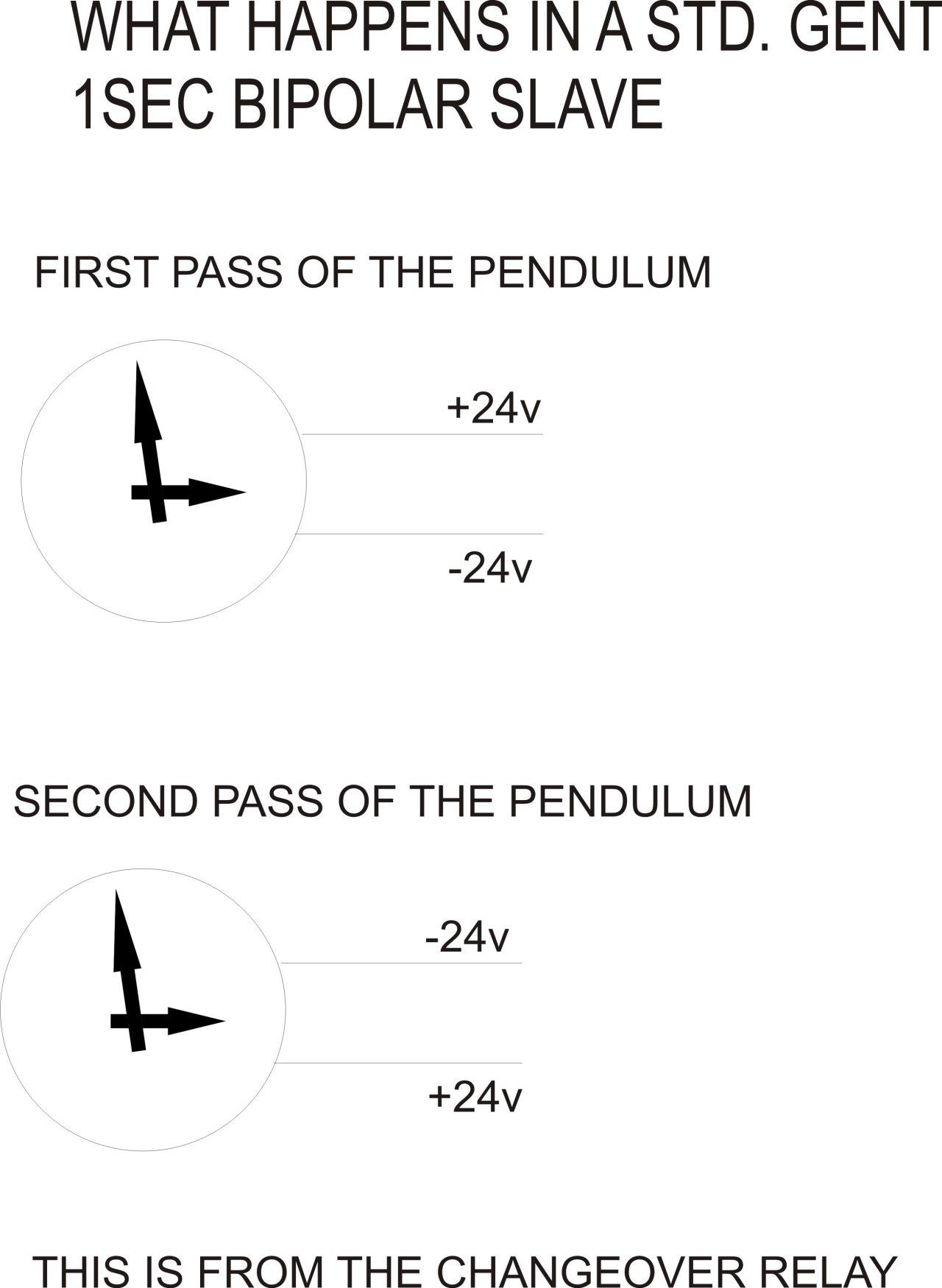

Having now read through the various threads and links, I think I may have misinterpreted what you require.
As I understand it, your clock is powered from 12V DC and outputs a 12V pulse every 30 seconds. Your slave clock requires a 24V AC signal every second.
I assumed that the slave required 24V DC for 0.5 seconds and the reverse voltage for the other 0.5 seconds.
I now think that it requires 24V @ 50Hz for 0.5 seconds and no voltage for the remaining 0.5 seconds.
Either way, the hardware will still work but the software will require some modification.

The clock is 12v supply but has fitted a rheostat to bring down the voltage to what ever will run the clock, more slaves more voltage!!
With my 24v 3000:eek:hm: AC. slave a changeover relay and 24v supply is usually fitted between the clock and the AC. slave. The relay to change the voltage from DC. to AC. The Slave requires an impulse length of approx 0.7
The two wires coming out of the slave will have -

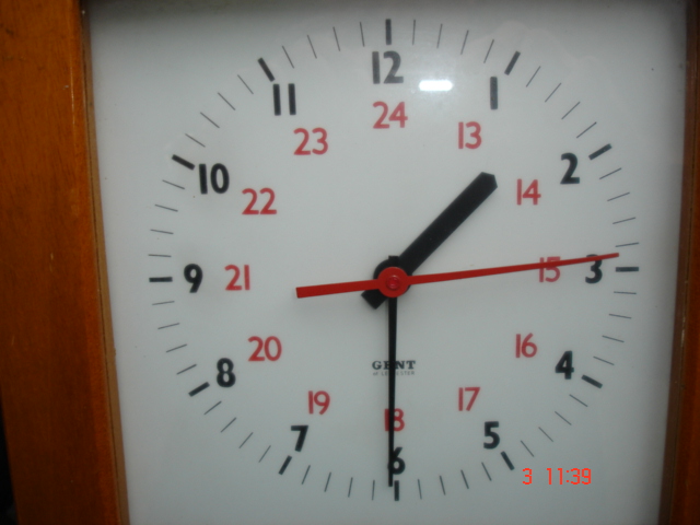

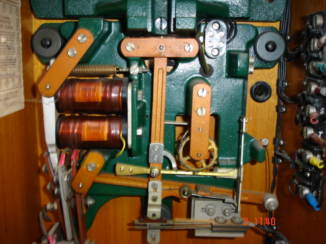

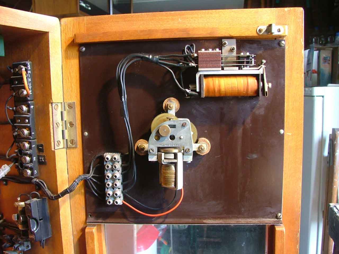

Mike

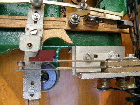

Been reading through some literature on the slave and at the moment I'm a little confused but I will try and explain the opperation of the clock as STD. and then in our project:eek:
In a normal working scenario the slave would be powered from a seconds contact set that is positioned in the middle of the pendulums swing (see image) Every time the pendulum passes centre it makes a contact. Each contact is sent to either a relay box or to a relay like in the other image to the back of the dial. The changeover relay will convert the DC. into AC. so the power is reversing on each pass of the contact set. From the relay the power is then sent to the slave (see image) this slave receives the 24v AC. current 1 x every second as the pendulum passes centre 1 x every second. the actual impulse length to this slave wants to be approx 0.7 sec long, any more is wasted so not too important.
Pass one of the pendulum (1st second) see image
see bipolar slave jpg.
Pass 2 of the pendulum (Next second) see image
That is what the slave requires and how it is powered in the normal Gent system.(above)
My project was to do all that but using pic's
In our PIC. project we have no contact set in the clock or changeover relay.
The PIC. and the circuit is required to do all that.
On a 30 sec pulse from the clock going to the PIC. it will short out the processor causing a restart. The circuit would then generate 30 pulses (seconds) for the bipolar 24v 3000:eek:hm: slave. On the next 30 sec pulse it would reset and do it again.
I want the pic to be controlled from the Master clocks 30 pulse so it is all still governed by the pendulum, so stop the pendulum and the PIC does not run The cycle.
That's blown my brain now and I hope it's all right.
If you have any qestions please ask.
regards Mark
Mark,
I understand the contact and the changeover relay. The SN754410 does the same job as the changeover relay. What I am unsure of is your description of the voltages. From your description, the mechanism that would normally drive the slave would be powered from 48V DC and the changeover relay would convert it to ±24V - you need 48V in order to get -24 & +24 at the same time. I hope this is wrong and the mechanism is powered from 24V DC and what is actually output is 0V and +24V.
What I had assumed in the circuit diagram is that the 24V AC was the peak to peak voltage and could be derived from the 12V DC of the master. This appears to be wrong and means that the SN754410 will require a 24V supply instead of the 12V. It may be that the slave will work happily on 12V anyway - they probably allowed for long cable runs and consequent voltage drop.
One thing that would be useful would be a wiring diagram of a master/slave combination. Is there one any where on the web that you know of?
I'm also slightly confused about the timing.

Pommie said:
Mark,
I understand the contact and the changeover relay. The SN754410 does the same job as the changeover relay. What I am unsure of is your description of the voltages. From your description, the mechanism that would normally drive the slave would be powered from 48V DC and the changeover relay would convert it to ±24V - you need 48V in order to get -24 & +24 at the same time. I hope this is wrong and the mechanism is powered from 24V DC and what is actually output is 0V and +24V..
Mike
Yes it is wrong and yes you are right the input to the bipolar slave is 24v but alternating on each wire from 0v and +24v and then +24 and 0v
sorry mike if my description is confusing,this is due to my level of electronicd experiance.:eek:
