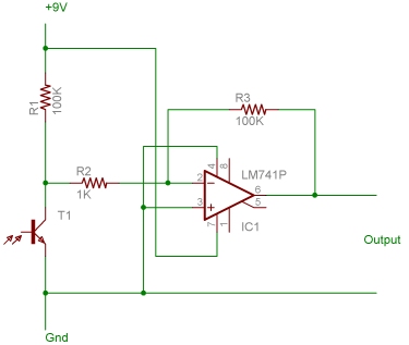

My goal is to impulse a 1 sec AC. slave like a modified quartz movement from the 30 sec countwheel.The count wheel will move in 1 sec increments and normally impulses 2 x in 1 min but I require 1 sec pulses.As stated I want this to work from the count wheel so I do like the sound of your solution.
Pic's are somwhat esier if you know how to pograme them,unfortunatly I don't.
If you can provide details of the schematic I would be very pleased to try this out.
Regards Mark
This is a starting point. The opamp outputs should switch when you place an LED in front of the phototransistor T1. Once that works you should be able to put T1 on one side of the gear and an LED on the other. You may have to fudge with it to get it to work when the gear is rotated. Perhaps a mask in front of T1 the size of the hole between the teeth to block out stray light.
Radio Shack should have all the parts.
I am not an analog person. There are others who will correct this if I got it wrong.

3V0 thankyou
It sounds a good solution.I will certainly give it a go and see what comes of it.
Please give me time to experiment and I will let you know how it goes.
If you think of any other ways please let me know.
Regards mark
