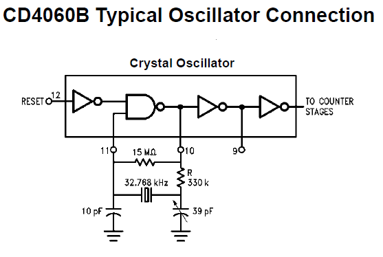

How's about this - would it work?
1 x 32.768 kHz crystal
2 x CMOS 4040
I use the 2 CMOS's to divide by 256 and then by 128 to convert the 32,768 Hz signal into a 1 Hz signal.
Would this work and how accurate might it be?
Without knowing what a 4040 is (and without looking it up) if you properly divide by those two numbers it should be as accurate as the crystal. Thats the general way to get a 1Hz frequency. Use a 32768 and divide it down.
As mentioned before, you can also use a 0 crossing from mains power and divide that down.
2 x CMOS 4040
You'd need an oscillator for the crystal. Use the 4060 for the first stage as it has a built in oscillator.
You've got the right idea. It would be as accurate as the crystal specifications once you've tuned it. 32,768 Hz crystals are used all the time in battery powered clocks.

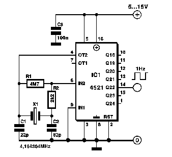

hi Al,
Are you thinking of the HEF4521 24 stage divider with built osc driver, using a 32768HZ xtal, gating for 60secs.?:)
hi on1aag:
I must be slowing down, you beat me this time.!

hi Al,
Hi Eric,
I think so, it's been so long now since i looked at these circuits.
For one reference i used a crystal osc in DIP package connected
to a divider (large divide ability) and so i didnt have to play with
the oscillator section at all. Two chips basically.

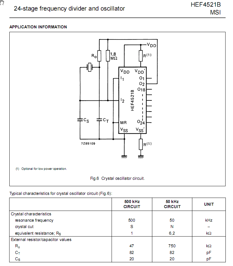

Morning Al,
A little memory jogger for the HEF4521 osc stage.:)
