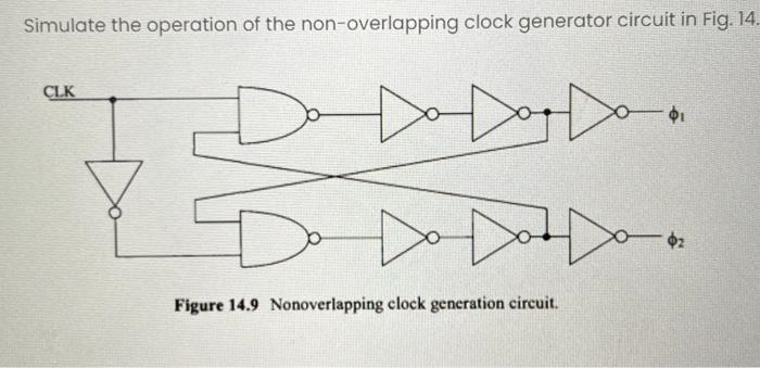

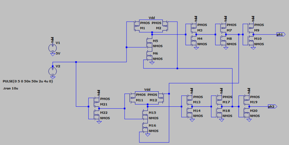

Can someone help me, if this CMOS circuit (attached) implementation is correct? for a Non-overlapping Two-Phase Clock Generator
Below is the schematic diagram of the CMOS logic ckt.

Inverters are normally buffered, so there are in effect three stages. What you have shown in the circuit diagram with MOSFETs would be unbuffered inverters.
https://www.ti.com/lit/ds/symlink/sn74hc04.pdf
https://www.ti.com/lit/ds/symlink/sn74hcu04.pdf
If you compare those, the diagrams shows one as being bufferend and on not.
The unbuffered one is marginally faster, but that is with quite a big capacitive load of 50 pF. With a smaller load, the unbuffered one would be distinctly faster than the buffered one.
The circuit that you have shown relies on the propagation delay to give the timing gap between the phases. The gap* will be around three gate delays, or 30 ns. I don't know if that is enough for your application, as there is usually a reason for a non-overlapping clock, which might need more time.
As the gate delay depends on temperature and supply voltage, you will find the phase gap varying and it could become insufficient.

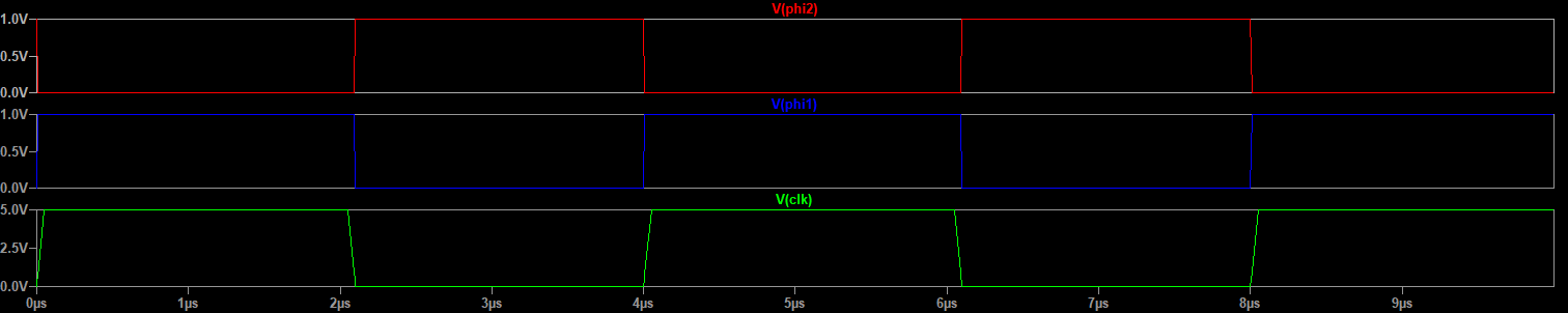

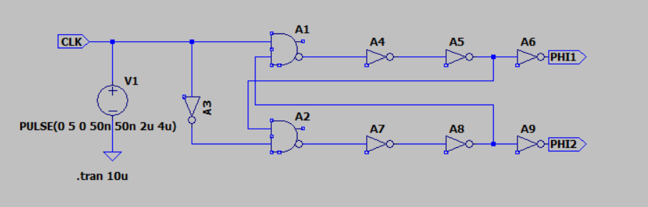

This is my logic ckt and the waveform I'm getting
Looks like there's a small amount of non-overlap, but you'd have to zoom in on the transition points to see how much.
What non-overlay time are you looking for?

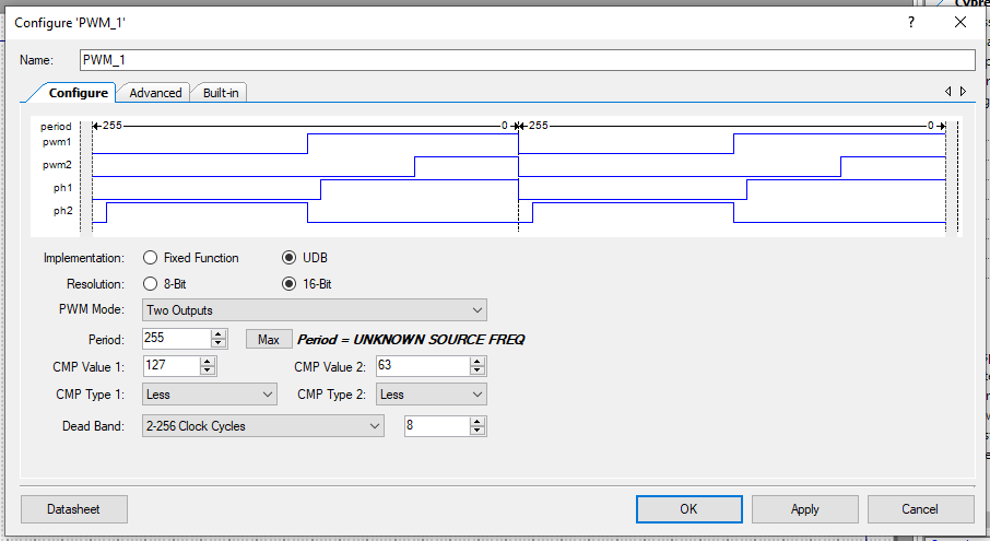

If you are working with modern processrs most have configurable PWMs with dead band
control :
ph1 and ph2 have non overlapping, set to 8 clocks of dead band.
Regards, Dana.

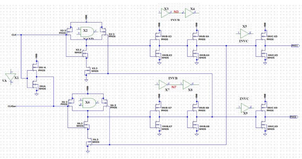

Thanks for all your input, I truly appreciate it. This is just one of our lab experiments, and we needed to do pre-simulation (schematic layout) and post-simulation (cell layout). I'm just seeking some help from the experts to determine if the implemented CMOS circuit provided is correct based on the schematic of the logic circuit.
