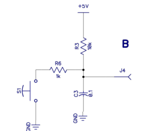

I got a AD5220 digital poti and data sheet says, I only need so switch a push button to change the resistance. Off course also need to select up / down and pull CS low to enable. And get a pull up resistor happening (which is not in the manual, but you need it). But as soon as I pull the CLK input low, it just goes all the way, not just 1 step. I then tried all sorts of debouncing circuits, no joy. Nothing to see on the oscilloscope either, CLK goes from 5 to 0 V without any other noise, so no bounce there. Then hooked up a square wave generator, set to 1 HZ, first pulse and resistance went from 50% to 0.

Do you have a debounce circuit on the CLK signal, that produces a clean, fast edge?
For any kind of switch, I'd suggest an R-C filter into a schmitt gate, or a changeover switch to an S-R bistable, to give clean single clock edges each time the switch is operated.
A normal switch can give multiple contact bounces, or a slow signal to a non schmitt input can allow the input to oscillate.

I did debounce, see post 5. Tried all sorts of resistors. And used square wave generator as well, same outcome. May well try a 2ns chip, I bought 3. And meanwhile ordered X9C103S board online, should arrive soon. Entire board cost as much as one AD5220, and seemed to work with 1 Hz frequency at youtube

As I said in post #4, that circuit doesn't debounce - unless you're feeding it through a schmitt trigger, and even then that is a VERY poor debouncing circuit.
The digikey link in post #10 is a good reference - I use similar to figure 3 from that page (but mostly don't use the diode). I did a fair amount of research, and tried the circuit you posted above, even with a schmitt trigger it was too poor to work. The version with two resistors (as figure 3) cured all the problems - originally I used an external schmitt trigger, and later moved to use a PIC which has the option of setting all I/O pins to be schmitt inputs. If you set the I/O to be a normal input, there's no debouncing then either.
But if you've used a square wave generator, that should work fine - I'm presuming you weren't using a relay between generator and chip? - which I did deliberately for testing purposes, and for evaluating if I needed a diode or not (you can run faster pulses with the diode). Using a squarewave generator and a relay allowed much easier testing, and display of the actual 'bounce' on the contacts - and one of the major applications would be fed from a relay.
A quick way to eval your debounce circuits use your DSO, set for single trigger/single shot
mode, timebase ~ 5 mS / box, and see what you get. A cmos gate w/o hysteresis, as inpost
5, eg. the input, can sit long enough (with a cap tied to input) at threshold that with
power supply noise can cause gate to oscillate. Look at your power supply rail with DSO,
set to infinite persistence, say 1 mS / box, AC, 100 mV vertical sensitivity, and see how much
pk-pk noise you have. Its usually an eye opener.
