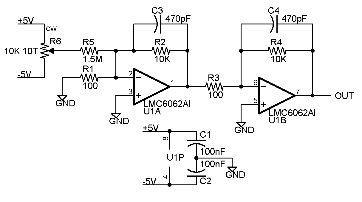

My approach to this problem would be to generate the noise using an opamp-- one with the crappiest noise performance you can find, including a high 1/f noise corner frequency. Three that could do the job are the TLC271 (http://www.ti.com/lit/ds/symlink/tlc271b.pdf) operated in low-bias mode, the LT1803 (http://cds.linear.com/docs/en/datasheet/180345f.pdf) and the OPA349 (http://www.ti.com/lit/ds/symlink/opa2349.pdf).
Configure the opamp as a DC amplifier (inverting or non-inverting, doesn't matter) with grounded input and gain of around 100 to 1000, add some means of nulling out the opamp's input offset voltage (the TLC271 has connections for an offset trimming pot, the others do not), and follow it with additional DC gain stages to obtain whatever output amplitude you need. You might have to house the circuit in some sort of constant temperature environment to eliminate the effects of offset voltage temperature shift.

Something like this is what I had in mind:
Other than maybe an offset trimmer for each stage, looks good to me. Still, how do you confirm its spectral shape at 0.001 Hz? I wonder what a linear feedback shift register (LFSR) wiz would say about spectral purity at 0.001 Hz. It might take a very long shifter, but chips is cheap if the math is tight.
About the only practicable way to do that, I imagine, would be to use a high-resolution A/D converter to sample the output, then crunch the numbers to compute the noise voltage spectral density at different frequencies. Short of that, you'd be forced to take it on faith that the 1/f noise density curve of the opamp continues indefinitely upward with decreasing frequency without leveling off-- an assumption that might or might not be valid.

At 0.001 Hz, a 10,000 uF capacitor has an impedance of 16 K. Not a show-stopper, but you've got to wonder how leakage current would affect the output. If that cap were coupling into a 10x impedance like 160 K for less than 10% signal loss, 6 uA of leakage current would equal 1 V or error. That's a lot. Temperature-induced changes in leakage current would look just like noise at the low end of the required bandwidth and upset the pinkishness. So I think the system has to be DC coupled.
