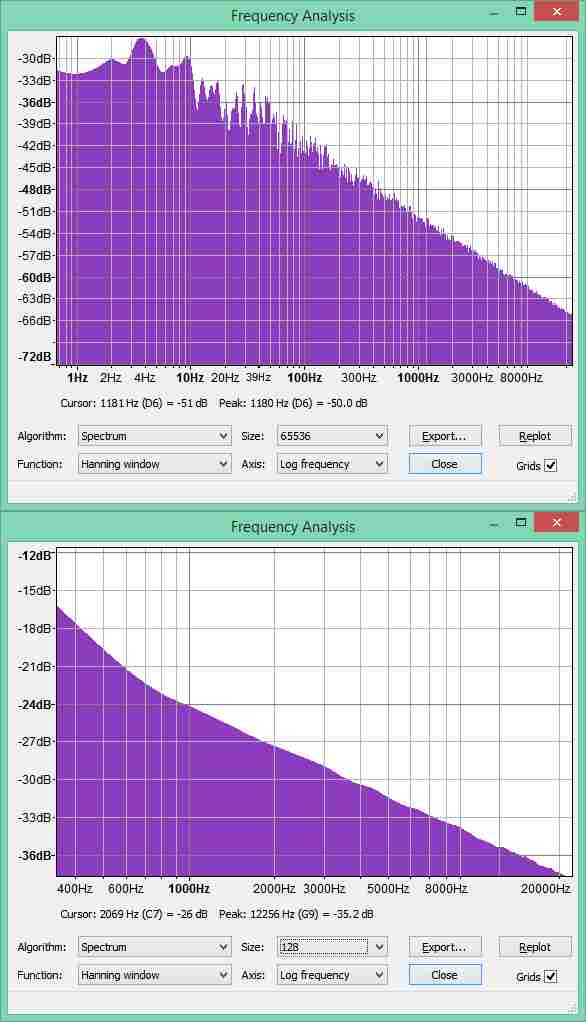

The design problem here is we aren't sure what you need as there are many types of pink noise in nature.
Pink noise filter in electronics is clearly defined by a half octave low pass filter over white noise but the white noise is not clearly defined, as there are both thermionic and pseudo random types that AVERAGED over time give similar spectral density but in SHORT duration are not identical but may sound similar
Although the PRSG has more "structure"because of the dominant octave, the fundamental sequence length frequency. , which can be anything you want but it will be a dominant pattern which can be modulated if you want over decades while adapting the same spectral density by detecting the density of the mid range. octave and normalizing the gain at different fundamental rates.
The PRSG is a long repeating mathematical sequence of steps ( which are the integral of alternating random interval impulses from a short formula similar to a fractal but not recursive like fractals over smaller intervals. This would take several PRSG's in parallel mixed with analog weights.
So you must decide many things to get Pink Noise.
if your source is an impulse of fixed shape or random shape or a filtered step of pseudo random polarity or same polarity or a integrated pseudo-random sequence of alternating polarity and patterns between a range of intervals from n1 to n2
If an impulse what pulse width ( equiv to max frequency ( 100Hz?) or random pulse width
, what range of intervals and what order of filtering.
No filter : ~flat towards frequency of pulse width
Pink Filter ( warm) ~3dB/octave +/-1
Brown Filter (warmer) -6dB/octave
To help us decide what you want, define the purpose? Emulate or Stimulate or compare with a biological response?
If it is simulation, what is the fundamental frequency? 0.001 Hz?
Here is Pseudo Random Sequence Generated (PRSG) sound over the audio spectrum using a Pink Filter, which gives an ideal -3dB per octave above 200 Hz and is higher below this when analyzing a short interval.
Analyzing a longer interval gives the analysis more resolution to see the closer look at the fundamental rate and sub harmonics which extend the bandwidth below the fundamental but give a different shape dependent on the algorithm used.
You can also listen to it but you may not hear the fundamental aberrations which may or may not be important, depending on use.
Top 65k sample spectrum analysis gives narrow spectrum resolution.
Bottom 128 sample spectrum analysis gives broader spectrum resolution and smoother results over a shorter time.
edit
Also note the spectrum range differs by the analysis.
The resolution bandwidth is different for each plot due to the FFT Sample window size so not only are the scales different, the amplitude at 1kHz is different with a different bandwidth.
To play the pink noise, download the file and rename the file to drop the extension .sub and leave .mp3 ( If you have extensions visible.
But if you download and open with Irfanview, it plays directly.
I could also shift the signal downwards in decades so you don't have to build anything. Just play it from a sound card with a DC response. ( e.g. Turtle Beach)
