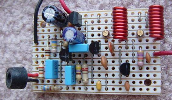

The instructions say to make the coil "close wound". The turns on your coil are much too far apart which causes the frequency to be too high. The wire for the coil is supposed to be insulated with enamel so that when the close turns are touching then they do not short together.
My FM transmitter has "close wound" turns.

How to insulate the coil with enamel? do you mind explaining how to do that?
That means if the coil is further apart will get higher frequency?
My coil is not over frequency but not enought frequency, is it cause of there is no insulation?

Thanks for the info. But i have already soldered on a veroboard.
I just don't know how to insulate the coil with enamel.
I used wire that is made with an enamel insulating coating. I got it from a speaker's crossover coil. A transformer also has enamel insulated wire.

i have already tried to solder one myself.
as in the image
But i can't get the frequency of a Fm radio frequency range.
Can someone help me and point out the mistake that i have made?
all the components i got are the same from the circuit diagram.

This doesn't look like Veroboard. Is it?

hi, i have follow all of the steps that is mention above but the frequency i got from an oscilloscope indicating the frequency is not stable.
Is it the frequency i get from the oscilopscope is incorrect or
Is there anyway to make the frequency stable or have i done any mistake that make the frequency not stable?
May i know what can measure the frequency that it produce?
here is a image that i have redo.
Can please pin point out the mistake that i have made?
is the coil still to far apart?
AG, I don't understand how you build your boards. This one has no solder showing, no cut tracks, and apparently bare jumpers across tracks. How does that work? What's on the back side?

this is whats under it. And sorry my soldering skills is reali bad
those burn parts is at 1st i can solder in the coil.
After i scarpe of the enamel then it only can
but those burn parts i did't use those places
or should i just redo the whole thing over?
