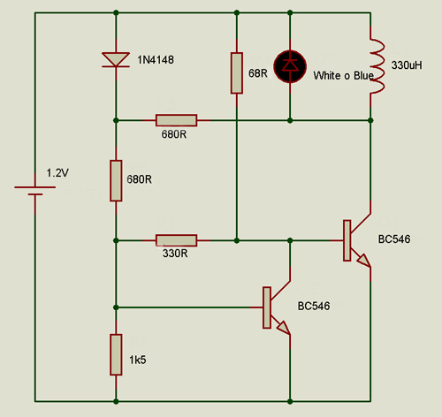

Hi Guys,
This one is built and tested, works on a single NiCad cell down to 0.85V.

Build the circuit for the Joule Thief ( google )
only small coil to be wound (about 20 turns bifilar) and one transistor required plus LED !
I built a couple of them and they drain a battery down till 0.35 volts.
Your 1.2 volts application will be perfect to drive a white or blue led at the 3.4 volts required.
