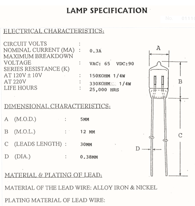

Online search for NE2 Neon light datasheet is all advertisements people selling NE2. How many milli amps is an NE2 ? 50 years ago I read NE2 is 55 volts. Circuit I found shows .5 ma.

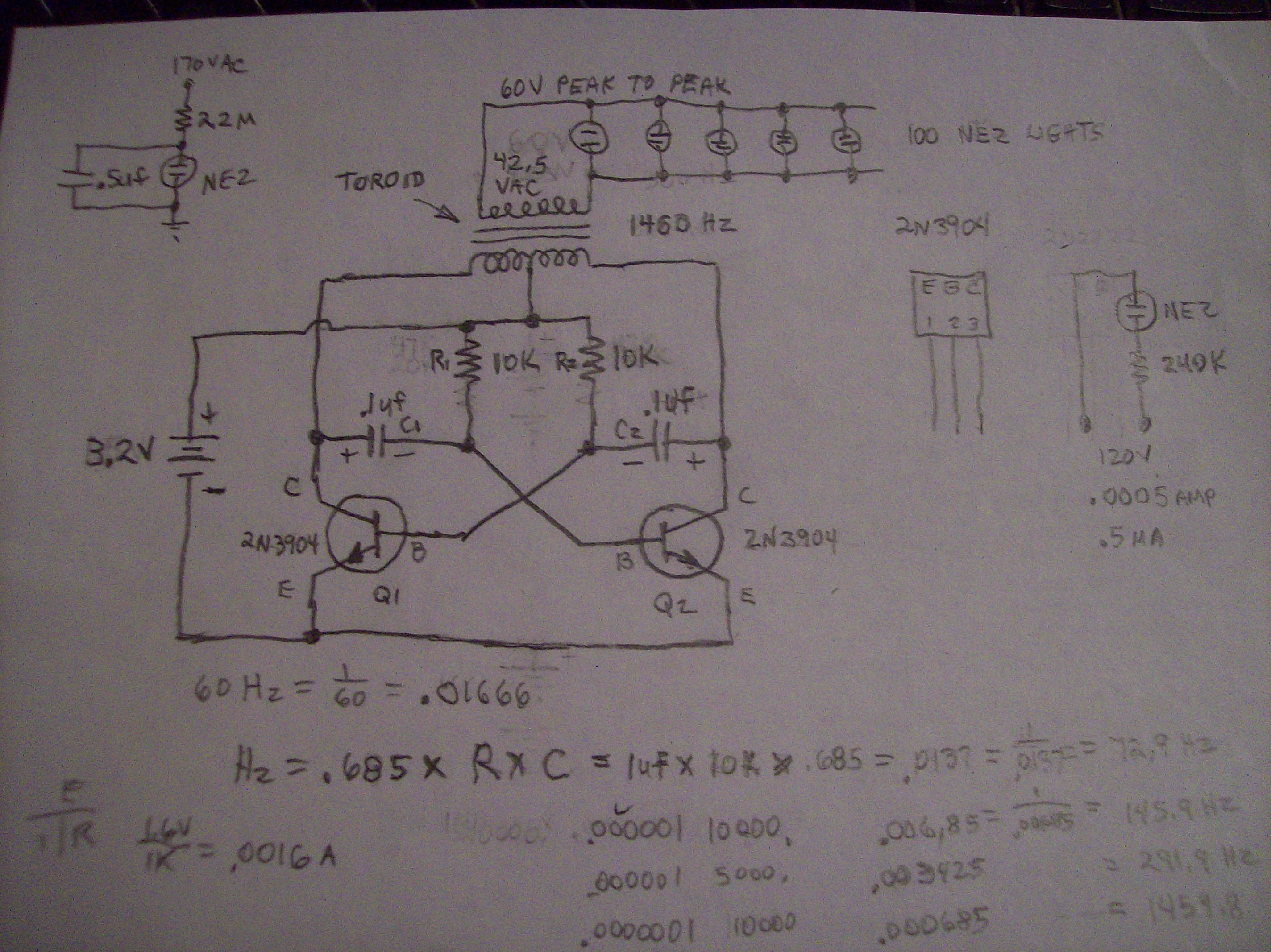

I designed this circuit to make 60 volts ac peak to peak secondary toroid winding. If NE2 Neon is .5 milliamps 100 neon lights in parallel will be 50 ma. 2.125W is not much power for a toroid I have 7/8" diameter and larger.
2 D batteries can deliver 8a max. Short circuit = 25.6W. 2W should be ok.
I don't know much about toroids. I have formulas for EI laminate transformers they need a certain number of primary turns to be happy what about toroids? I need a starting point for primary winding is there something better than guessing? I have #24 enamel coated copper wire to wind toroid with.
I did math for circuit to run at 1460 Hz is this ok for a toroid?
Suggestions?
This is a long over dew project I bought these NE2 Neons 30 years ago there is no resistor attached to the neons.

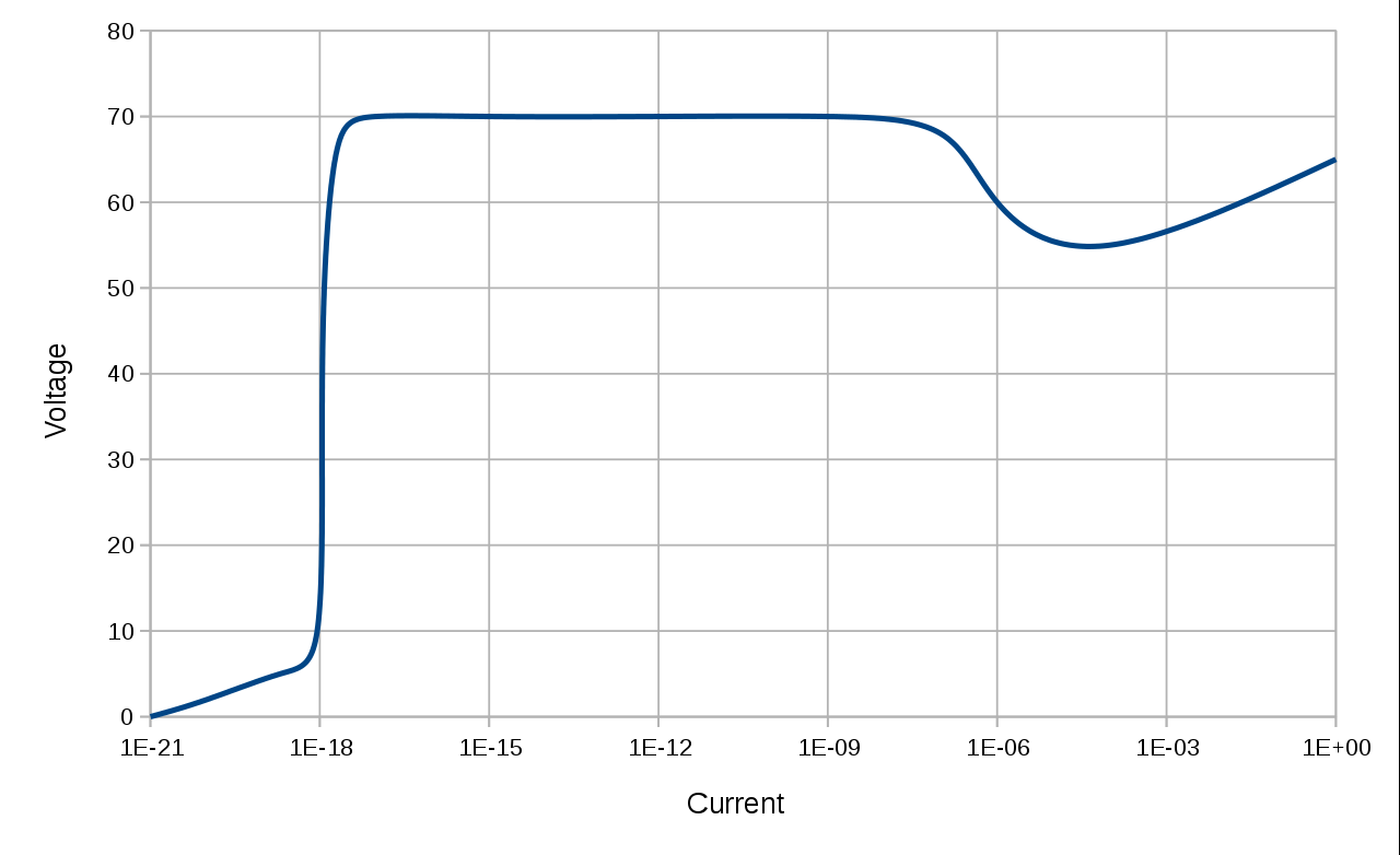

I do not like the idea of 100 neon bulbs in parallel. The fire voltage varies from one bulb to another.
A typical bulb might fire at 90 volts (peak or DC) and then it will load down the supply to 60 volts. (hold voltage)
Lets say that one bulb fires at 80V and the next one at 81, the next at 82, 83, 84, ,,,,,, to 90V.
When your supply starts up the 80V bulb fires first and steels all the current. No other bulb will fire.
I found a graph that said it might take 1 Amp to get the hold voltage up to the fire voltage.
I think you need a resistor on each bulb. You need a supply voltage high enough to trip the highest voltage bulb. Maybe 100-110 volts.

I need to know about how many turns of #24 wire is needed for the toroid. I remember push pull will be 4 times more output. I don't think 3v can increase 4 times probably current increases. 10 turns on primary needs 150 turn secondary to get 45vac and 63vdc. Do toroids have a watt rating?

Your 10k base resistors give a base current of 0.25mA which is much too low. Then the collector current into the transformer will be only 2.5mA. The little 2N3904 transistors work poorly above 100mA and then need a base current of 10mA.

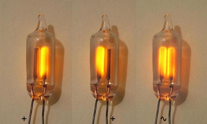

A neon is typically AC for full brightness. If you use DC, only one of the two electrodes in the NE-2 bulb will illuminate.

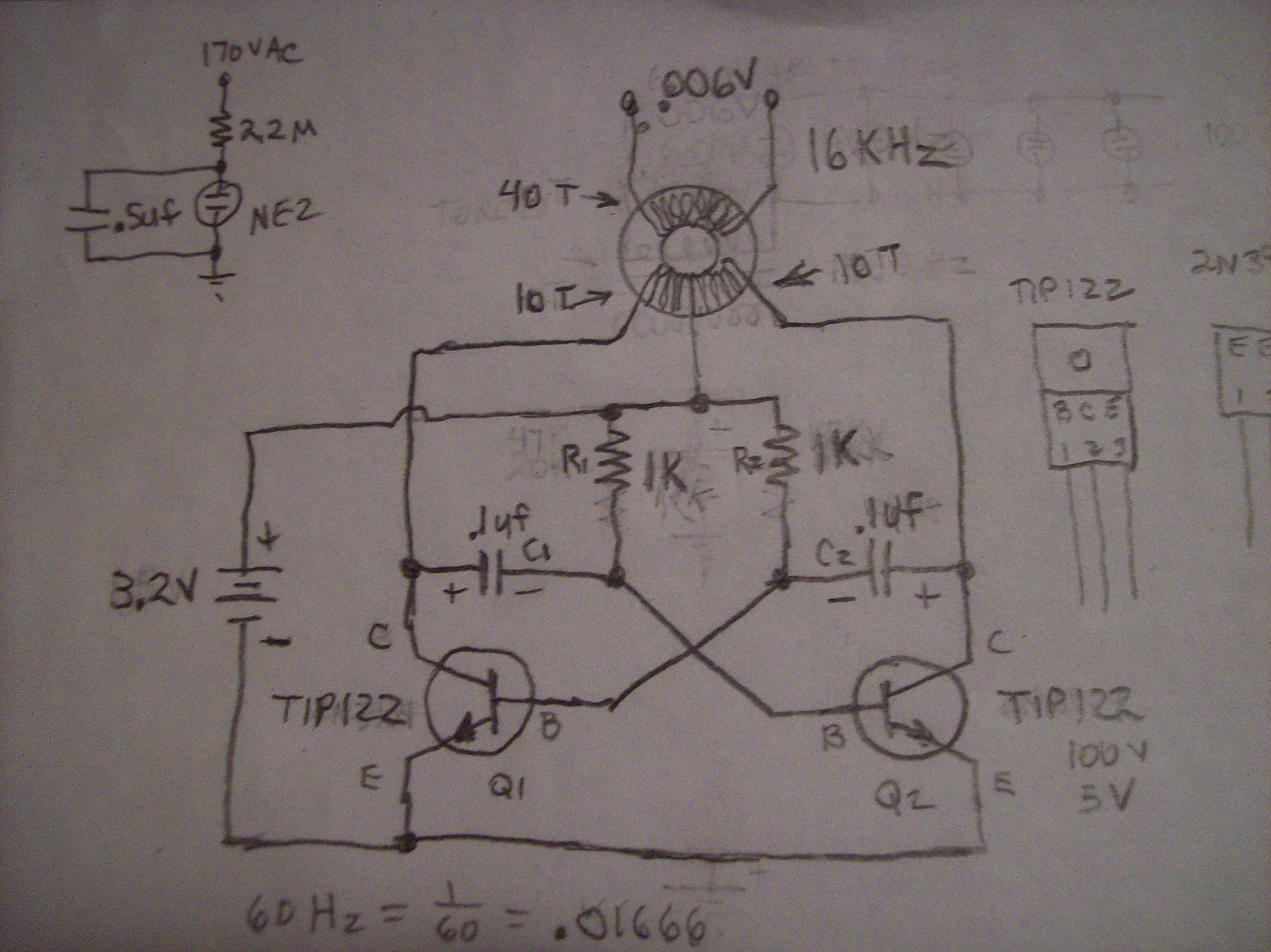

If your transformer and multimeter are made for 60Hz then they barely work at 10khz. A high frequency transformer has a ferrite core. The datasheet for a little 2N3904 shows that it works poorly above 100ma and its max power is 0.625W. A base resistor of 30 ohms can be used for a power transistor, or be used to destroy a little 2N3904.

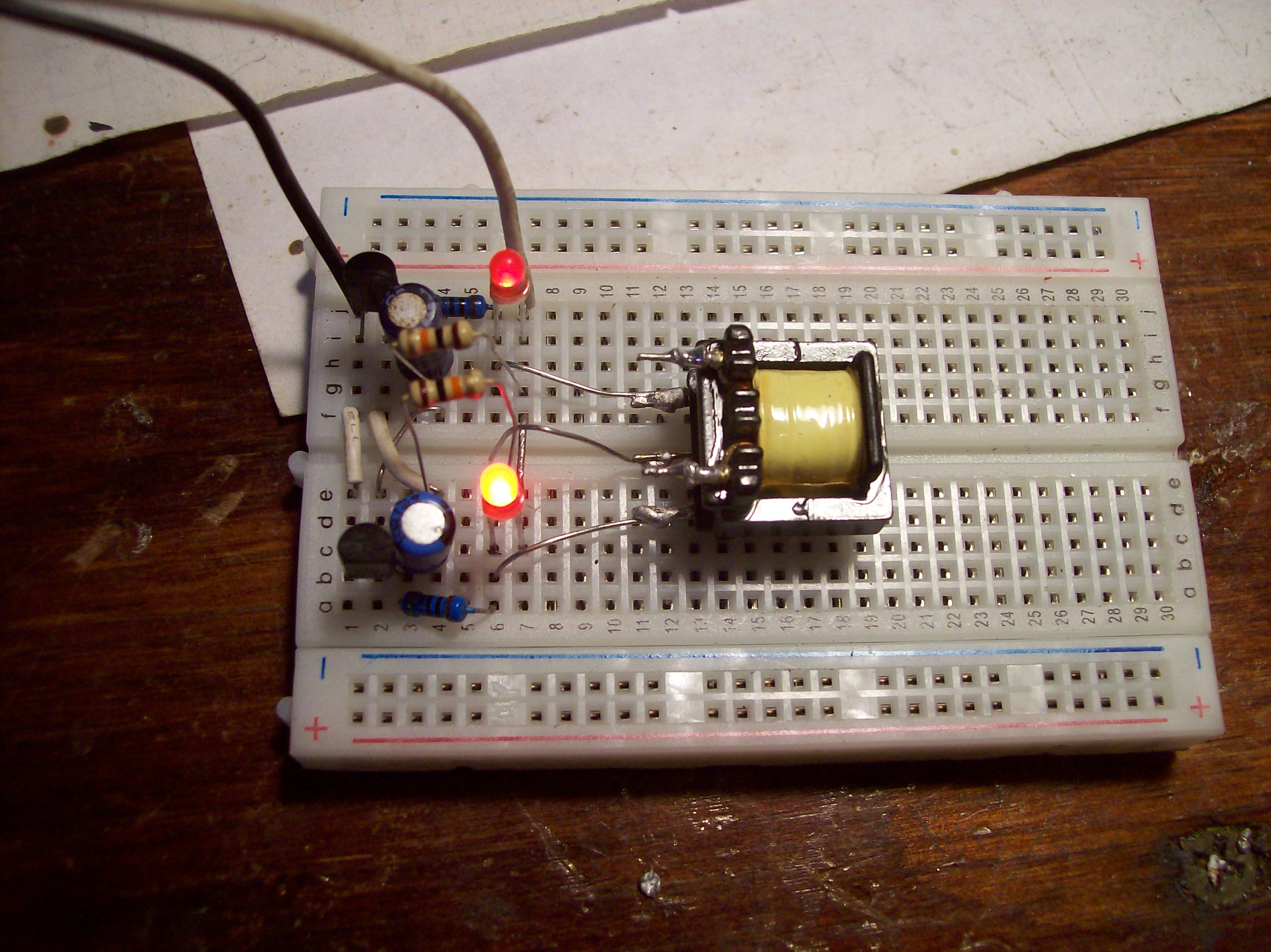

Circuit does not work. With 2n3904 transistors I had circuit flashing LEDs at 1 flash per second. I changed transistors to TIP122 the LEDs still flash at 1 flash per second. Then I change R & C to 5K the LEDs are both on. Remove LEDs & add toroid transformer almost no out put voltage. Changed R & C to run about 12K then 16K output voltage on toroid transformer .006V. I have a tiny 50 year old audio transformer primary has center tap I tried it still very small almost nothing voltage output. I also changed R1 & R2 to 300 ohms and 30 ohms.
