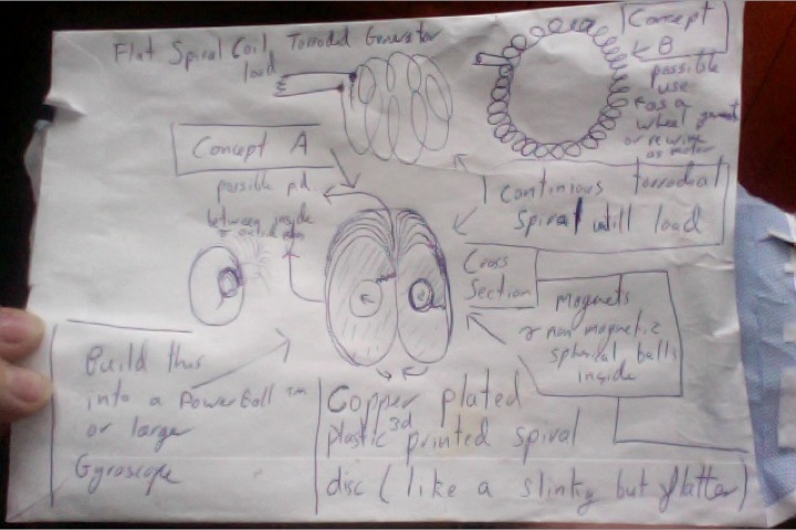

Remember in my design the coil would be continuous, so when you put a load in series with it it will force the magnets within to slow themselves. In his/her design he/she shows the magnets as spherical. This would not actually work very well as they would be trying to reposition themselves to align with the magnetic field, and energy can only be created if their field cuts through that of the coils potential field. So a rail of bearings within is recommended so that the magnets can be kept at the optimal orientation. Simple stuff!
If the continuous solenoid torus has potential for generating energy it may also have potential as a type of motor and possibly even have an effect on gravity if used on a large enough scale and at the correct speeds. My design would put the magnets in a vacuum to optimise the motion within the torus.
The other concept i would like to marry this technology with is the gyroscope. I couldn't help but become obsessed with the idea of trying to accelerate the magnets to great speeds with a very slow motion simply by using a gyroscope type design. The magnets would in this case form the flywheel and just like a Powerball (the toy used as a wrist/arm strengthener) We could spin the generator at high speeds with a simple slow stirring motion from the wrist. This could also be scaled up to any size including industrial level by using a motor to create the motion needed to simulate the action needed to spin a power ball up to high speeds. Here lies one big mechanical and or electrical problem, since the gyroscopic magnetic flywheel would be built inside a torus (ideally but not necessarily built with the flat spiral coil concept) then the torus would also have to be in motion making it impossible to tap to the wires without some type of brush or other wiping contact, initially i considered using the inductor technique to transfer energy from the inner torus to the outer torus but doesn't inductor transfer of energy rely on alternating current?

Many of these ideas came from thinking about how to collect the energy produced when a magnet is dropped through an aluminium or copper pipe, etc.
A pipe turned into a coil which turned into a flat spiral coil which turned into a torus so it's like an infinite solenoid formed from a type of coil but it has a load on it where you want to tap the energy from. Future experiments would also test the potential difference between the inside (narrowest) and the outside edges (opposite edge on the outside) of the torus. and also try tapping of of each turn or perhaps from segments of turns around the torus to divide or multiply voltages or use these tapping points for motor technology. I would also consider adding non magnetic spherical objects between the magnets to create the correct spacing.

This is the experiment i would like to try but with a coil of wire with a load across it, then moving up to a combination of magnets and non magnetic sphere within the torus. Then if there was success the idea would be to build a cage within with bearings (possibly ceramic) that would keep the magnets positioned in the best possible orientation for the production of power etc. Then the last step would be to swap out the wire for the flat spiral disc type wide slinky torus design (less coils but much more surface area) And then try to squeeze all of that into a gyroscope where the magnet array would form the flywheel.
It would be nice to see such a thing on a handheld scale but also in larger formats.
If it works. Sorry about the crappy sketch but it was a quick one and i didn't sleep last night.

A moving magnet surrounded by a conductive material will generate eddy currents as you suggest, and the magnetic field generated by these currents opposes the movement of the magnet. This is why you observe that the magnets is slowed when it falls through a copper pipe.
The magnet can't come to a complete stop, if it did no eddy currents would be generated and it would fall. However it can be made to move very very slowly by removing all the losses in the system - this has been repeatedly shown using superconductors.
In your question the magnet would continue to fall as long as you keep turning the circular tube. obviously if the magnet reached the bottom of the circuit it will stop falling so there would be an optimum speed to turn your tube.
With your generator style idea it becomes more complex. The eddy currents are no longer just a simple function of the copper resistance instead the generated currents are dependent on the load you attach. So for example if you open circuit the coil (no load) then no eddy currents could flow and the magnet would not be slowed down ( apart from friction and air resistance). Short circuit the coil and the magnet will be slowed down as much as if it were in a copper pipe.
The mechanical input power will have to compensate for whatever load you have applied such that energy in = energy out + losses
BTW the output will be AC
basically you've invented a complex generator which crosses over with partial accelerator ideas. Might make for an interesting flywheel generator though but with this complexity it would only be worth it for a very large flywheel.
