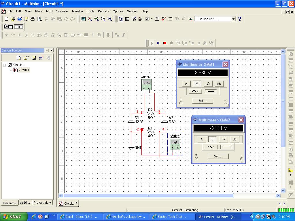

Using kirchhof's voltage law we say that there can be potential drop while going through a battery.But what about resistor?Will there always be a potential drop at resistor if there are two batteries of different voltages.I've seen it in a pakistani book that there will aways be a potential drop.But i don't think so.

there will surely be a voltage drop across the resistor if the potential difference is developed...
to make sure you once see this simulation pic....
Sometimes the voltage accross a resistor will be considered as a rise when performing Kirchoff's voltage law around a circuit loop.
This is dependant on the direction in which you are passing through the resistor. If you are going around a loop, but in your loop enter the negative terminal of the resistor (which is at a lower potential) it means that the other side is at a higher potential. So while performing this loop the resistor had a gain.

This voltage gain only exists when doing loops and analysis in KVL. Resistors never have a voltage gain in circuits because they are passive elements and cannot supply power.
