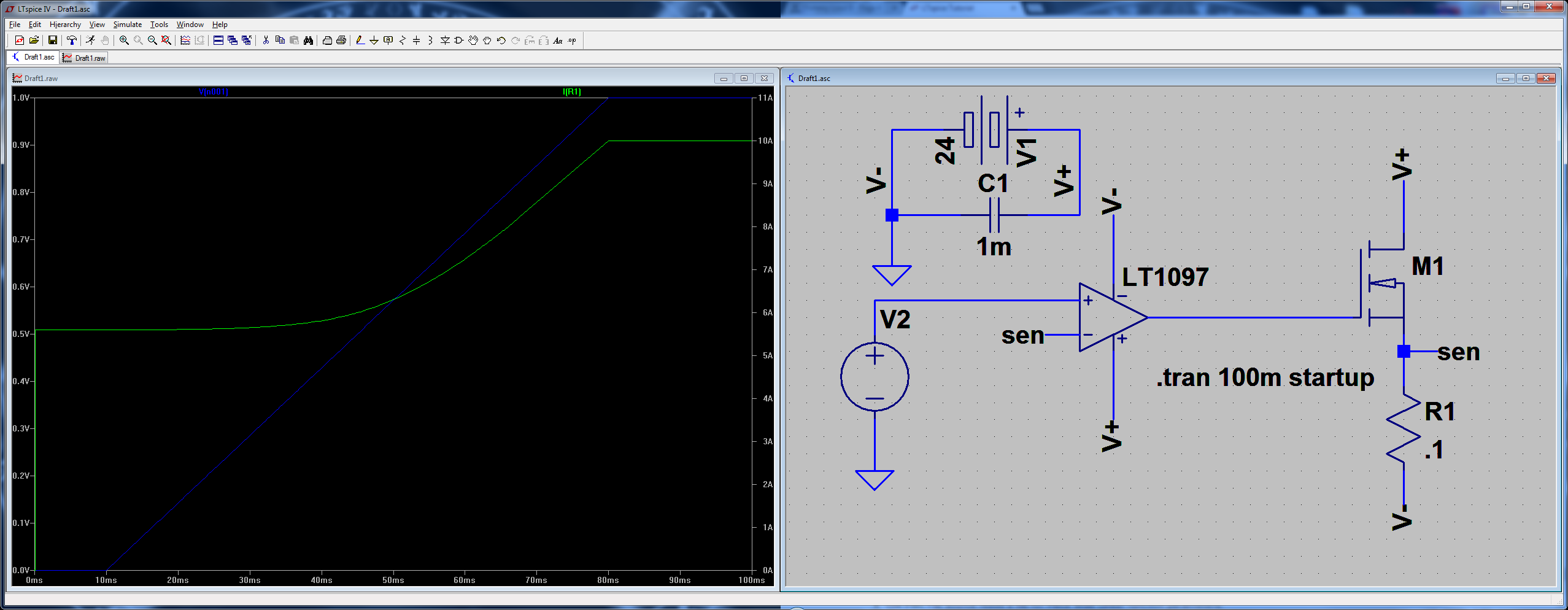

I'm pretty sure someone already mentioned this before, (I'm too lazy to go and look) but there could be serious problems when using an Op-Amp with "normal" offset.
In simulation I was having problems when the reference voltage was really low, and I think this was why, because I was just using the most generic OP-Amp I could find. If we haven't done so already, (can't remember) It might be worth it to invest in low offset + rail-to-rail type Op-Amps. A low offset can't possibly have negative side effects as far as I know, so there is no reason not to do this other than to save like $5. And a rail-to-rail Op-Amp lowers the minimum current we can make the system draw. Also good.
Here is a simulation with a more or less "normal" Op-Amp. The green line is current, the blue is our control voltage. Notice that even when the control is telling it to, the current can't go below ~5 Amps. Not good at all.

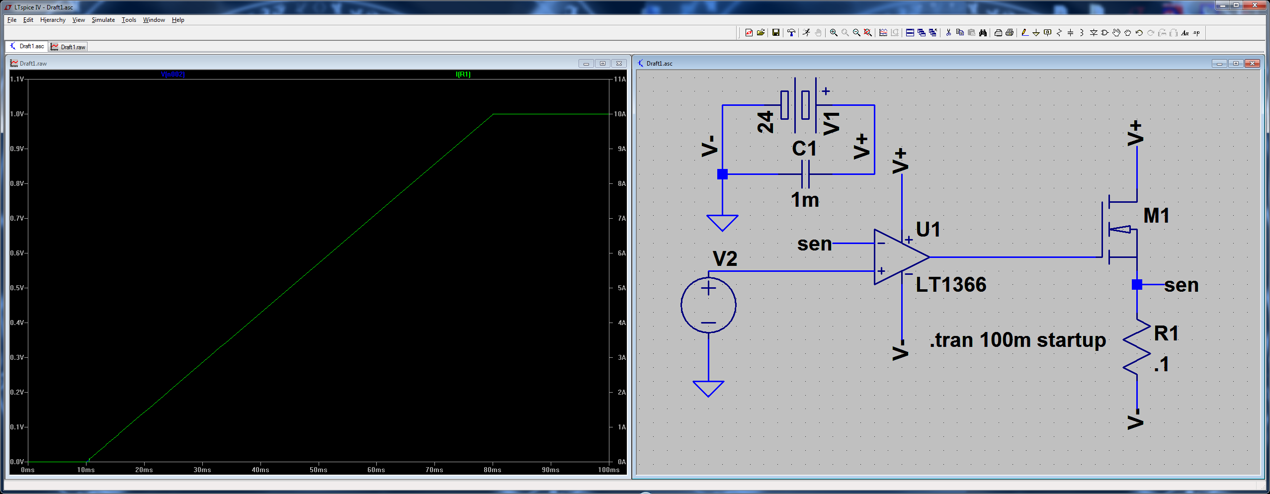

And here is the same simulation, the same control ramp, this time with a better Op-Amp. Note that you can't even see the control voltage this time because it exactly follows the current. Which is what we want.

I don't think it's offset so much as the LT1097 doesn't go to ground. Might also be the generic FET. I'll have to give it a try.

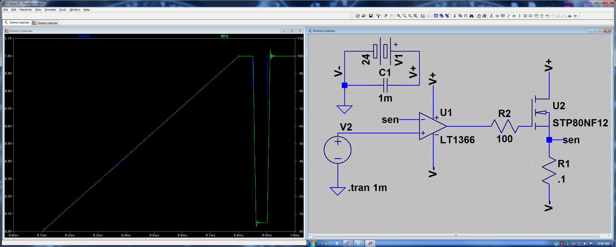

So... Remind me which Op-Amp we are using? I have the STP80NF12 model and it appears to be working.
Here is the graph of control voltage vs current.
As you can see, things are quite stable with this configuration.
Yeah, that was indeed what was happening. However, in the future if we want to lower the current sense resistor down to say... 50m Ohms or lower to reduce heat, we will want the lowest offset parts we can get for best stability and accuracy.

I tried the above simulation with all sorts of the in-built MOSFET models and most worked fine for me. The only ones that didn't really work were the last two with the highest RdsON, which is understandable. The above simulation with the STP80NF12 also works. Keep in mind though it's still not the exact right Op-Amp.
