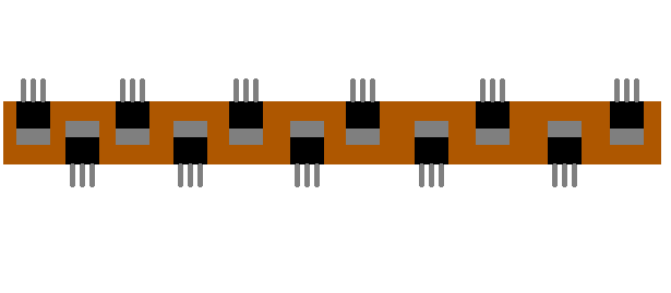

Do you think I could safely butt them right up next to each other???
There is no cooling problem. Even at 300 Watts each, with the amount of water being moved, it's specific heat capacity, the thermal conductivity and so on, The temperature is only going to change by a few degrees at most. It really is quite the effective cooling setup. You would probably have to dump 10,000 watts into the thing to get a temperature gradient that was measurable by consumer grade thermometers. Then again this really depends on how fast you are moving the water. But if it's anything like my home water system, then it's moving quite good.
The real problem I would worry about is soldering them on while not shorting out parts to each other. Do you feel confident enough to maybe put some FETs on the back side of the pipe? That is how I have my setup and it works wonders. I have 10 TO-220's on one pipe and it is only 17cm long. There is even enough room for ~8 more. Another thought is to make some point up, and some point down. This lets you put some distance between the leads, while packing the packages really close to each other.
Like so...
Yeah, those are all good ideas. I was trying to figure out how I could solder them on both sides of the pipe but just can't see how I could feasibly do it. Reason being, the only way I can get the copper hot enough to wet the solder was to apply a torch to the under side while the FETs rested on top, gravity holding them in place. I tried soldering them with a high wattage soldering iron but just could not get the large pipe hot enough. I also tried using the torch on top of them pipe but could not do it without burning the FET package, maybe your skills are better than mine ;). Anyway, maybe you have some tips?
