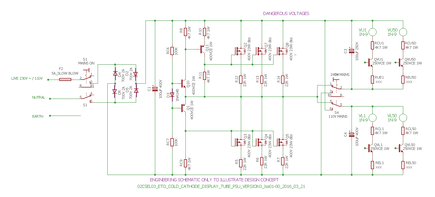

Here is a unisex NMOSFET version of the PSU.
I have also reduced the number of MOSFETS from eight to six which should be OK.

No you were right. The transformer I specified did weigh 2.5Kg. I suggested to try using the transformer that Les suggested initially, which is much lighter. I feel a bit more confident about this change because I now understand the operation of the tubes a bit more and also have more information about your application.
I think the mains transformer approach is the best all round. If you could get a transformer with a single 150V secondary winding that would be ideal.

Just guessing but I think you have the 115/240 volt switch arse about ?
Arn't the outside rails 240vac from the bridge ?
Ahh.... so I am not going mad.
No sweat fire,
No, the 110V AC and 240V AC selector is correct (as far as I can tell). On 110V input there will be around 153V between the supply rails and with a 240V input there will be 339V between the supply rails. The idea is that with the 153V supply rail, the 100 of tube circuits are all connected across the supply rails. With the 339V supply rails the MOSFETS & co divide the 339V supply in half to produce two 169.5V supplies. The upper bank of 50 tubes is connected to the upper supply and the lower bank of 50 tubes is connected to the lower supply.

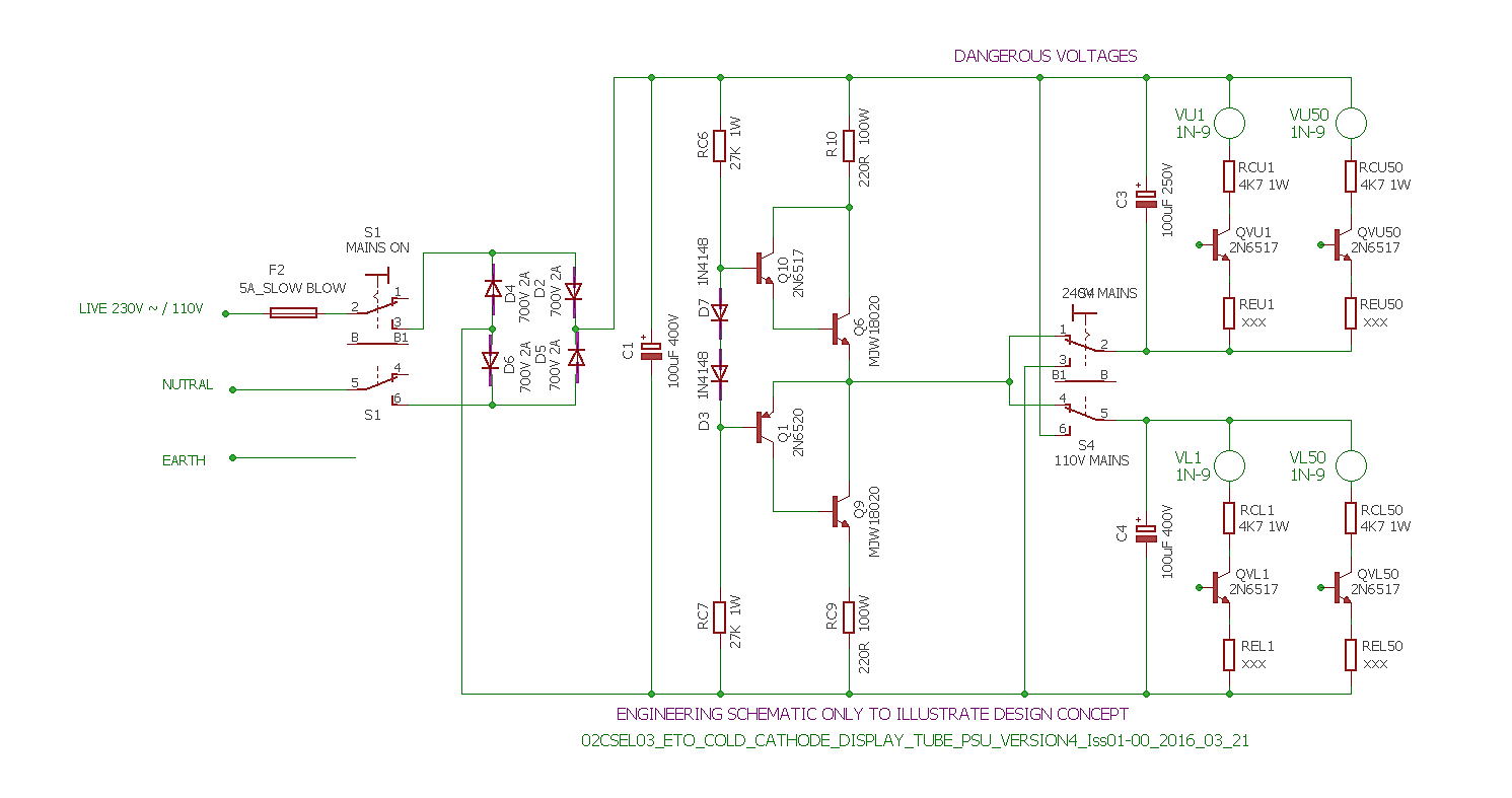

Here is a simpler version of the non transformer, non isolated cold cathode indicator tube tube PSU.
Rather than dissipating the power in an array of MOSFETs, the power is dissipated in two high power resistors which can operate at a much higher temperature than semiconductors and thus will be adequately cooled by a smaller heat sink.
The two power NBJTs dissipate 23W worst case so they will also need a heat sink which they can share as only one of the NBJTs will be dissipating power at any one time. This is also the case for the power resistors, which are the bolt-down type as shown in the data sheet links.
ERRATA
(1) Increase C1 to 220uF 400V or larger.
(2) Fit 100uF 250V capacitor across the respective tube supply rails for every 25 tubes
(3) C4 should read 100uF 250V not 400V
(4) Fit 1N4148 diode anode to Q6 emitter and cathode to D7 anode (upper). This is for reverses VBE protection on mains power switch off.
(5) Fit 1N4148 diode cathode to Q6 emitter and anode to D3 cathode (lower). This is for reverse VBE protection on mains power switch off.
NOTES
(1) with a 240V mains input, the voltage across C1 will be 340V peak. The function of the high power transistors, and associated components, is to generate a midpoint in the 340V rail to give two 170V supply rails, one for the upper bank of 50 tubes and a second for the lower bank of 50 tubes.
(2) With a 110V mains input, the voltage across C1 will be 153V peak. This will be the supply rail for all the tubes which will be connected in parallel by the mains selector switch.
(3) For 110V mains supply operation the high power transistors and resistors and associated circuit components are not required.
(3) The high power transistors and resistors will only dissipate worst case power when one bank of 50 tubes is conducting no current and the other bank of 50 tubes is conducting full current (600mA total)
(4) The two 220 Ohm high power resistors dissipate 74W worst case and can be mounted on the same heat sink as only one resistor will be dissipating power at any one time. This heat sink will get very hot under certain circuit conditions and needs good ventilation and safety measures to prevent human contact. Also the resistor heat sink should not be mounted in a position to heat other components and especially should not be able to heat any flammable materiel.
(5) The two high power NBJTs dissipate 23W worst case and should be mounted on a separate heat sink to the power resistors. But similarly, the two high power NBJTs can be mounted on the same heat sink.

I "think" I have found a fault in the circuit though.
The 4k7 resistor must be put on the anode .. no the cathode side.
I take it that the 110/240 switch is shown in the 110v position ?
The 4K7 resistors are on the cathode side of the tubes and are in the correct position. They are only there to protect the driver transistors from the blood and thunder going on in the tubes and to provide a degree of protection from ark-over or any other strange effects that you get with valves (tubes). In addition, they lower the dissipation in the driver transistors.
The mains input voltage selector switch is shown on the schematic with its wipers up, which is the 240V mains input position. The labels above and below the switch schematic symbol indicate the position of the switch wiper for the two mains input voltages.

Err.. sorry .. have to disagree.
The anode resister MUST be put before the tube.
I have run tests.
It will light using your circuit but only if you turn the vaiac up to about 300V and then is switches on (all segments lit) and draws god knows how many amps coz it's brighter than the sun !

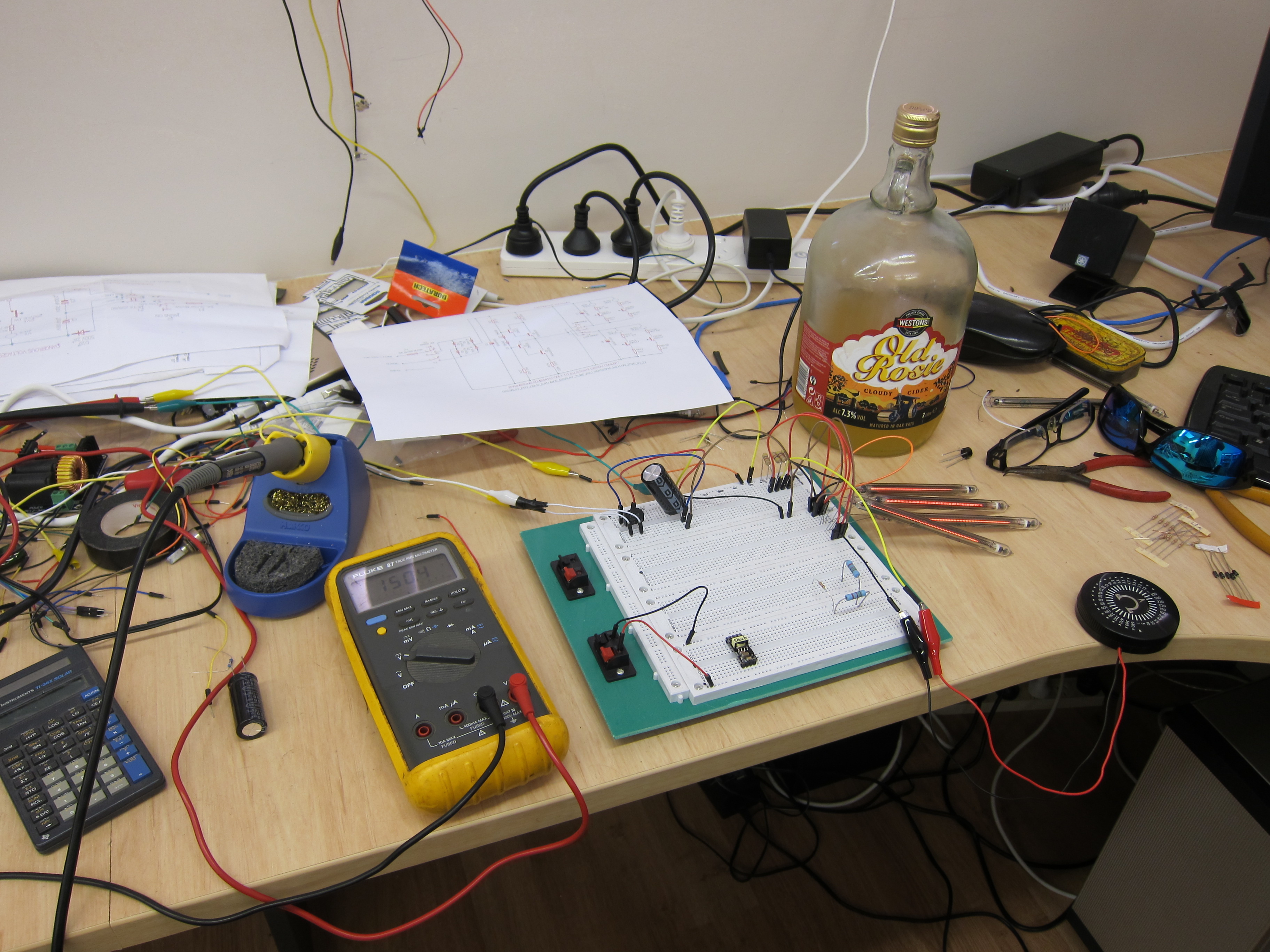

Ok.. have done some measurements
Voltage in across C1 = 156 Vdc (adjusted with vairac)
Voltage across 4k7 resistor 55 Vdc
Watts = 0.66 @ 12mA
Voltage across IN-9 99Vdc Fully lit from end to end. @ 12mA is drawing 11.88W ! ? That can't be right I it's just not that hot ? I could toast bread with 100 of them !
It must be though ... coz 55Vdc + 99Vdc + whatever is across the 220 ohm resistor adds up to 156 Vdc !
Edit: Thanks to Les for pointing out that my maths is wonky .. it is actually 1.188W !
Current across 220 ohm resistor (emitter output) 12 mA (No transistor in circuit)

Hi fire,
Not sure where to start.
But can I just say that you are not testing the circuit correctly.
You must have a transistor in the drive circuit or you cannot define the ionizing current and will blast the tubes to hell.
If the position of the 4K7 makes any difference there is something badly wrong somewhere.
Can you check that the circuit is wired as per the schematic?
