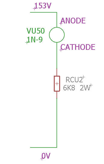

When the circuit is wired with your schematic .. it does not work.
When I swap the anode resistor to the supply side it works !
As for having a transistor that's why I put the 220 ohm resistor there .. to limit the current to 12mA. ... If you look on the original data sheets you don't see any transistor ?
There is not one nixie or in-9 circut I have ever seen that puts the anode resistor on the cathode side.
I can drive my display up and down very nicely with the little resistor substitution wheel I have.
So .. I am pretty sure that this is the correct way to wire it up.
If you swap a tube around the other way in the SAME circuit .. it does NOT light .. unless you turn up the voltage to 300Vdc.
I have done it ... I have seen it.

You've got your decimal point in the wrong place. It should be 1.188 watts. I agree with spec that you MUST have the transistor in circuit. Also it cannot make any difference if the 4k7 is in series with the anode or cathode.

Why do I need a transistor ? .... when my resistor is controlling the current just nicely. ?
And .. as for the anode resistor ... I would agree if it were not an IN-9 .. my experiment proved it.
Still .. we will find out when I get my transistors.
fire,
Can you wire up the test circuit below? Please ensure that the anode and cathode of the tube are connected as shown. Are the anode and cathode on the tube clearly identified?
spec
Yup... sure can spec.
First thing tomorrow.
The thing is with these tubes is they are bar graphs .. not neons ... so that's why I doubt it will work.

Hmm, I might be missing something or reading the data sheets incorrectly.
If the test circuit does not work, there is something fundamentally wrong somewhere. This would need to be resolved before a display system could be developed.

I've built a few 'nixie' clocks, one has an IV13 linear neon bargraph, they take more power than the average nixie.
There are 2 approaches, 1 is power them direct from the mains as vintage equipment often did, and the other is an smps, 100 tubes is going to use at least 100watts, so I'd be looking at a push pull converter, probably a sg3525 smps ic, and a etd39 or etd44 ceramic transformer, a couple of mosfets and the required dicretes, push pull mode without feedback would be adequate and simple.
