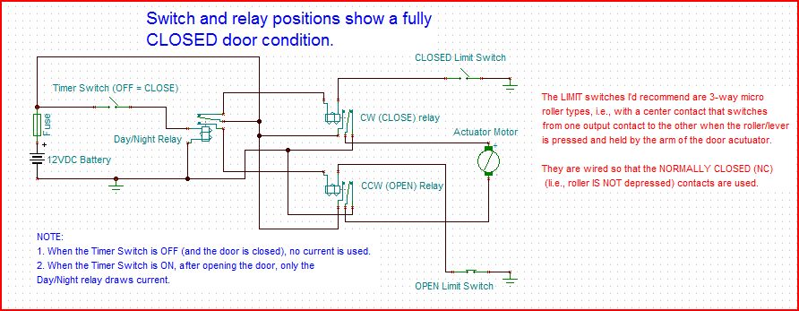

Hi, everyone. I am trying to figure out how to wire/connect a reversing switch for a timer controlled 12v DC motor with an NC556 IC timer. Here's how it began- My Mom (80 yo) said she'd like fresh eggs and they were inconvenient for her to obtain. So, I bought a bunch of good egg layers and she's happy. Me? Not so much. I have to go out each morning to open the coop and let them out. This winter has been so bad, I'm setting up auto feeders (simple timers) and trying to construct an auto coop door that opens at dawn and closes after sunset. Simple, right? Not for me. I'm a farmer (cows & chickens), carpenter and a pest control operator- not an electronics "guy". Can anyone provide me with a simple "a to b to c"instructions on how to reverse my door motor. I've read and read but just don't understand how to connect the wires to the proper terminals. Thank-you in advance for your help. You see, out here in the country, things are a little tough and my neither my friends nor I have $200+ to buy an auto coop door. (I should add this- "You Electronics Folks" blow my mind! I am amazed at what you do and what you know. I'm reading and attempting to teach myself but could surely use some help)

You don't need all that. If you have a double pole double throw relay that is controlled by the timer you can reverse the motor.
I assume you are using the timer to turn on the motor to open the door. Then you want the timer to close the door. Is that right?
I think you can do the whole thing with two relays only one has to be a DPDT. I even have a new relay I will donate for the project.

Given the parts you have, this might suit your plans:
This is from an ETO thread titled "Chicken door control" (https://www.electro-tech-online.com/conversations/re-chicken-door-control.31837/)

That diagram up in post #12 looks like just the thing you need. If the motor spins too fast, put a big ol' (meaning something that can handle some wattage, not a high resistance value) resistor inline with the motor to slow it down a bit...maybe just a simple 12v light bulb would do the trick.
And if you can't find reed switches to handle the current, then maybe just use a couple slabs of copper to do the job. Go all "Red Green show" on it (being from WV, you might not get the reference, but us from up north should get it).
