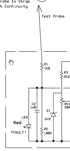

hi tnuflora,
Look at the attached pdf.
The design has been built and checked OK, using loop resistances of 330K thru 1M0 and a short circuit loop.
You will understand, as I will not be the person building and using this unit I will not be held responsible
for any damage or injury that may result from using this design.
EDIT: added 1M0 hysteresis resistor.

hi eric,
i was working with the circuit that u have given.
In that safe operation is working fine.but
fault condition is not at all indicating.
can u give some more details about the working of the circuit ?

Pleased to hear the tester is OK.
Regarding the Fault, this LED will light if the high value resistor has been removed from the strap and a link used to replace the resistor.
In other words its a strap with no series protection resistor, which is UNSAFE.
I have seen instances where the wire with the resistor has broken away from the wrist strap, due daily use, and the user has connected just a piece of wire to the strap, which is a bad idea.

sorry, i mean ,even if i removed the high value resistor then also the fault LED is not glowing.
Its just a 1K0 resistor on series with a Red LED.:)
The 1K0 goes to the +V of the battery and the cathode of the LED goes to -V of the battery.
I would suggest you check the 1K/LED and the wiring.
Are you completing the circuit by touching the 'test probe' to the earthing stud of the wrist strap.?
i just removed the high value resistor.:confused:
Did you replace the removed resistor with a wire link.?
The purpose of the Fault LED is to check a wrist earthing strap thats made without the high value resistor..
On this attachment I have marked the connections points more clearly.

there i made a mistake. i've not connected the wire link.

i've a question...if the strap is made with a high value resistor & for some reasons it fails,how the circuit will respond to it?
i mean , the connection to the gnd will be disconnected & it will be an open ckt. w'll the red LED glows ?.:confused:
If the resistor is too high a value or open circuit the Green 'PASS' led will not light.
