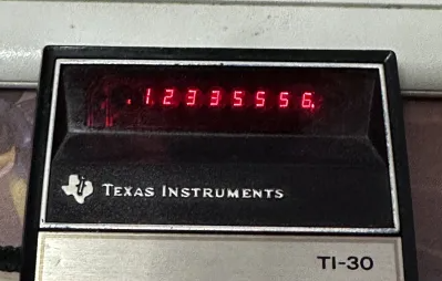

I wish they still made this type of displays. I could probably find another calculator like this to steal the displays but it would be better to find something that is new.
I finally found some 0.2 inc LED displays for sale. Quite pricey though.

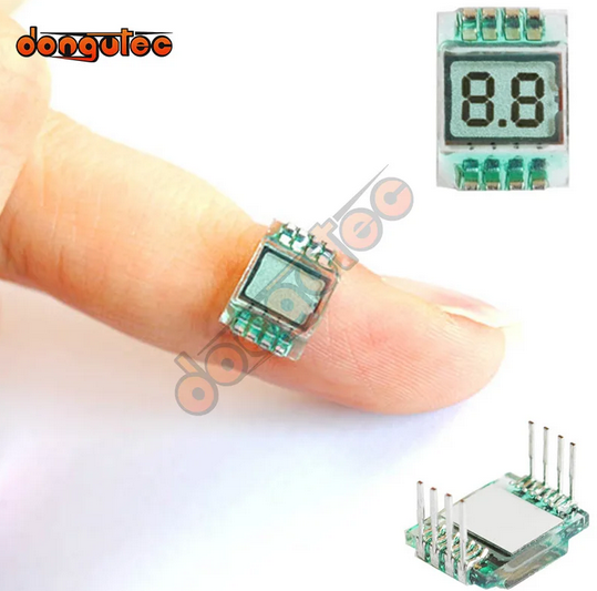

For now I have decided to move on to the smaller LCD displays. The 3 digit one works pretty well:
You can see the same effect where if you look at the LCD from an angle you can see unlit segments:
I believe this is the exact same thing that happens with the static LCDs when they are multiplexed but the effect more even since it is a single multiplexed LCD. Now I will try using multiple small LCDs at the same time by using more segment pins. If it works that way it means that I can make a sweet wristwatch with these guys. For the big LCDs I am not sure if I want to go with multiplexing since it decreases the quality of the image. Other options is to use PIC16F1936 as a slave to drive 2 of those large LCDs so 1939 can have 2 of them for itself.
Edit: Also got the 2 digit small display working:

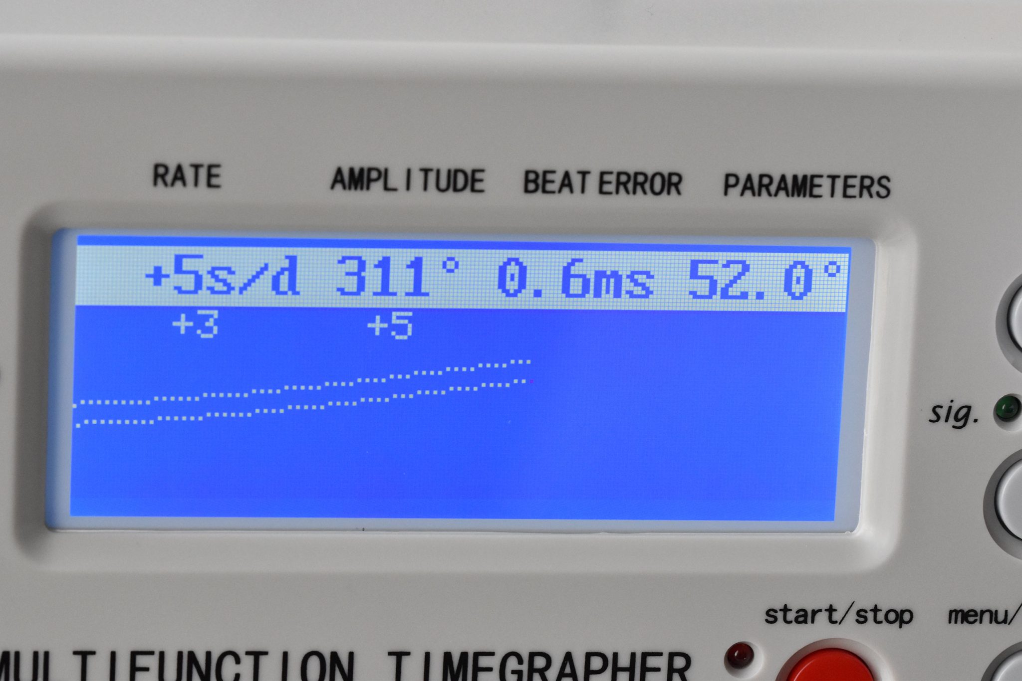

Hi R,
This is the kind of thing that watch repairers use to check accuracy and tick = tock accuracy.

1. The time it takes to calibrate.
2. What else happens that you did not consider, then have to start all over again with the calibration.
There is a lot that gets in the way, such as the accuracy of the time measurements during calibration.
For example, if you wanted to check the calibration after one hour and ensure 5 seconds per year stability, you'd have to measure the time with a good existing clock down to about 500 microseconds. If you try to go lower you have to increase the accuracy of the comparison to the existing clock, and assume that the existing clock is not drifting up and down also.
All the problems means it takes a long time just to figure out what you have to modify when it doesnt seem to be working right.
Another problem is thermal gradients. It's hard to measure something when the sensor is any distance from the object being measured because if there is a temperature gradient it's not going to be constant and that means the measurement is not always going to be accurate. You'd have to encase the thing in a well insulated package to start.
Because of all this it makes sense to go with something already built. You get good one year stability with almost no trouble at all. That's hard to match.
If you only want maybe 10 seconds per week you might do it, but you would have to reset the clock every week.
If you do try and roll your own, let us know how you make out. It's always interesting to hear about these projects.
